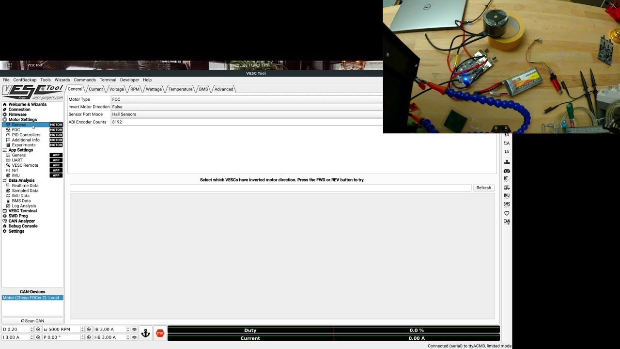

Hello all,
After a few weeks I got the time to test my CheapFoccer 2. I would like to thank everyone involved and this welcoming community.
After flashing my CheapFoccer2 with the files from Shamane’s github account, I tried to setup the wizard, but there seems to be a problem. A weird one, I don’t know if it’s a hardware or a software one, but I’m thinking that it’s probably a software problem.
Here is a video of the problem :
What do you think ?
Thank you very much in advance.
