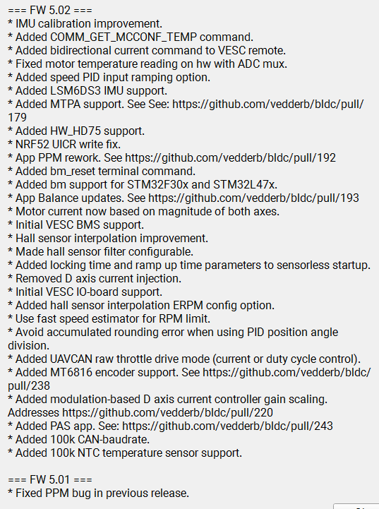

I didn’t know there was a 5.02. Any idea of what that offers beyond 5.01?
https://www.vesc-project.com/node/1724
If you have the latest tool you can check under help, firmware change log.
Looks like quite a few items. I dont know if any of these effect the cheap focer?

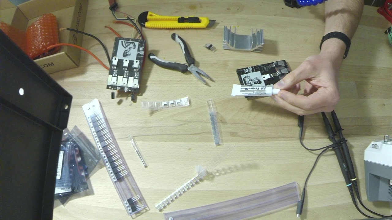

I made it work in the end. I test another board and it worked flawlessly. So I thoroughly inspected the board and discovered a tiny short between C46 and C66.
Now everything works.
To give back a bit to the community, I made a a few videos of the process.
I hope that this will be useful for someone :

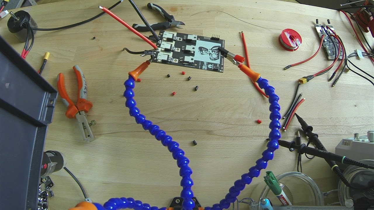

Success!! After some troubles and DRV faults with my first CheapFOCer2, a freshly soldered one solved everything. Cranked it up to 70/-40 motor amps on HFI and the thing freaking rips. Running a single 6374 on 15/36 gearing, so not an easy task.
Gonna try and replace the DRV on the first one, just in case LCSC is again giving us some “B stock” of the component…for reference, my batch code is 08ACK3TG4. @doomy, maybe you can check out yours, in case you’re still getting the “reset to defaults” issue.

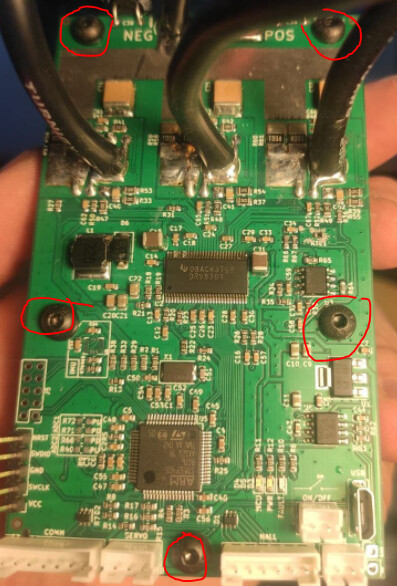

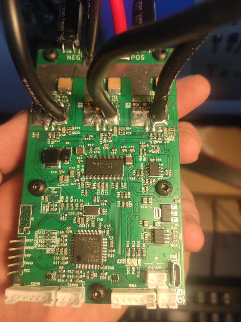

Please tell me there are some isolation between any conductors and the metal screw
Makes my skin crawl
Plastic washers, of course. They’re in the ordering and assembly guides in case someone is not aware of this very obvious need :roll_eyes:
If the follow up question is if I insulated the MOSFETs from the heatsink, the answer is also yes xD
Good lad
Is that needed? Electrical insulation is often thermal insulation as well… Now I gotta check if my thermal pads are conductive or not :thinking:
Silicone thermal pads are meant to be thermally conductive but not electrically conductive. That’s kinda the point of their existence

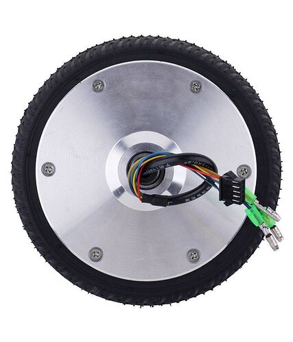

@shaman Hey, we are testing CFOC2 v0.9 with these 6.5" hoverboard motors
However, we experience weird behavior with very low speed (low RPM) with these motors. We also have 10" (pretty much identical), but they manage to get 25-28km/h, on the other hand, with these 6.5" we manage to obtain 15-17km/h, i.e. RPM is relatively low. I was wondering do you have any ideas what can cause this? We tried to play with ERPM setting, but none of us still understands the real impact of it on motor RPM. Thanks.
A larger diameter hub motor/tire will have a faster speed than a smaller one for the same RPM. This a mechanical thing, not a controller thing. Also, are you sure the two different motors have the same kV(rpm/V) rating?
