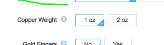

My only question is if there’s any value in increasing the copper thickness in the pursuit of more amps
Looking forward to this!
If i recall SMT assembly wont work if you try, at least i remember that happening for sure when i picked blue PCB :frowning:
Yeah using 2oz copper forfeits the SMT assembly service. So does any PCB color besides green I think.
Amps are already maxed out with 1oz copper with the limitation being the mosfets not the PCB

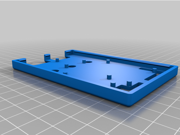

I have finished V1 of my case, i also included a template for drilling, washers, and spacers if you don’t want to buy those parts.
Hey man, good work. Do you have and photos of a cheap FOCer in the case?
Your ebike sounds very interesting, did you share info about it somewhere?
this is all i’ve seen of it. Think there might have been a pic of the bike too.
Added a photo to the thingiverse.
