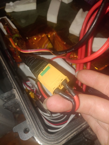

@stratoglide and that’s why I went full xt90. No need for math, I’ll never charge at anything over 20a :joy:
My First 2 builds charge with xt90’s as well it was just easy and cheap.
There is no such thing as a 10 amp DC plug especially at 50 volts. Gx16 is the go to but has to have a water tight can and fuse (60 amp) if charging at 10 amps. I use a 50 amp 12v fuse I charge at 8 amp, I tried the 20 amp use in my other build it got very warm.

My lightbar is connected through my charge port (but mine is xt90) with a pico switch
Has been working well for over a year now
My bms is wired as charge only so when my lightbar is on, I actually see it in my app. If I lock the bms, it cuts off the power that my light is pulling
