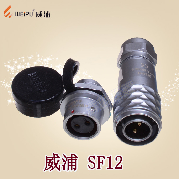

Iā€™ve got the GX-16-2 on one of my boards and am installing it on another one, I love it. You can find dust covers on ali pretty easily, want a link?

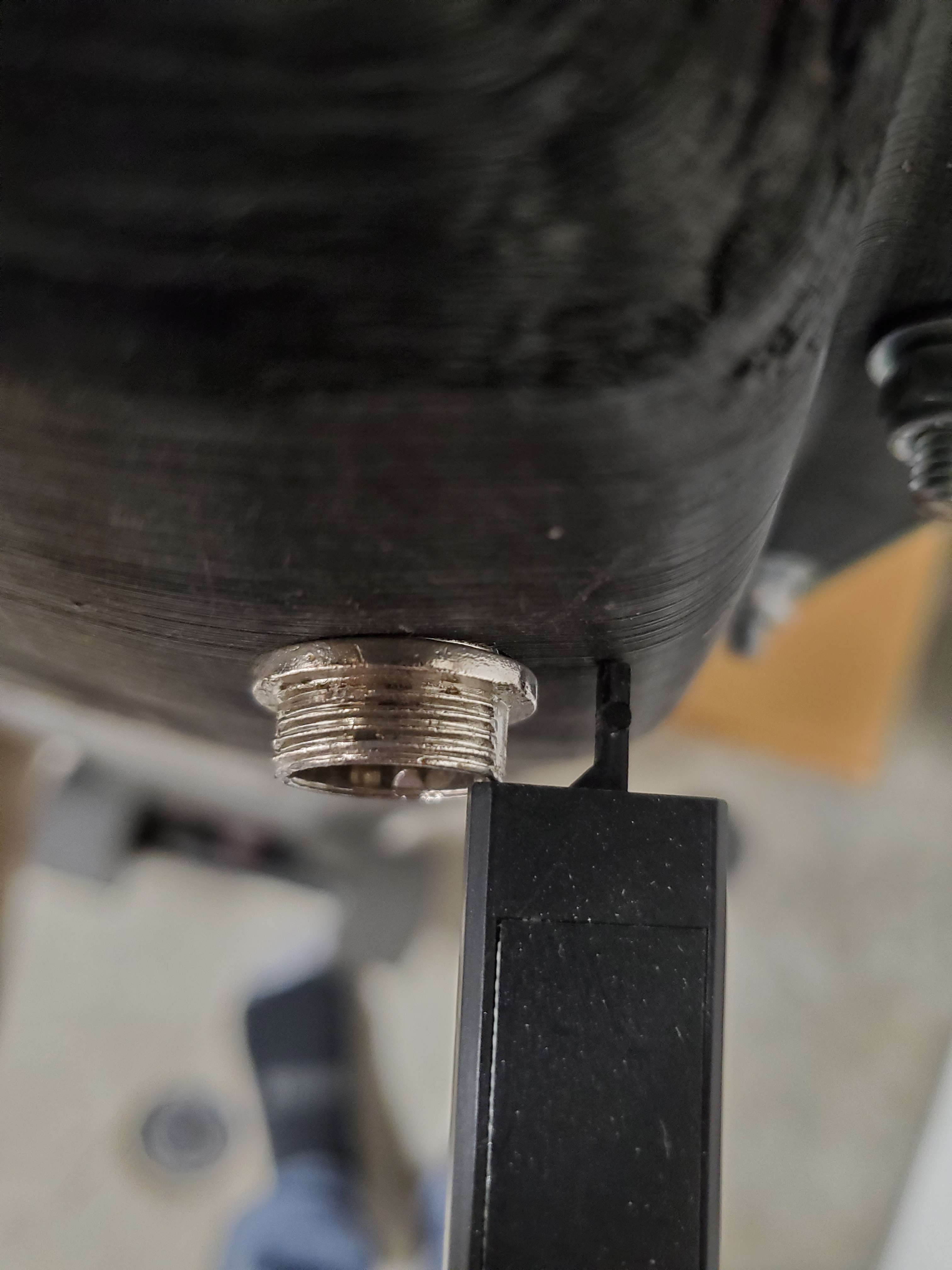

Yea thatā€™d be great. Can you show a side shot of the female port for the board side? If theyā€™re not terribly deep it may work well. Might have to just get my hands on some.
I ordered 8 of this rubber one the other day. Iā€™ll grab a pic of it in my enclosure in a bit

Those dust covers look great
They look great. But they are metal. Make damn sure you fuse those charge ports. The metal cap WILL short those pins out if youā€™re drunk or tired or itā€™s dark and you canā€™t see well.
Also the first time they get wet, they have this sandy grit on them and they do NOT screw on smoothly, itā€™s like grinding

I highly, highly recommend the rubber caps
And make sure you use a washer, they donā€™t stay on very well at all without a washer. (I mean a bigger washer than the stock ones)
Iā€™ve been using these for years, they are good jacks. But the metal caps suuuuuuck.
The rubber caps are surprisingly good.

There were two options on my link but I do agree that visually the metal caps do look pretty cool. I got the rubber ones from the same link
Also hereā€™s a few pics on my enclosure
