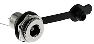

The connector isn’t that great for plugged in while operating. It’s pretty big. I did see a 90* version.

I use the same charge port from amazon and charge with 8A since 1 year without any problems. They just get slightly warm, that’s it. Before I had a plastic jack which got quite hot at 4A and melted.

Been using this port @ 84V 5A (420W) without any issues what so ever.
Best port I’ve seen and used to date IMO
I’m also on 84v with my ebike. I run c13/c14
They’re rated for 15a. But unless you have space, these are rather intense
Yup. 84V@6A here, the only issue I’ve had is the little loop for the cap broke off.
I’ll 3d print a little washer with a loop next time I have it all apart.
I have these in 10 amp and 6
amp from amazon and they’re totally the same thing. I don’t trust the ratings
10 amps at 12 Volts and even that’s exaggerated. At 84 V you consider Anderson plugs or xt90
I considered them, but decided against both of those for space reasons. Plus both of those are rated for dozens of amps, so it’s totally overkill for a 10A charge port.

I picked up GX16-2 plugs and ill be using those.
