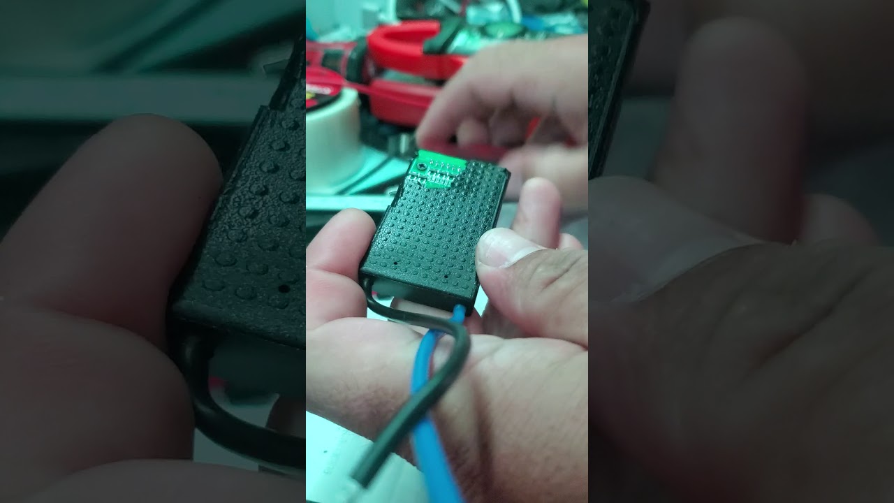

Can you very you can turn a 12 into a 10 for me. Today is house chores. No esk8
Are they easy to open?
Yee. Just clip th corners. Then rubber peels off
I’ll make a video tonight if you need or wait till you get yours. Takes 45 seconds. Thought it would be harder. It’s basically hot glue status with less stick
Yes please. I need it a little bit slimmer to fit this enclosure
I tried opening it and broke it lol
I made this two days ago and forgot to post
What broke? Take a pic. I can remove a transistor from a parts one I have if you know how to rework small SMD
Ok, so here’s my attempt at turning a 12s bms into a 7s bms. (thanks @Winfly)
It’s on the charger now. I have confirmation that the BMS is putting proper current into the battery and that it is not producing smoke.
TBH was scrolling down hoping for fire. But glad it works.
This is how they adjusted the 16S stock to 12S. And the IC say it’s suitable from 5-16. So I hope it actually works as intended.
Where’s the 16 sot-23’s at?
sorry to disappoint, lol
I just finished cycling it once, it charged again, so looks like it worked, but I think it will take a while to verify balancing function. Overvolt/overcharge protection definitely working, actually cut me off a little early at 4.10 v per cell (which I like). next time, I’ll try and have a sparkle show for you :wink:

16s universal can work with 4-16 with a simple modification
Isn’t his diagram wrong? I think esc negative should go to P-
EDIT: Never mind! I figured this is how you’d wire it for charge only, which is what most of us want
