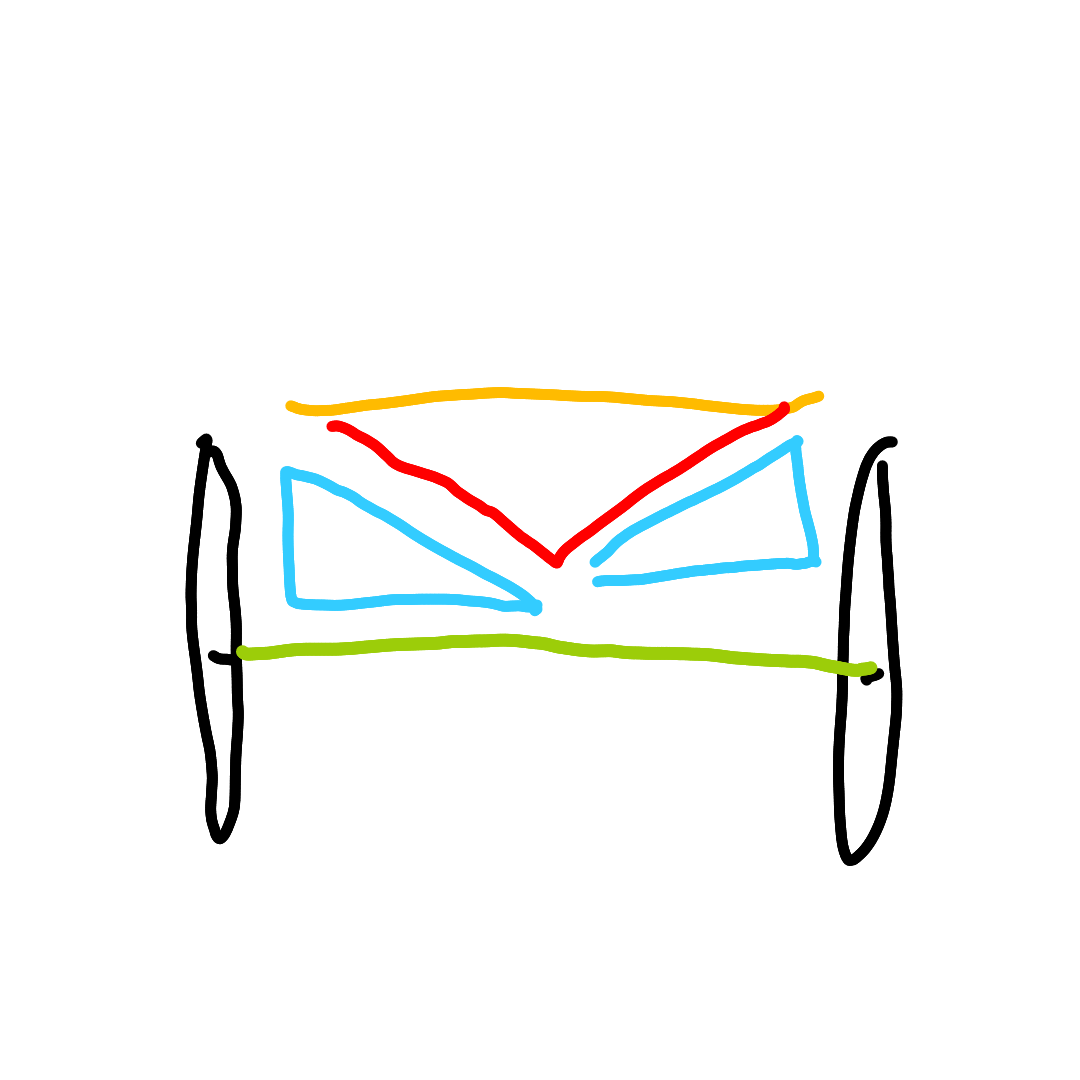

What effect do you think an ultra wide baseplate and wedge bushings/springs would do?
Bad phone drawing time…
The suspension would need to be much softer to get any turning since the wheels won’t track as much. Would a steering rack be necessary for individual wheel suspension to actually work?
I see the individual wheel suspension in cars being wider and over the individual wheels but obviously the car doesn’t lean as much as a deck does either.
I would think that the width of the base plate shouldn’t make any difference to the feel or performance as no actual geometry changes. Obviously wider wedge bushings will add stiffness so would need to be softer to compensate.
What do you mean by this?
Are you asking if it’s possible for independent suspension on a channel truck style design? If so then I think it would be but it might require some clever thinking.
Since at full lean on a standard board, you could theoretically hit your deck to the hanger. If you had deck wide wedges, they wouldn’t be able to compress fully.

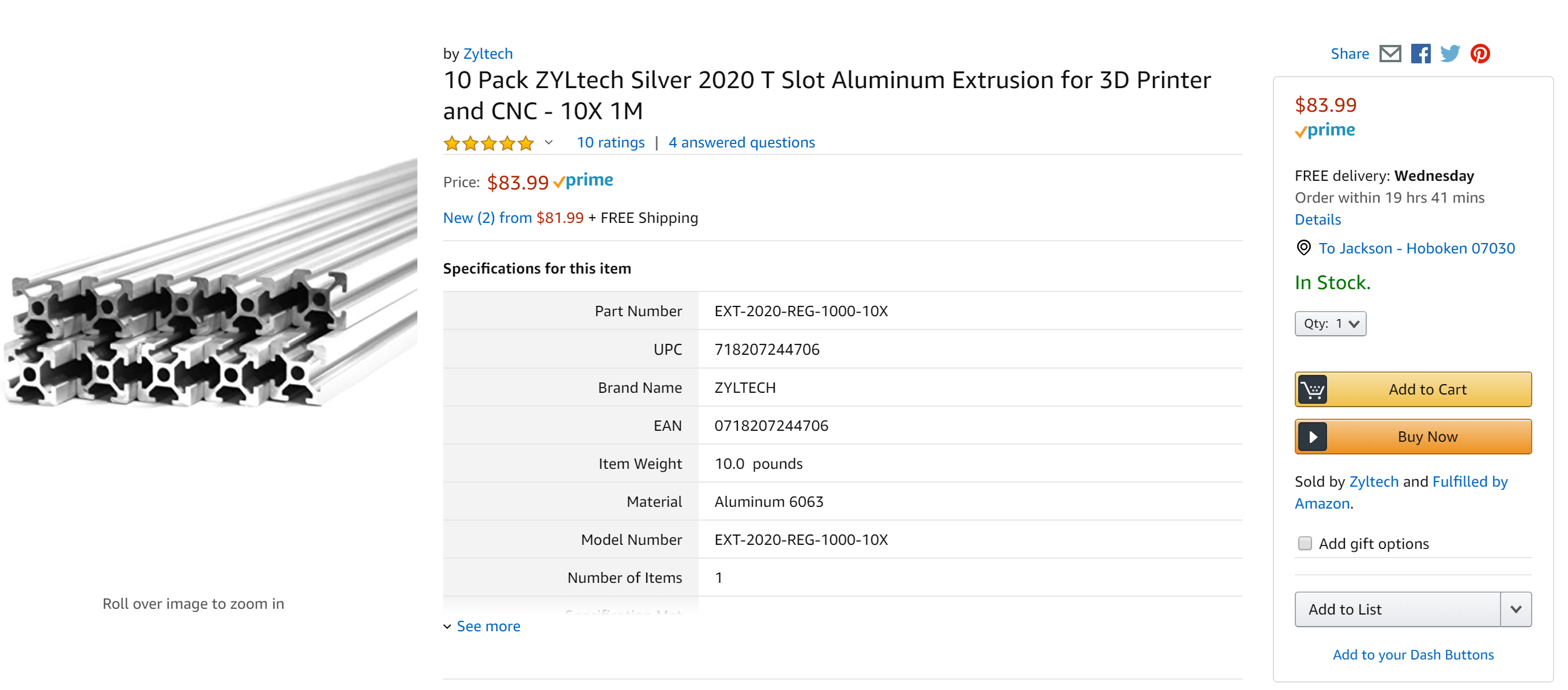

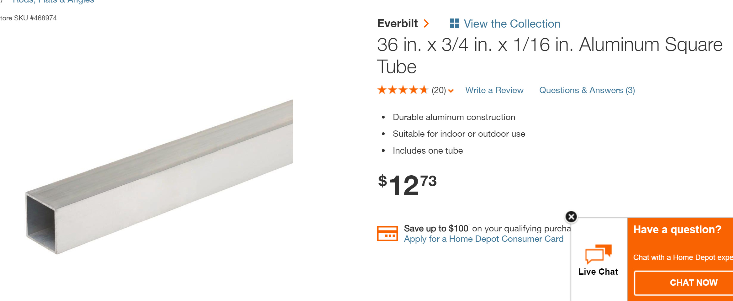

I had an idea to do a body on frame esk8 with the frame made out of these Aluminum rails.
The body panels and internals would be 3D printed and bolted onto the frame. Who’s down to brainstorm?

What you want is the 4-slot double x-rail extrusion from McMaster in 80mm x 40mm
The slots will accept standard longboard baseplate patterns so you can adjust however you like without mods to the deck or trucks, and it’ll be nearly indestructible
