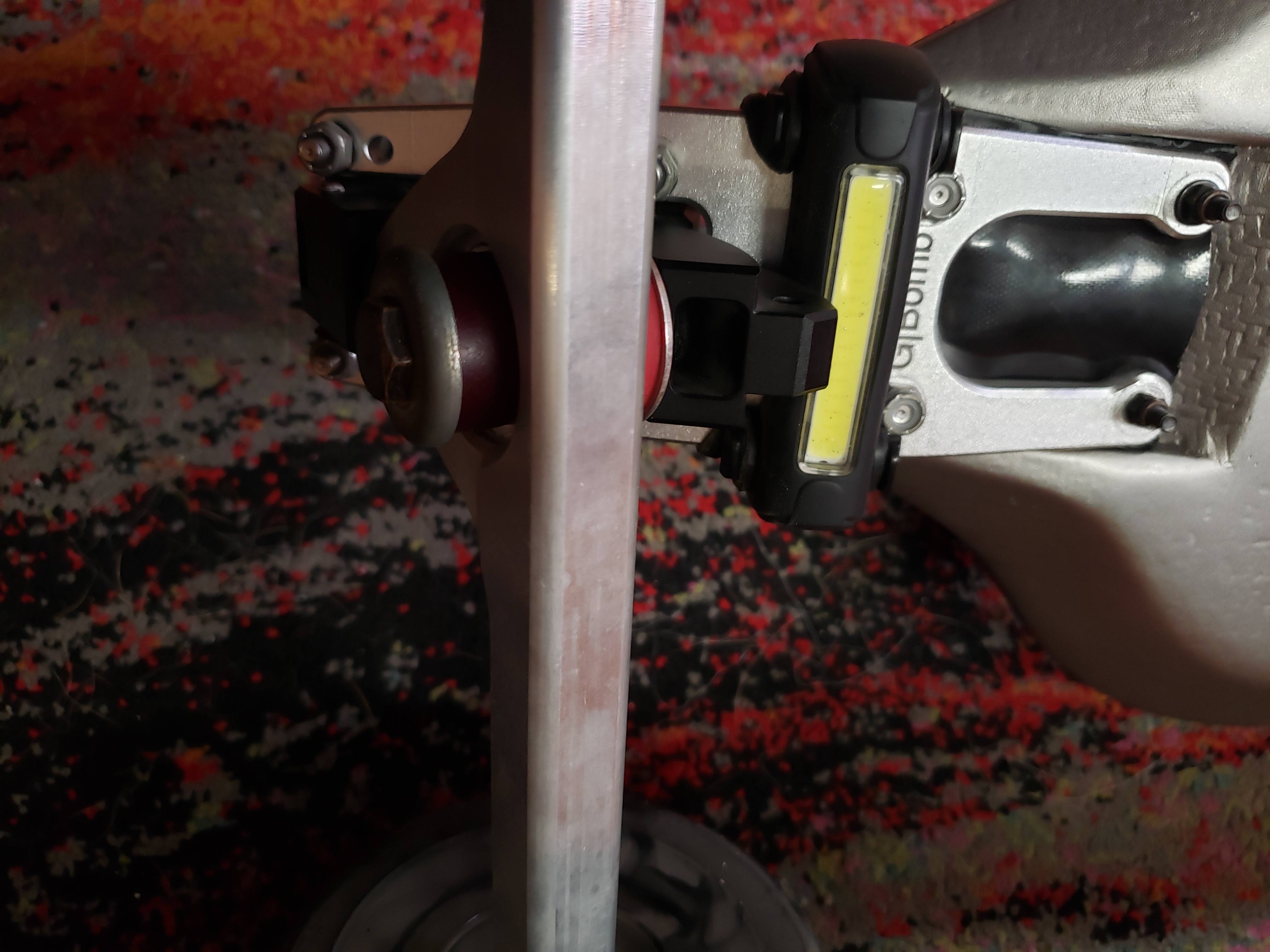

Hey, here’s the picture of the bushing seat. Both side of the hanger have the same bushing seat.
OK based on what I see the hangers will accept Cones, Canons, Barrels and FatCones but not Chubbys. I am surprised the Magnums fit well, must be the same thing going on in the TB 218’s . In any event running a KranK 93a Canon / KranK 93 Magnum front and a KranK 96a Canon / KranK 93 Magnum may not be properly balanced. Try moving things around a bit and run a KranK 93a Canon / KranK 96a Canon front and a Krank 93 Magnum / KranK 96a Magnum rear. I think you are restricting the front too much. if that is still too much up front, change to a KranK 96a Canon / KranK 93a Canon. Just so you know, I list bushings Roadside / Boardside
