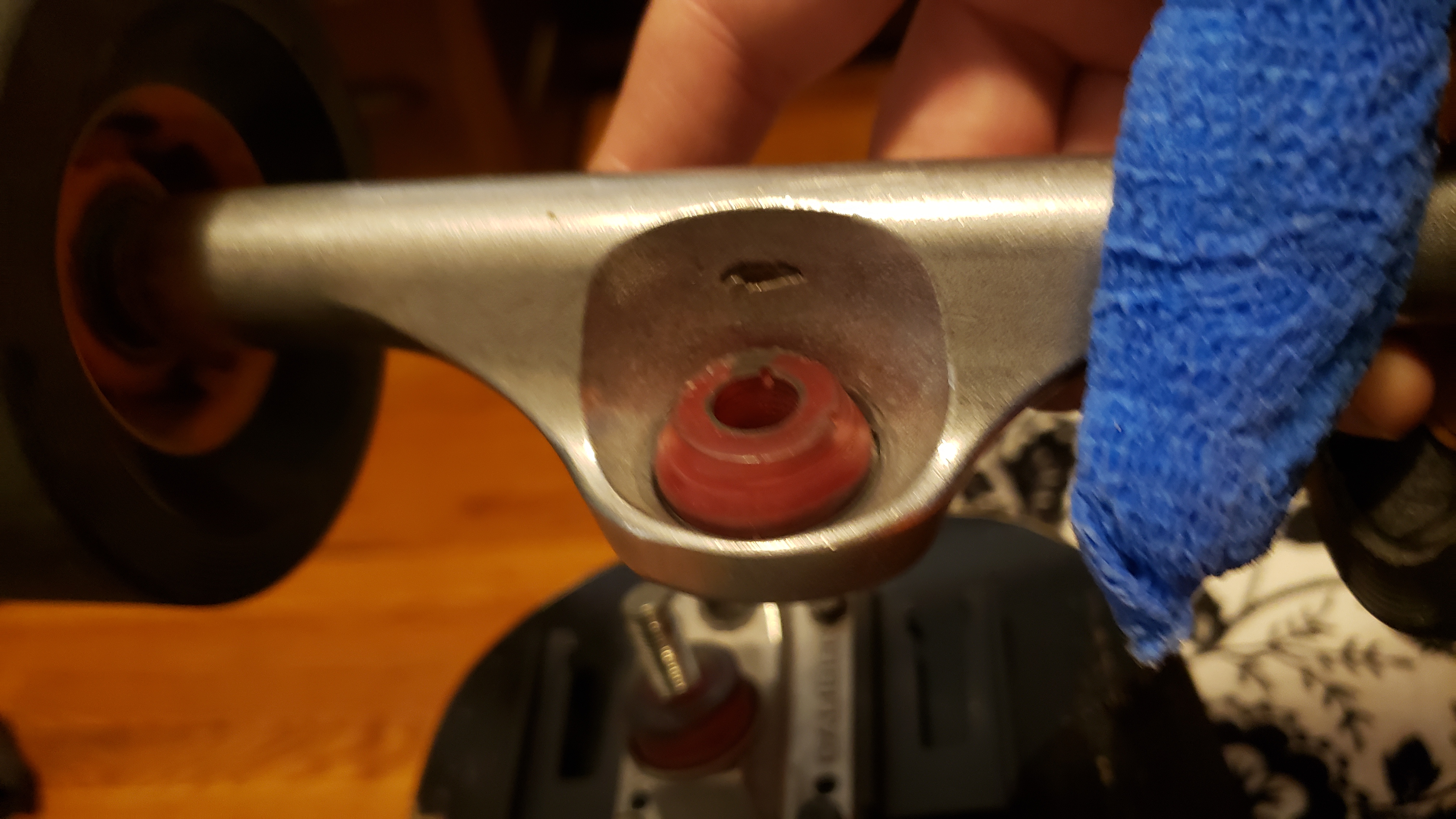

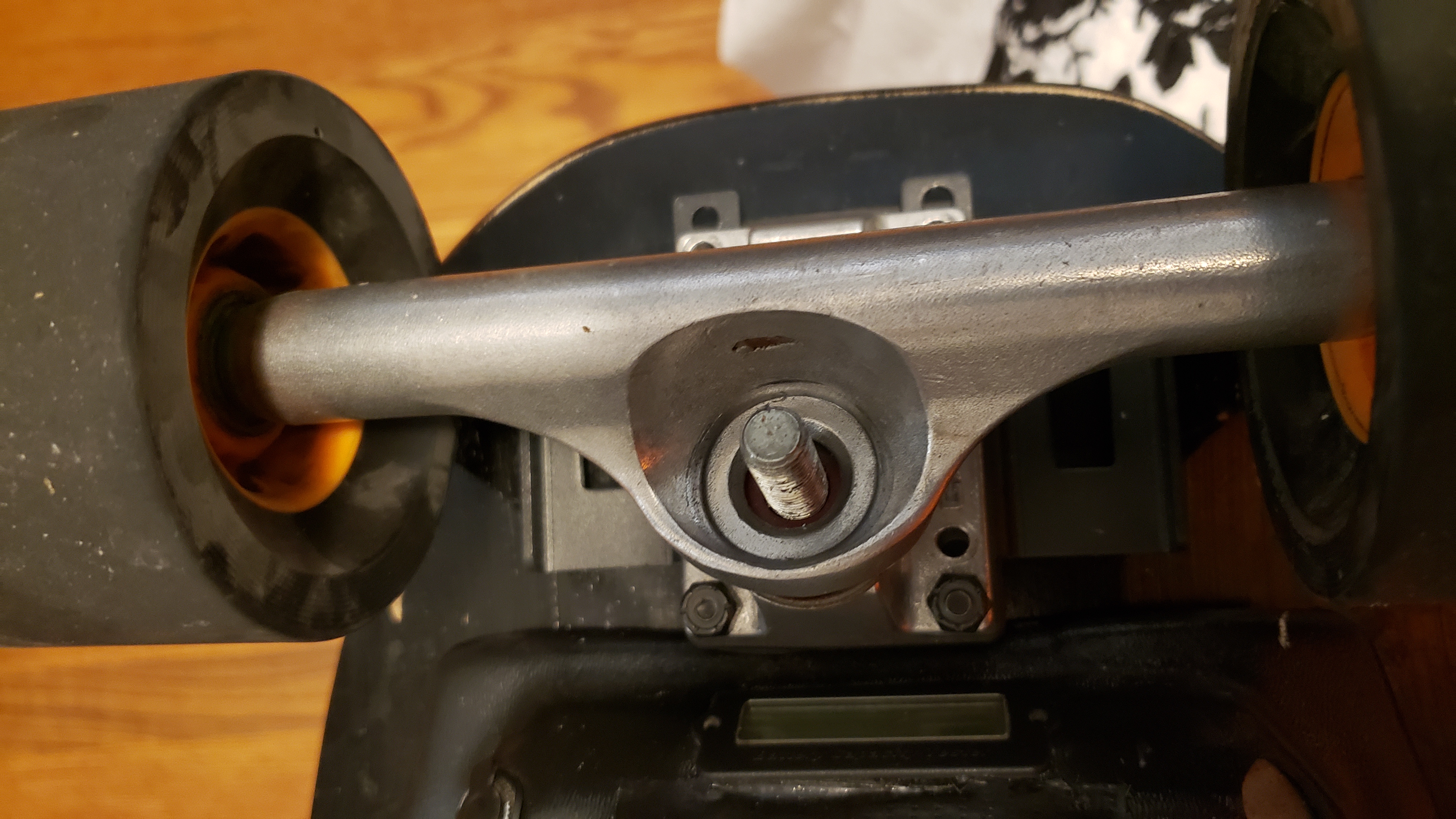

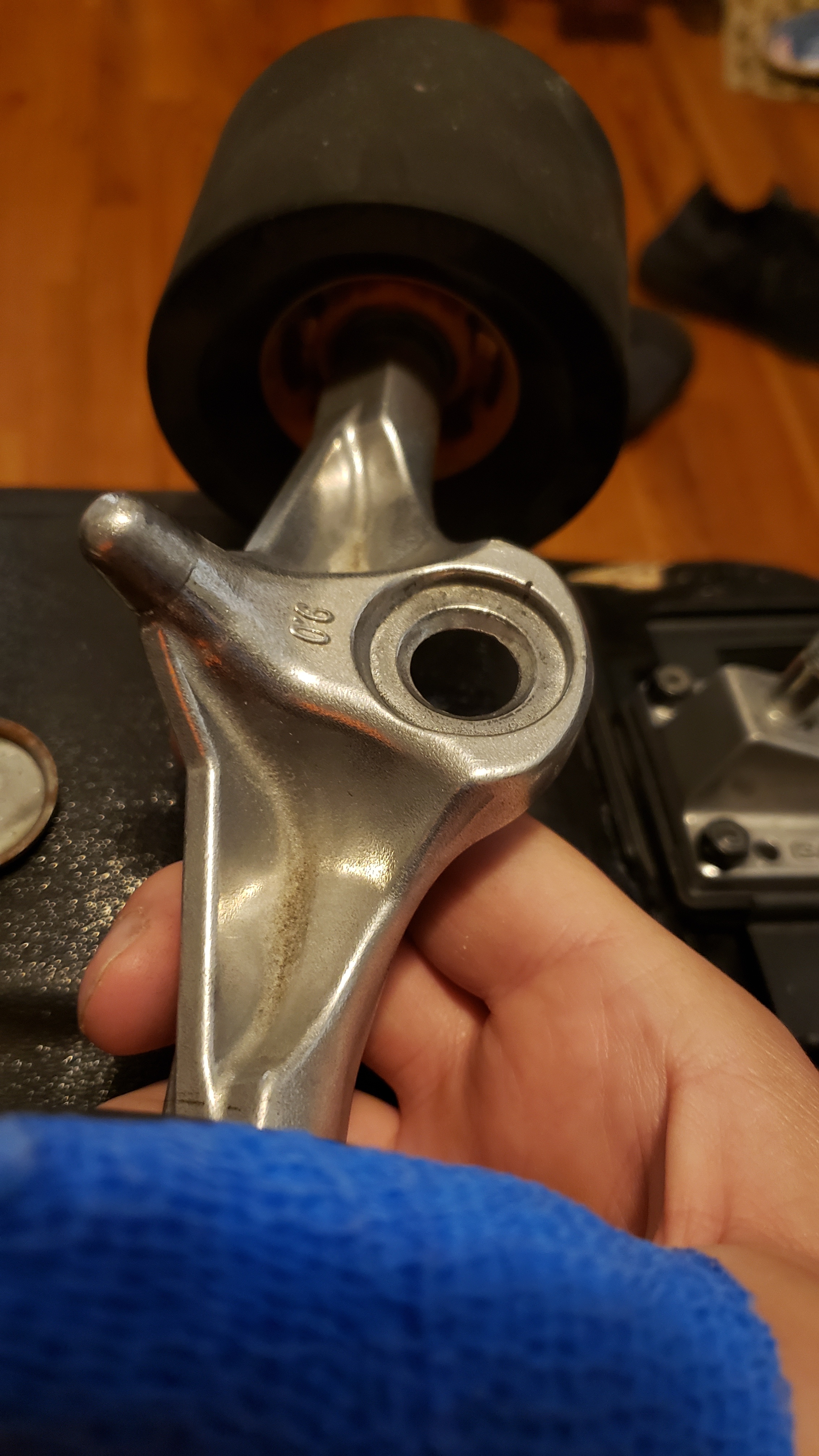

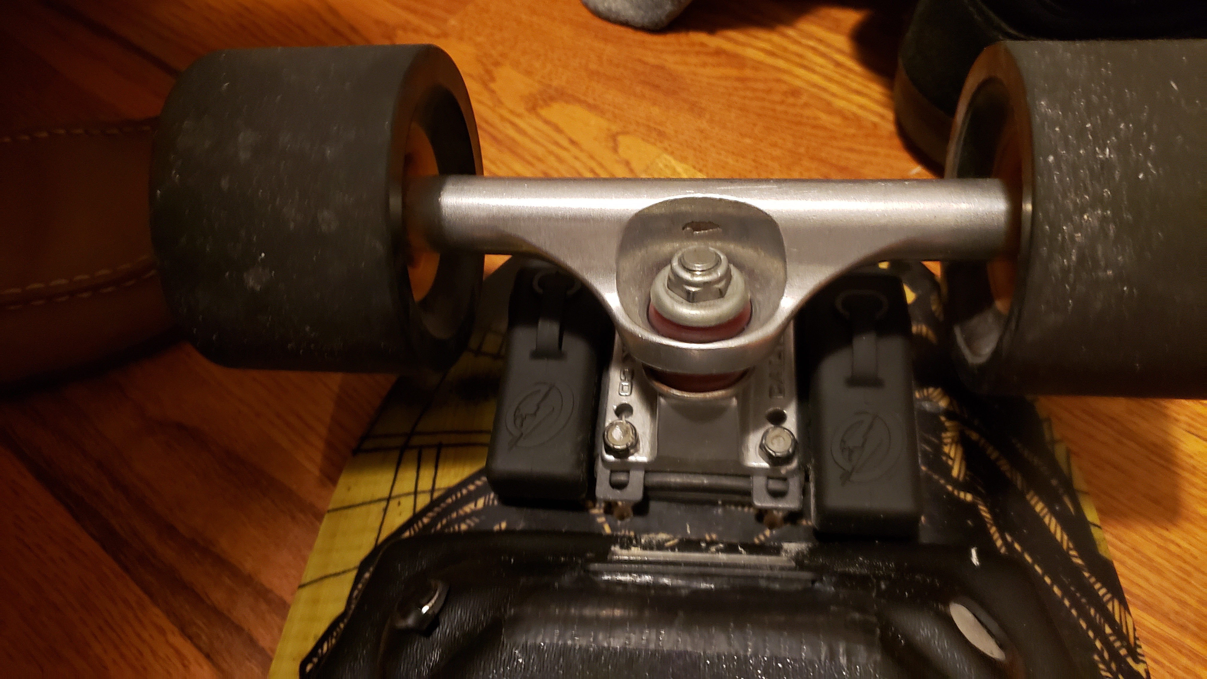

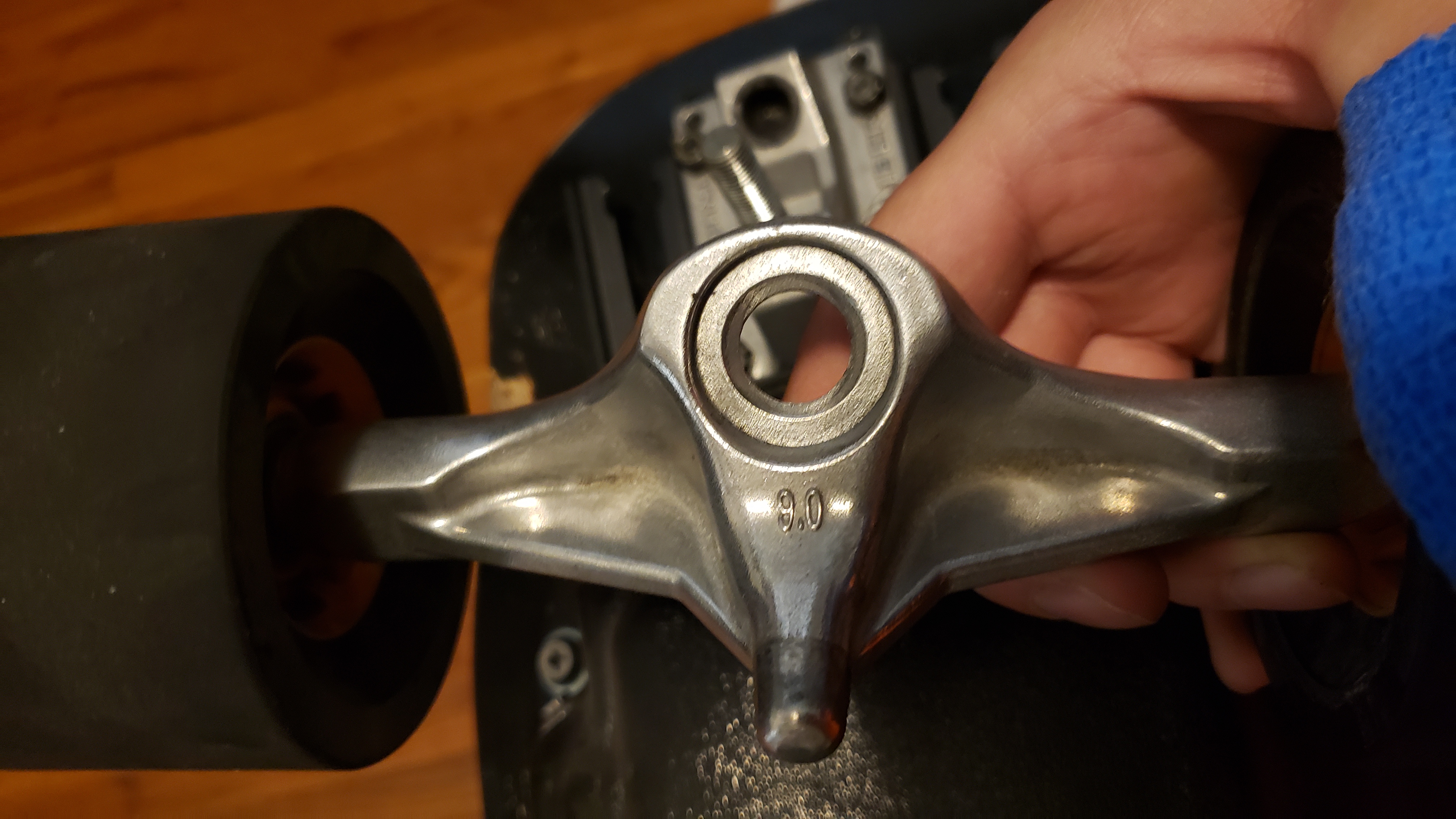

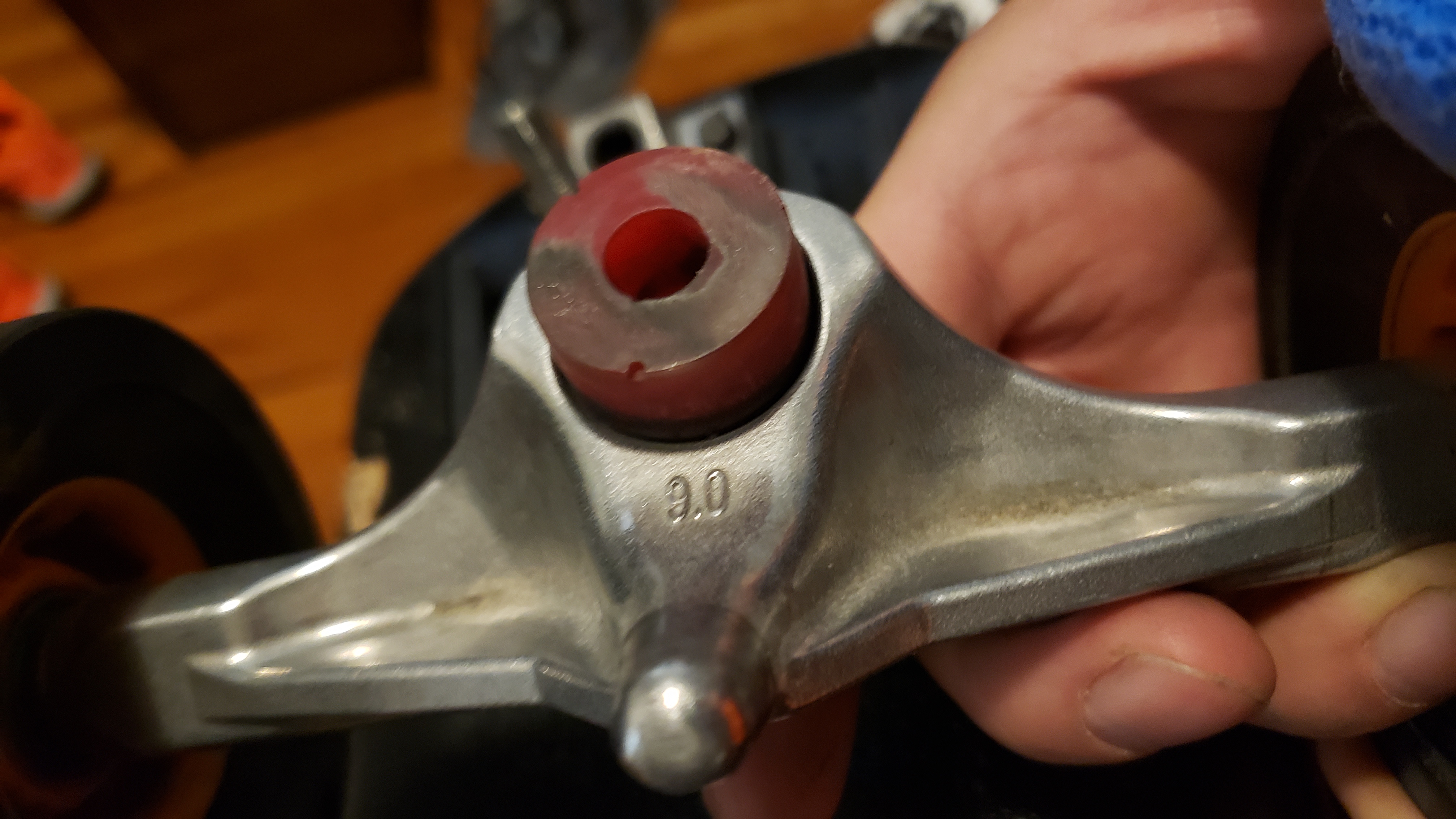

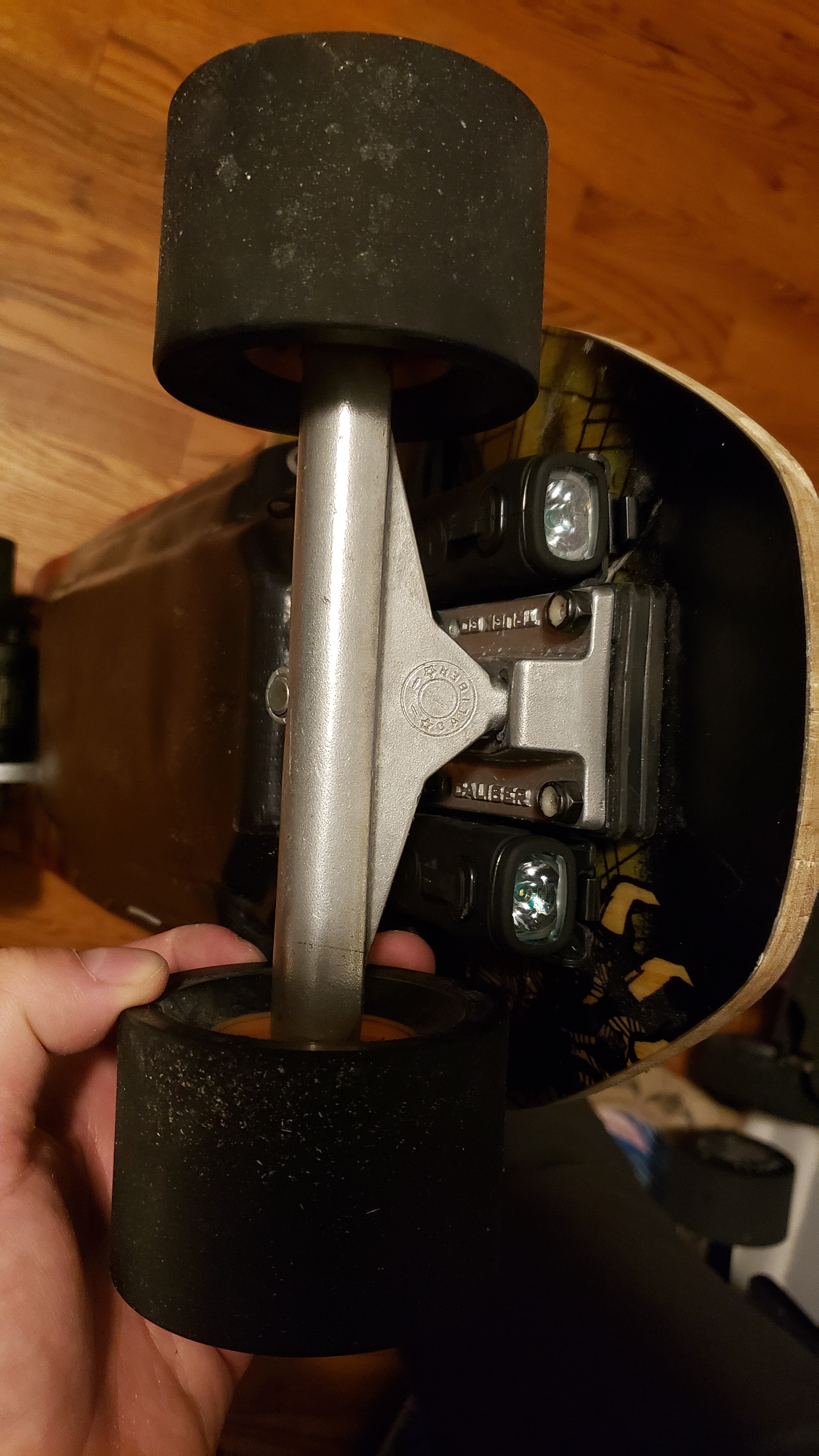

This is a short deck set. 21 inch wheel base.  Jet Spud. from my old Metroboard micro slim…
83mm wheels. on TKP Caliber Trucks.  this is a cruiser so I hope it will be carvy. the board has aggressive concave and is super nimble.
don’t expect it to be super fast.  25mph max i think  really 20 usually. so as per usual would need stability.

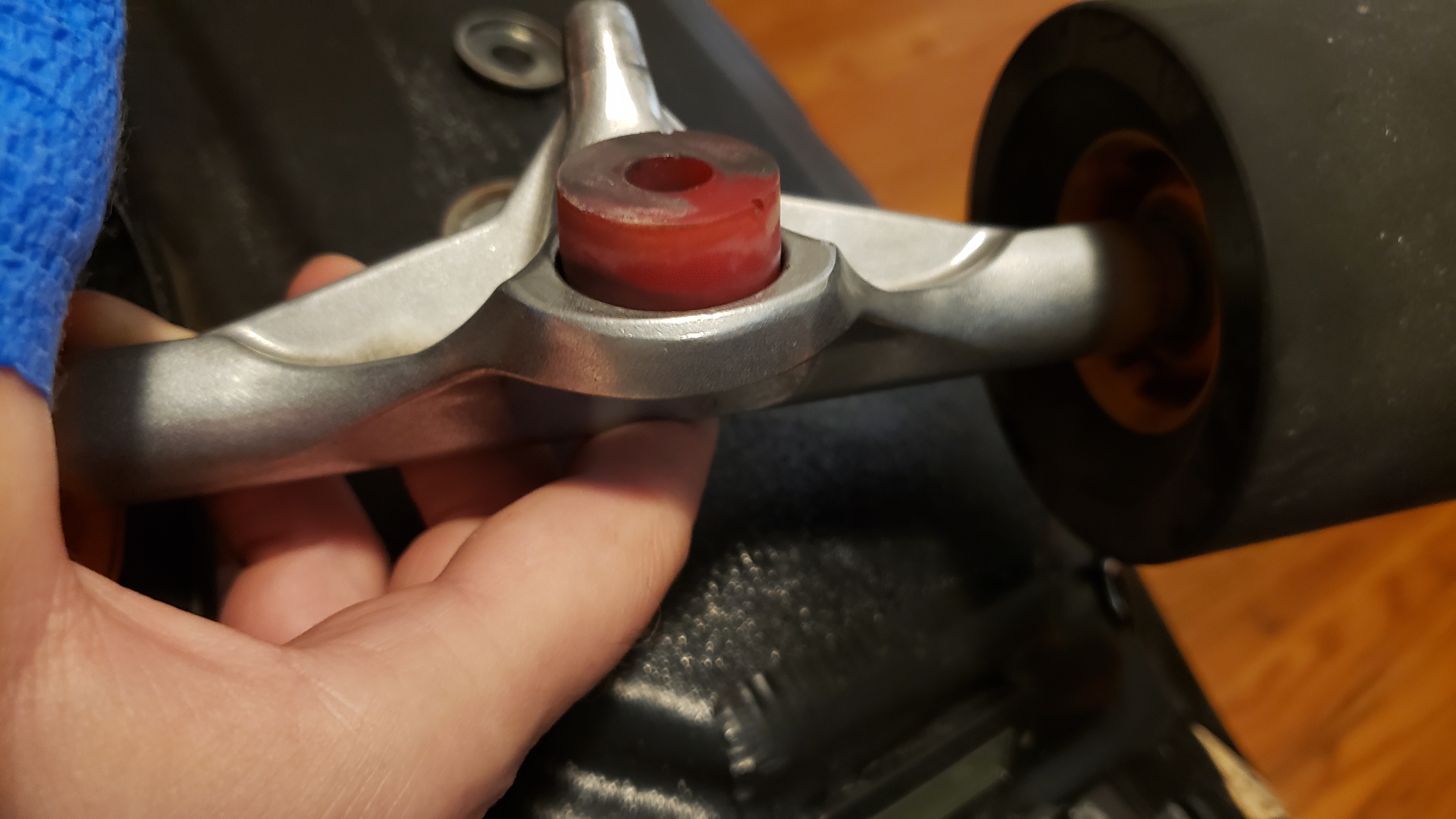

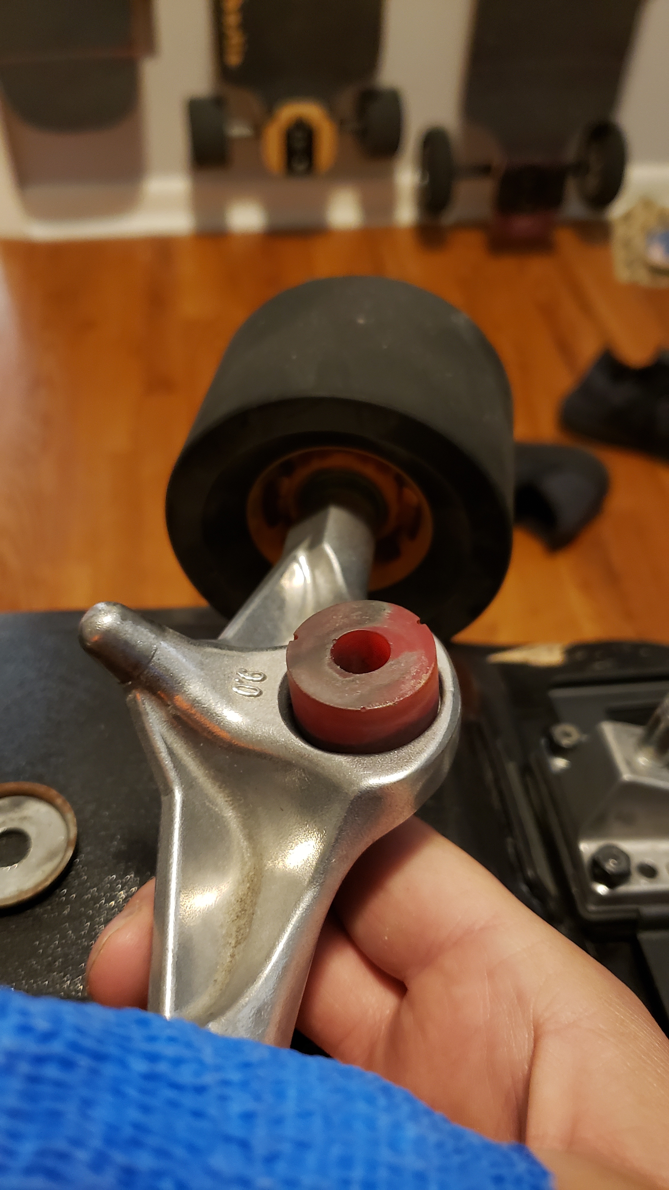

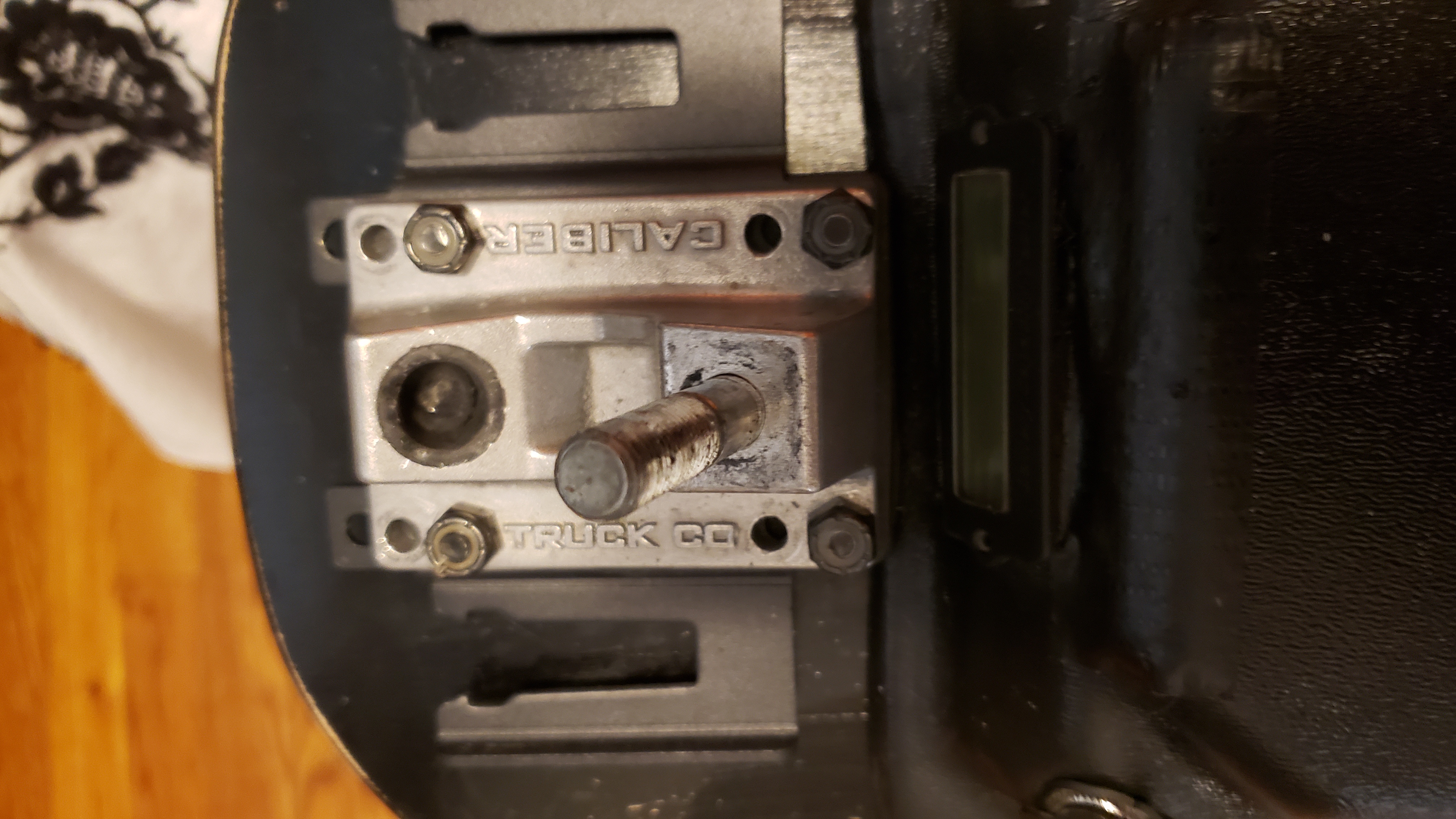

              Are they the Caliber Standard or New Standard?  The Standard was made first and had a really bad bushing seat that did not contain the bushing so the trucks would wag horribly!

I am not sure. I will need to do some digging to see if I can figure that out.  they came with my metroboard micro slim I bought about 3 years ago.
              Hey brad have you seen my post a couple of posts up?
              I can likely tell if you take the front hagner off and take some pictures with a bushing sitting in the top and bottom bushing seat
