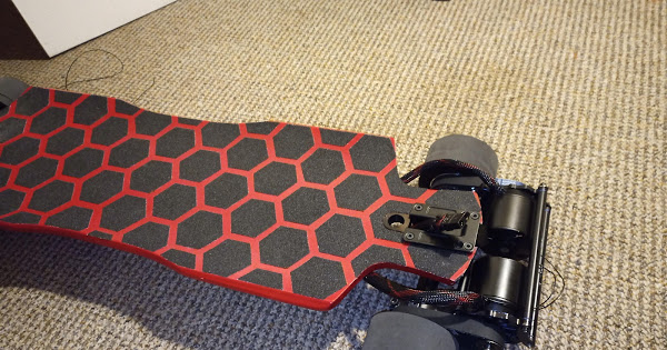

Hello have tourqboards trucks is there a bushing tat stiffens the travel up
Thank you
Come on man, read the original post to see what information you need to provide lol. Or read literally any of the other requests, and you’ll see that you need to give him more information to help you.
Of course there are bushings that will stiffen it up haha
Fair enough, just thought there were standard bushings That stiffen up tourqboards, 218
My weight is 13stone but I’m on a diet aiming to loose a stone, I will get there.
Only been riding for or a couple of weeks after a 43 year gap :). I has the first original plastic deck back in the day.
Really Want to stiffen up movement as deck really is loose, I really does wobble violenty at speed.
Wheels are evolve 97mm 76a and not really sure what the deck is here is a pic of it.
Google Photos
Google Photos
Pic of the trucks they are sort of mounted through the deck.
Is there any other thing needed?
Also it does veer to one side slightly when nothing on deck and press go on remote, is there anyway to remove this?
Thank you
