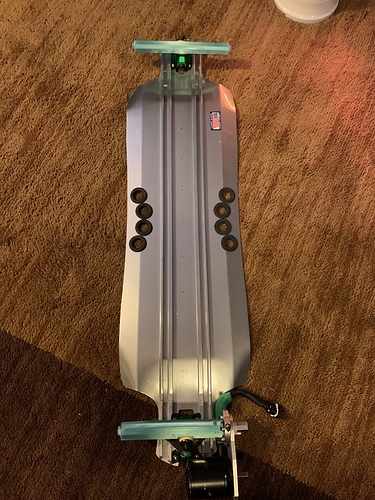

Hello there!

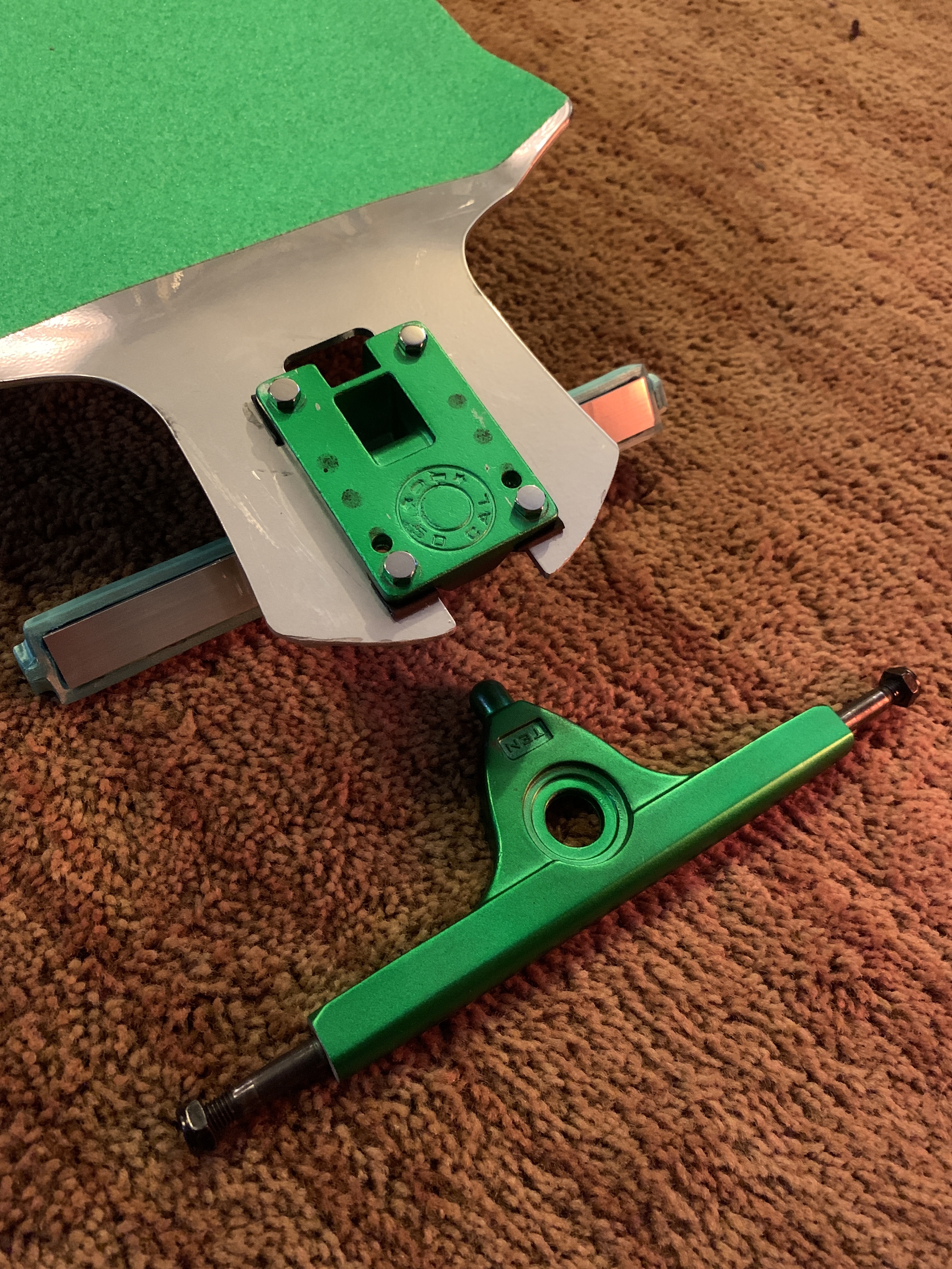

I have boardnamics hangers (longer with a shorter turning radius) running caliber 2 base plates.
Running the original bushings that came with the 50 degree caliber 2 trucks.
Planning on higher speeds, cruising 20-30 mph, looking for a stable, well rounded bushing that prevents speed wobbles but still allows reasonable turning. ‘Snappiness’ and carving are not a necessity.
Deck is roughly 40” long, drop deck, good cg
I weight around 155 pounds.
Looking to replace the stock Garbo white bushings
As seen, larger bn hanger is replacing the original hanger, but the 50 degree base plate remains.
The kind pins are symmetrical (nut side of the kingpin is pointed to the outside of the board on both ends.)
OK so the Beercan deck does not have any camber? They are 50 degrees front and back?
It has some but minimal camber on the deck, say 5 degrees. So I’m guessing that changes it to 55 from the original 50 degrees of the calibers.

So if it is the same front and back, they are both de-wedged 5 degrees leaving you with a symmetrical 45 degree setup. Is that how you want to leave it @Rob?
Yup, u got it. that’s how I plan on keeping it
