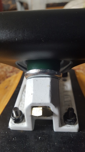

Could you direct me to a few pics of what an overtightened bearing + precision washer setup looks like? I know the general don’t go over 720* past difficult to turn by hand, but since I don’t really know what I’m doing, I always get a little concerned when I see the washer digging in and the bushing bulging over. Pics I’m posting are less than I’ve done before and under 720*.
I’ve been having some weird truck feelings ever since I changed a few things at once (bad idea) and I’m trying to narrow it down. Maybe one thing of importance I learned - the geometry of the heXL baseplate is such that a tall bushing is required board side or else centers do not line up correctly once the pivot is seated. I always thought something looked funky when I was using the standard sized bushings. To remedy this, I’ve added the height equivalent in solid washers underneath. Do you think this is bad? Should I just eat it and buy tall bushings as well? If the washers aren’t there, the baseplate hits one half of the perimeter of the top of the bushing at an angle, and begins to compress it in that orientation.
Also, of slight note, an array precision washer w/stubby support won’t fit fresh bushings. If you line everything up, and tighten them down, for lower duros it will press itself in - for higher duros, it will typically go in at a slight angle, and pop back out of the bushing when you take the kingpin back out. To remedy this, you can slightly wallet the washer end of the bushing or slightly chamfer it w/a very sharp blade (and Brad will probably tell you that’s a bad idea) - speaking of the array washers, do you have any feelings on them over plain flat washers @RipTideSports?

You can shim up standard bushings to to proper height but best to use TallBushings. Having that much exposed king pin is definitely a liability and Hexel trucks can take larger shapes than TallBarrels so you might want to try TallFatCones and TallChubbys, especially if you are having to tighten the nut so much. Best position for the larger shapes is boardside. Precisions washers can be used but for the expense, I would just use standard cupped washers if you want to restrict a setup
Cupped washers are more restrictive than flats. If the cups aren’t enough, you need to go up in shape or durometer.
Hmm… what do you mean by liability?

Noticing the whole geometrical centers thing tho, will post a pic if it’s confusing, I just can’t consciously go back to the setup I had. Something’s definitely not right about compression coming down at that angle.
It looks like there’s enough kingpin to run two Tallbushings. Would the only difference between 2X TallBushing be more leaning and carvability at the price of stability, and 1X TallBushing 1X standard barrels be less carve and more stability? I presume in the end the difference is probably pretty mild… But fuck. Now I’m just confused. Kinda just wanna say fuck everything and get new trucks at this point.
Liability in the sense of easy to hang up on an obstruction. Hanger crash is evident due to the unshimmed use of .6" tall bushings. Personally I never did trust the Hexel hanger design for several reasons so if you can afford other trucks, for your high speed set up, I would encourage you to do so. Tall bushing set ups can be made to perform like standard bushing height set ups but you need to go harder or bigger with the bushings in the tall configuration
