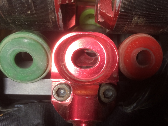

OK @olsyke, here are a couple of things to try. First, SZ in their infinite wisdom changed the bushing seat on the TKP a while ago so it would no longer accept the Chubby shape. I am wondering if that may be part of the problem. Try running a Barrel / Barrel front and a Barrel / FatCone in back all in the KranK 84a and send me a picture of the rear boardside bushing seat.
Also try running a 84 Barrel / 84 Barrel front and a 84 Barrel / 90 Barrel back.
@RipTideSports
as far as i can tell the bushing seat is symetrical board/roadside, i bought these trucks used from @skunk, so it might be possible these are still the older version… its hard for me to tell tho, the chubby does somewhat fit, but not perfectly
im also tempted to fill the gap in the duro’s i own by buying a set of all the relevant shapes in white 87a if that makes sense
Those are the newer and do not fit the Chubby
allright, thanks for the insight :heart:
i will go with the solutions you gave me and report back
