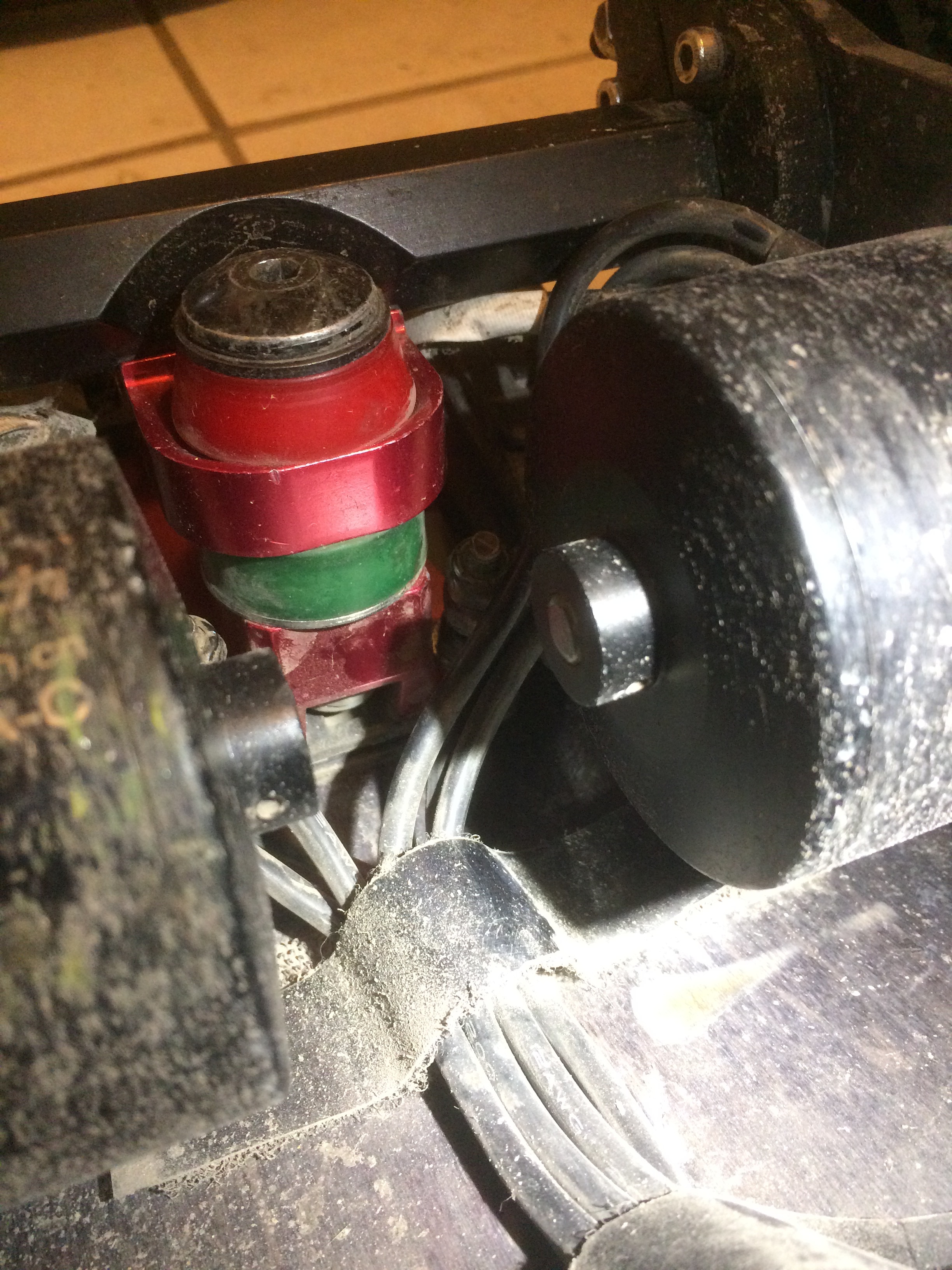

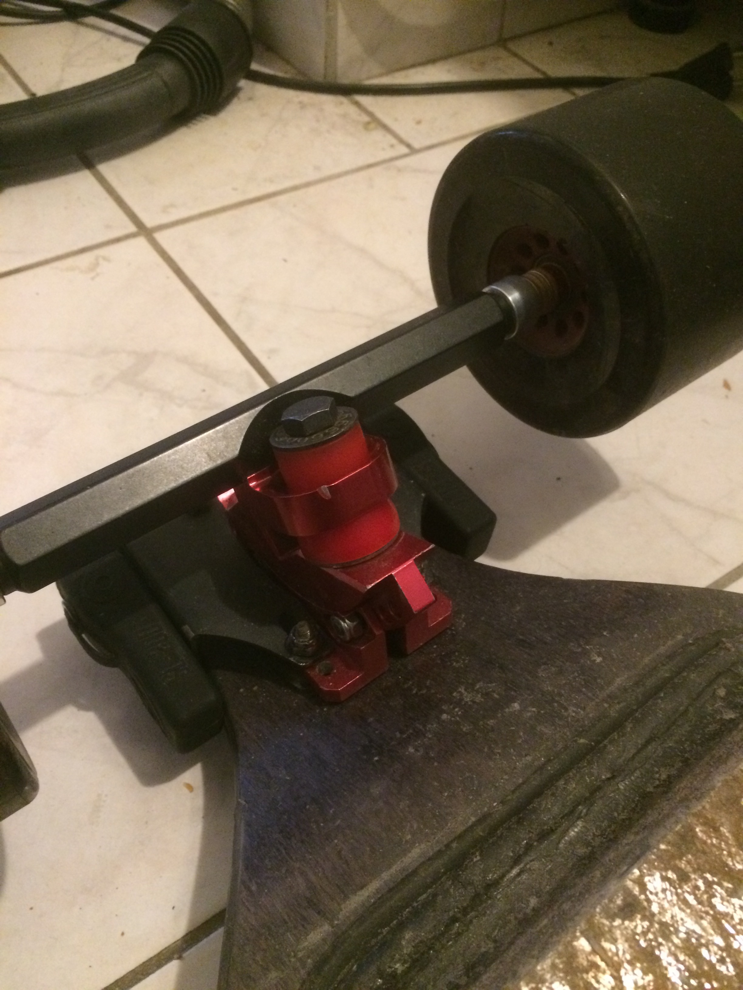

hey, would really love some help with my chaotic setup…
im running an evo with surfrodz tkp trucks.
the front baseplate is adjustable and set to eliminate the nose wedge. its mounted on the baseplates outer mounting holes to reduce the increased wheelbase that comes with the tkp.
the rear is keeping the evos angle, but the wheelbase there was also reduced by drilling new holes in the deck.
im weighting 178 pounds, and i like my bushings on the softer side.

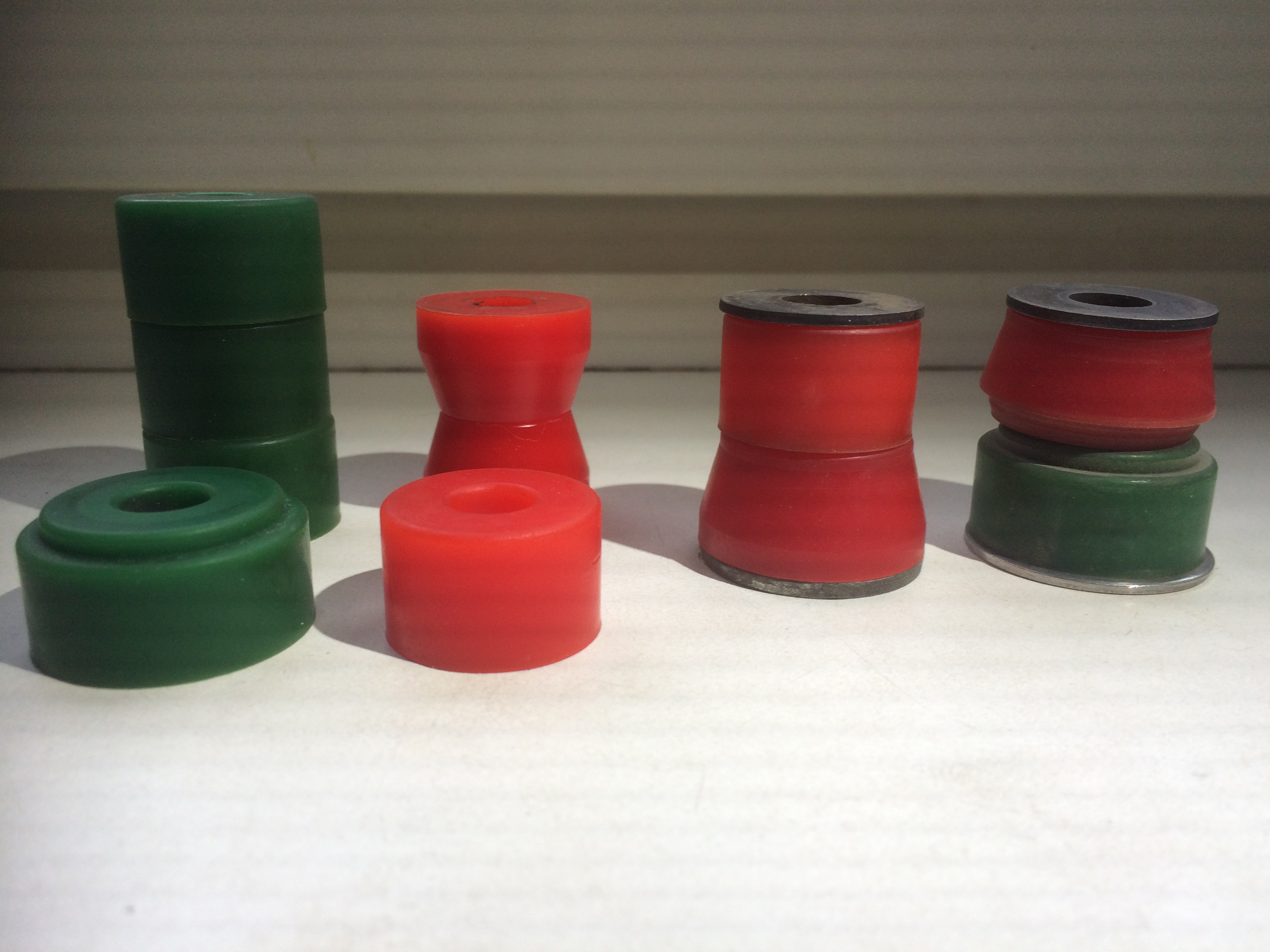

this is what i have available atm, a mix of 90a and 84 bushings,
the right two stacks being my current setup.
i got the 90a because i saw you recommended them to an evo rider that had similar weight, but felt they were too unresponsive for me by a lot, so i went and got the 84a because back on my ecaliber trucks i was allways running the softest otang nipples basically…
however i have a second build sporting a jet spud, and there the 90a feel more workable!
so, the rear setup right now actually feels very stable but goes dead quickly if i tighten the bushings a bit too hard (sorry for abusing your fatcone like that :sweat_smile:)
what im looking for is improving the turnability of the front truck, without being too prone to wobbling on small bumps / at speed.
that being said, i wouldn’t mind trying something different if you suggested so!

Wow, this is a bit chaotic, can you post some pictures of the actual bushings and the front and rear trucks? I need to get a full picture of what you are working with before I hit the reset button. I really resist going by color. Do you know the duros you bought and why you bought them?

OK, so based on what I said about the theory of compensation by shape, doro or use of washers, what do you think you should do? My goal here is for you to direst the concepts for your own advantage. Lay it out and start with the effective base plate angles, the trucks you are using and a list of bushings you have at your disposal and I will help you fine tune it if needed.
