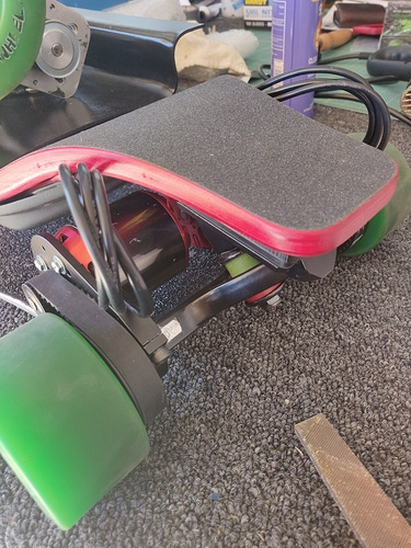

@torqueboards @Kellag Here is my 35d baseplate with riptide pivot cup :rofl:
EDIT: this is my 50 degree baseplate and 35 degree isn’t much better Fml
Haha yup my shit is the same, loose as a goose
