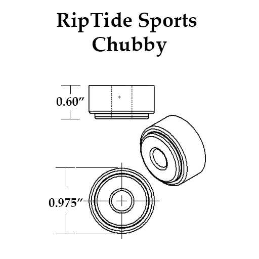

Brad these numbers are wrong, the diameter is ~30mm
Height is probably right though
Yes I know the large ID is 1.1875. I keep forgetting to change it
one question that i forgot to ask last time, will sz tkp’s accept krank magnum bushings? i wondered about that since i learned about the chubby not fitting
No on the Magnums also, SZ seats are substandard when it comes to versatility. The FatCone was designed for them so go that route.
