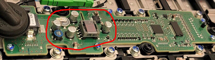

The $$ for just the voltage isolation in that board is higher than entire esk8 BMS’ parts costs. :joy:

I think that all the components I’ve circled are dedicated to getting power and/or data across a voltage isolation gap, including that custom transformer ($$$).
Each module would need power and isolated data lines in order to talk to the “brain” for the BMS. Since each module is probably at a different voltage, in series, they would blow up the master controller (“brain”) if connected directly.
The Texas Instruments web site has good info on EV BMS systems as they have some very capable automotive BMS controller chips. You can go down a verrry deep rabbit hole with stuff like passing ISO26262 testing, being ASIL compliant, and other safety-related automotive stuff that these BMS’s need to handle.
Are there any numbers on these two big chips?
Yes, I’ll get you those numbers when I’m back into work on Monday. Thanks for all the info John! As always, your insights are invaluable :grin:

Rectangle chip:
SPF2011
SK 3626A
Square chip:
31421A00
R5F21368YK
FP
Thanks!
