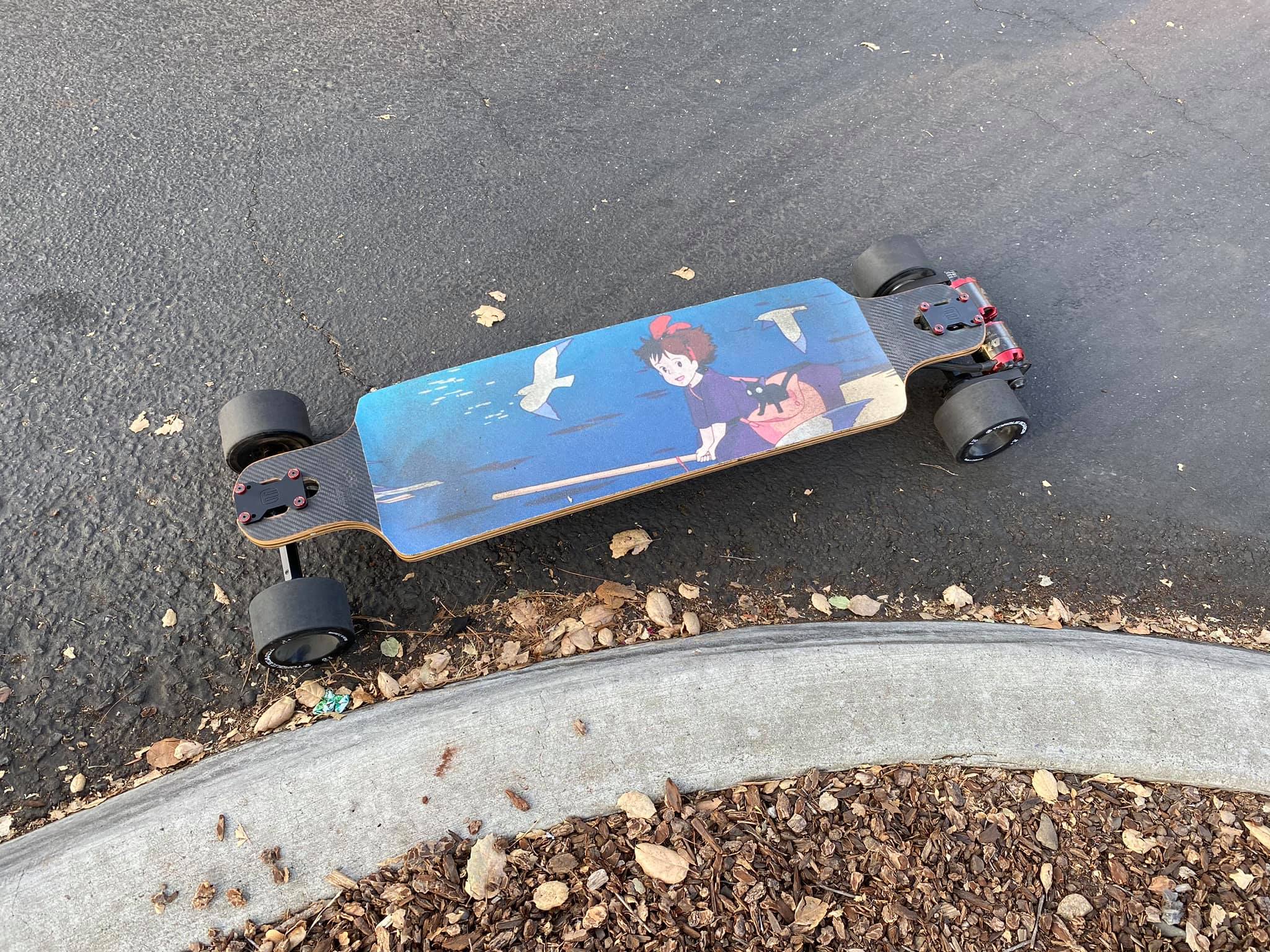

Yo, this is like a brother to that anime board I made for my friend! Dope!
Too bad its been parted out and mostly sold already :man_shrugging:

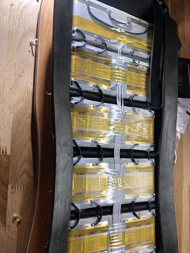

So above I posted about my big gap, a 3MM gasket seemed to do it but I was not certain of it was enough still so I got one a bit bigger, 4.75 mm (Alan suggested 3 or 4 mm and 4.75 is what I found after the 3).
Now it seems I have plenty of room.
With the extra space I was thinking about putting the 3Mm gasket on top of the battery to assure an air gap, I noticed my kaly has Somthing like this. So do I stick with the 3MM or give it some breathing room and make sure the battery and board are not touching by putting the smaller gasket on top of the battery.
Sorry if these are silly questions first build jitters.
Thanks!
You certainly can put the extra gasket on if you want, but keep in mind that if there is an air gap between your board and your battery, and you fill it with gasket, then your gasket may be pressing down on your battery and balance wires.
So just watch out for pressure causing abrasion where you dont want it.
Good point! Maybe I’ll put a few small pieces in the center where it would most likely touch

Made it out of this

Currently pushing the Sportster on the 43 degree plates in drop through and it handles like a dream. It is definitely going to be a challenge to minimize the size of the gasket needed. With no gasket, the clearance looks almost acceptable for the type of roads that I would run 85mm wheels on but I am not sure if it would scrape on hard turns. I think the Paris plates give you a little more ground clearance compared to Cal II baseplates.
What wheels did you wind up sticking with on your Sportser. I have a feeling that the 105mm hollow wheels could be pretty great fit once they finally become available.
