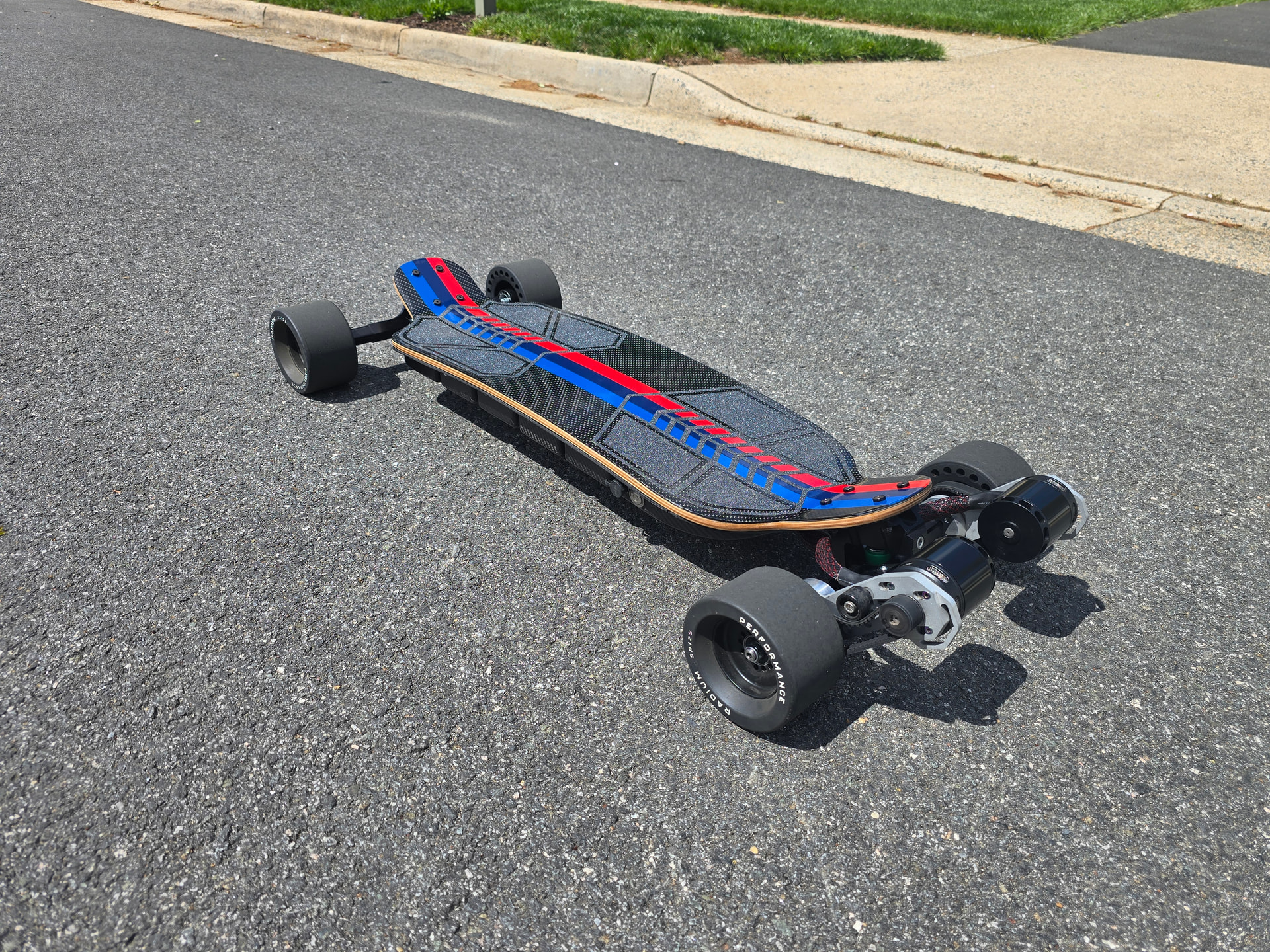

What do you think of the wide tires compared to 9s?

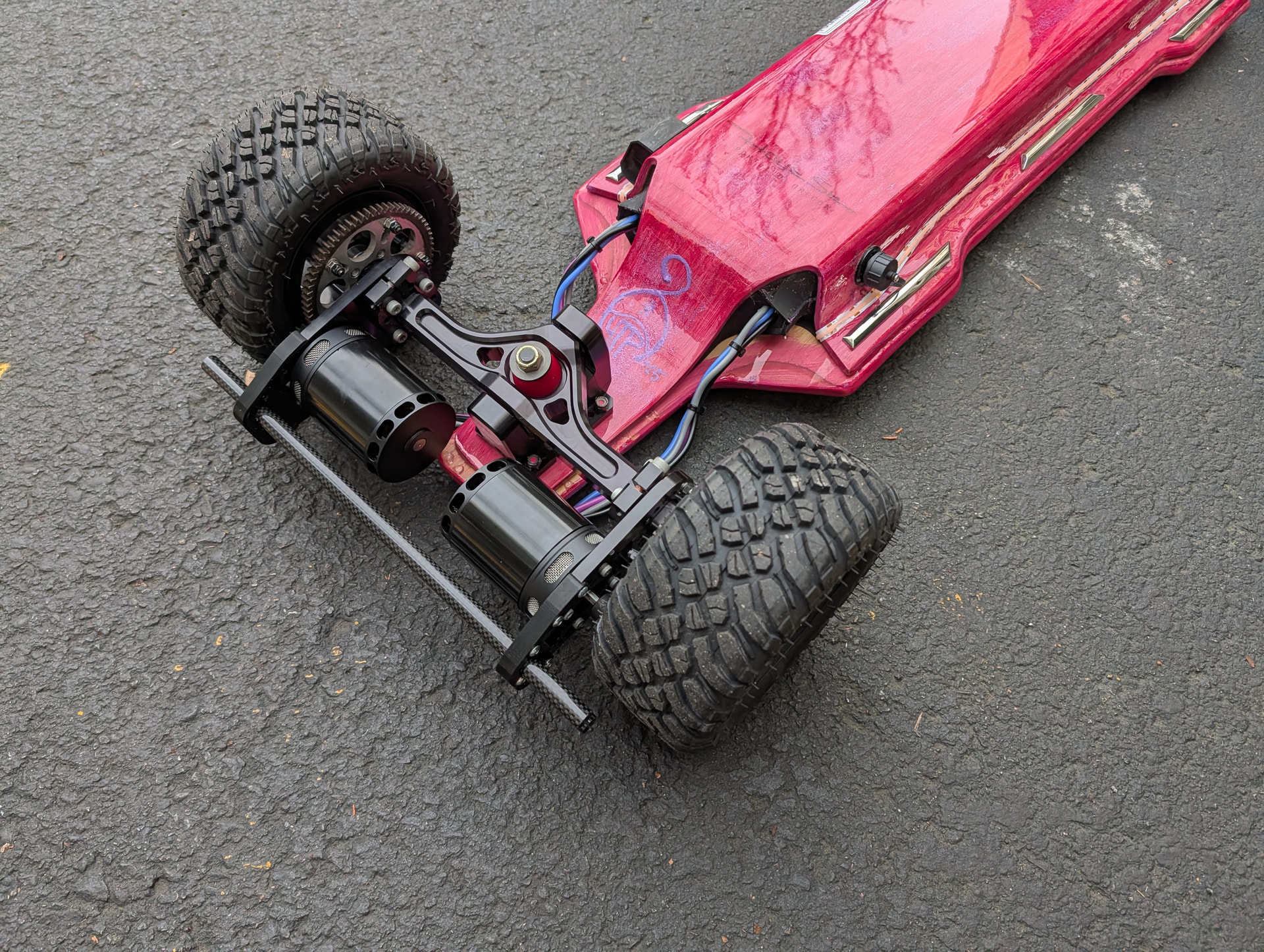

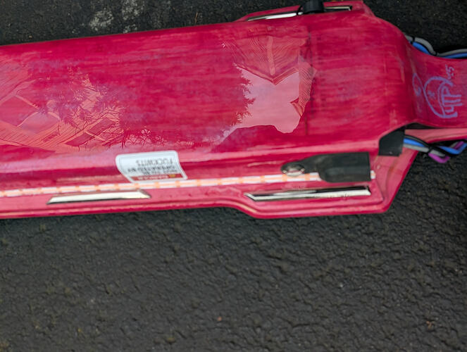

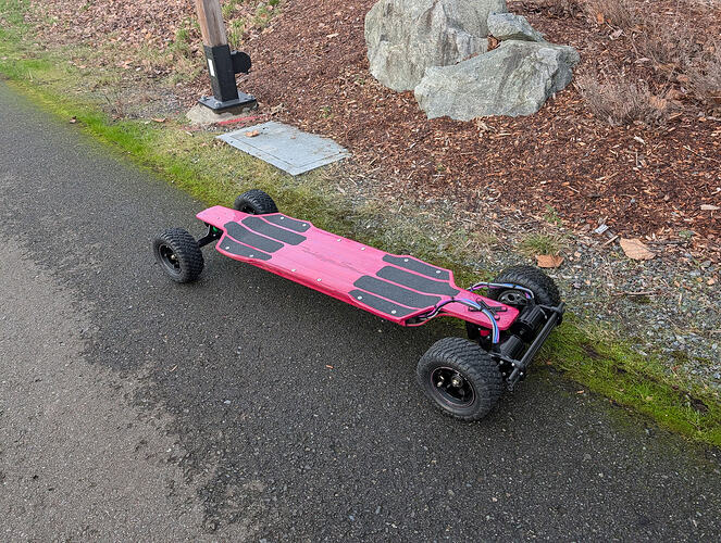

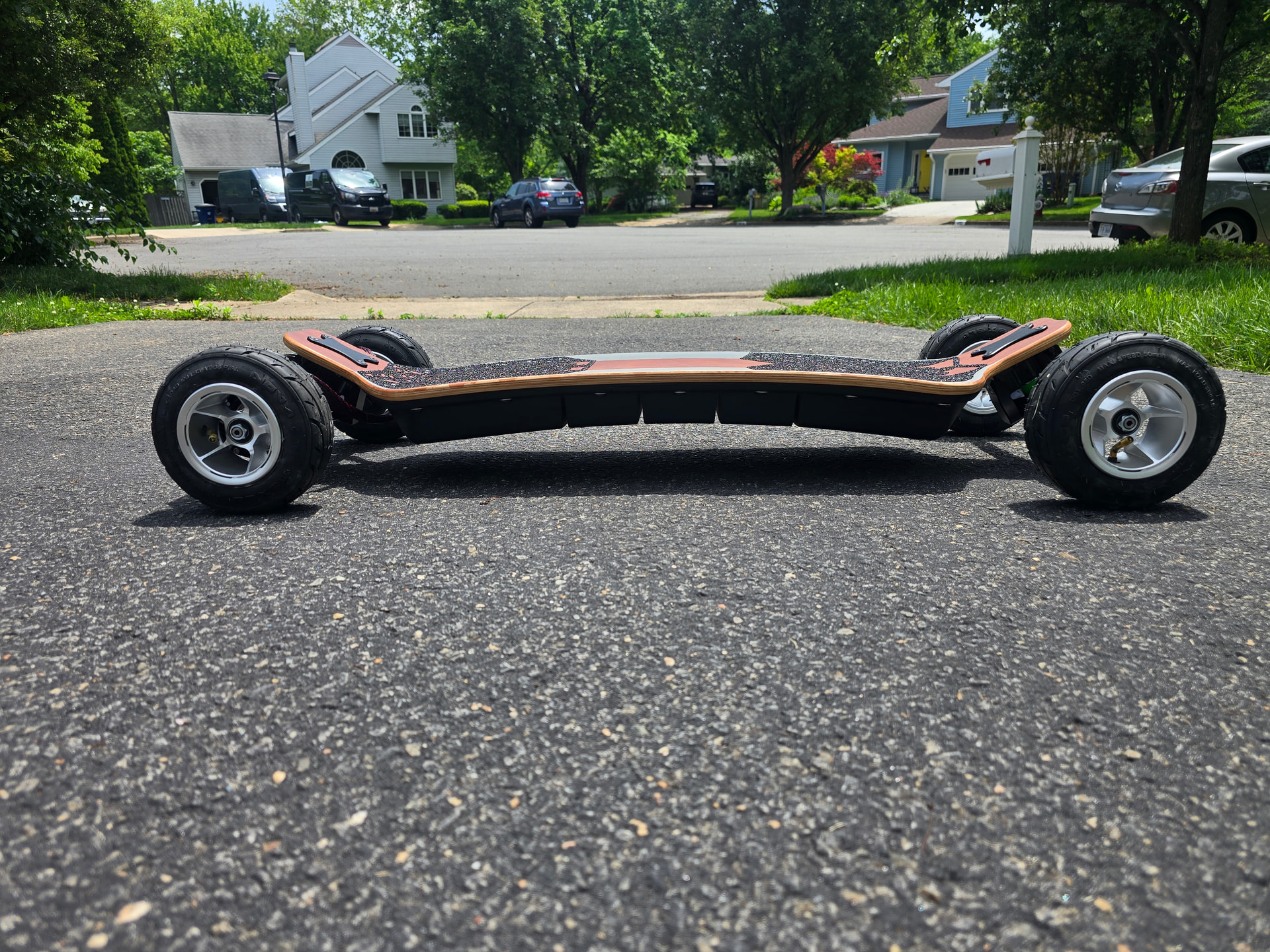

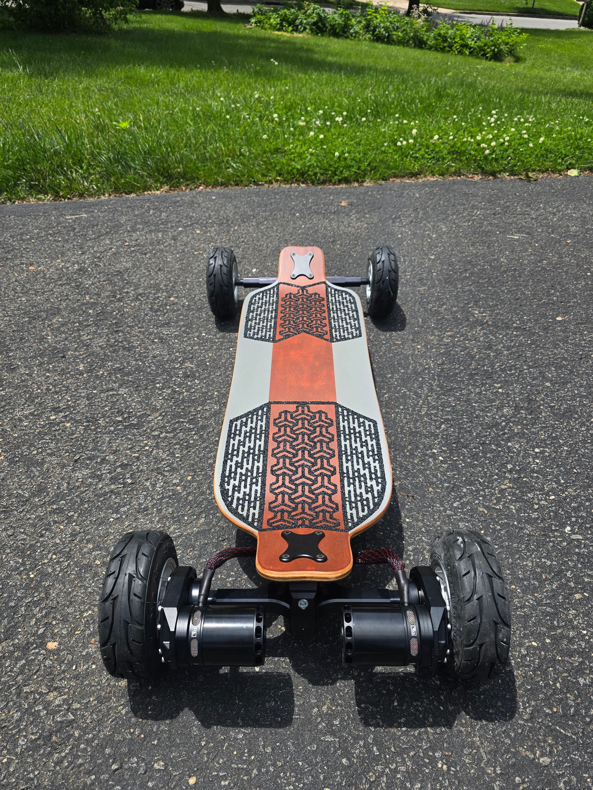

Wowwwww can’t believe I hadn’t seen this build thread before today, am I seeing that right, you did a whole custom deck based on the one from Raph? That’s kick ass!!
Ahhhh it’s so pretty, the finish you got on the bottom deck looks sooooo good
I’ll count it if you promise to get this sweet ride back up and running :grin:

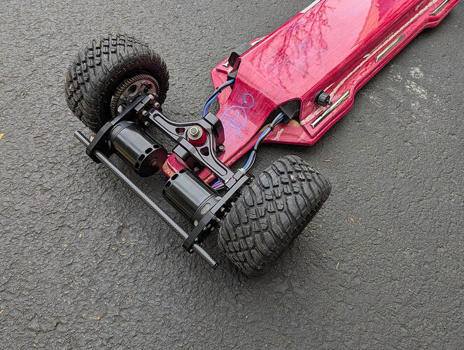

I’d nominate “The Phoenix” from @Esk8Cave
The aluminum reinforcement chassis and the way the trucks got dropped through to reduce ride height is impressive work

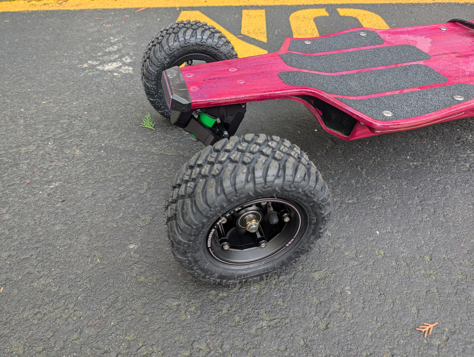

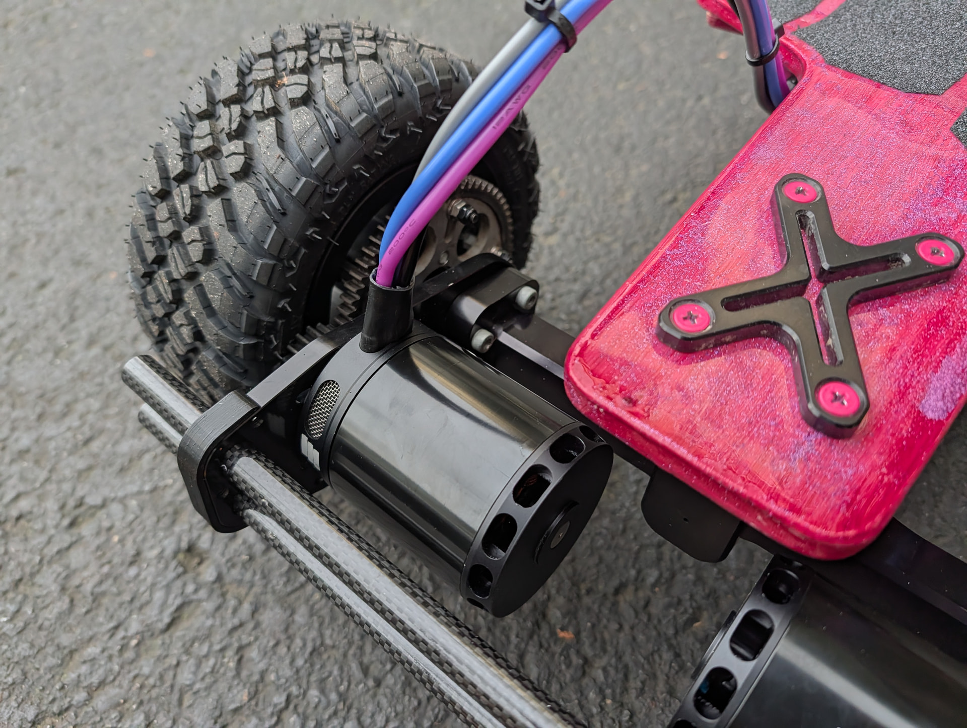

They were awesome. I like the harder compound, really fun to slide around on. Unfortunately the ground clearance wasn’t quite enough for a lot of our spots so went back to 9”. I just threw some mudpluggers on so hopefully they’ll be the best of both worlds.
A new deck is already on the way. With luck I might have it finished before the BOTY deadline (doubt it), depends on when the deck gets here. But the plan is to get it done ASAP so I can get used to it before esk8con.

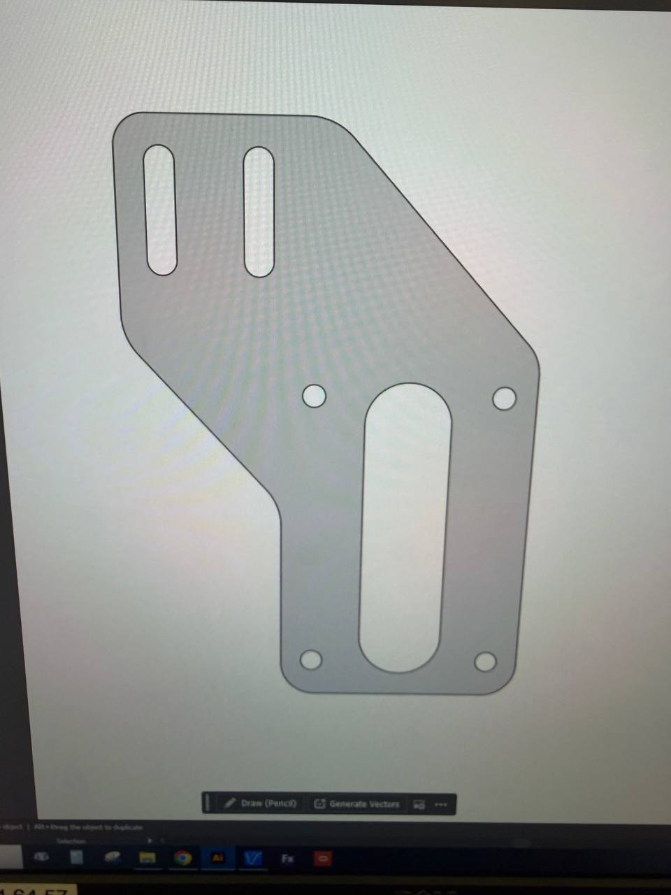

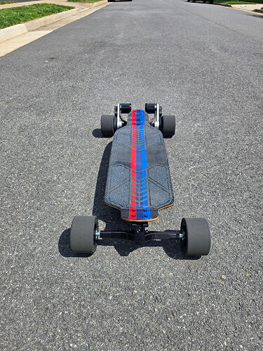

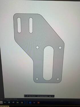

What is your plan for bindings?
At first I was planning to run Tomiboi straps on the rear with @AlexB extender. But @Pecos suggested doing an extended baseplate instead, this way I’d still be able to use MBS bindings. Something like this.
This way I’d still able to run the bindings where I want without drilling holes where the deck transition.

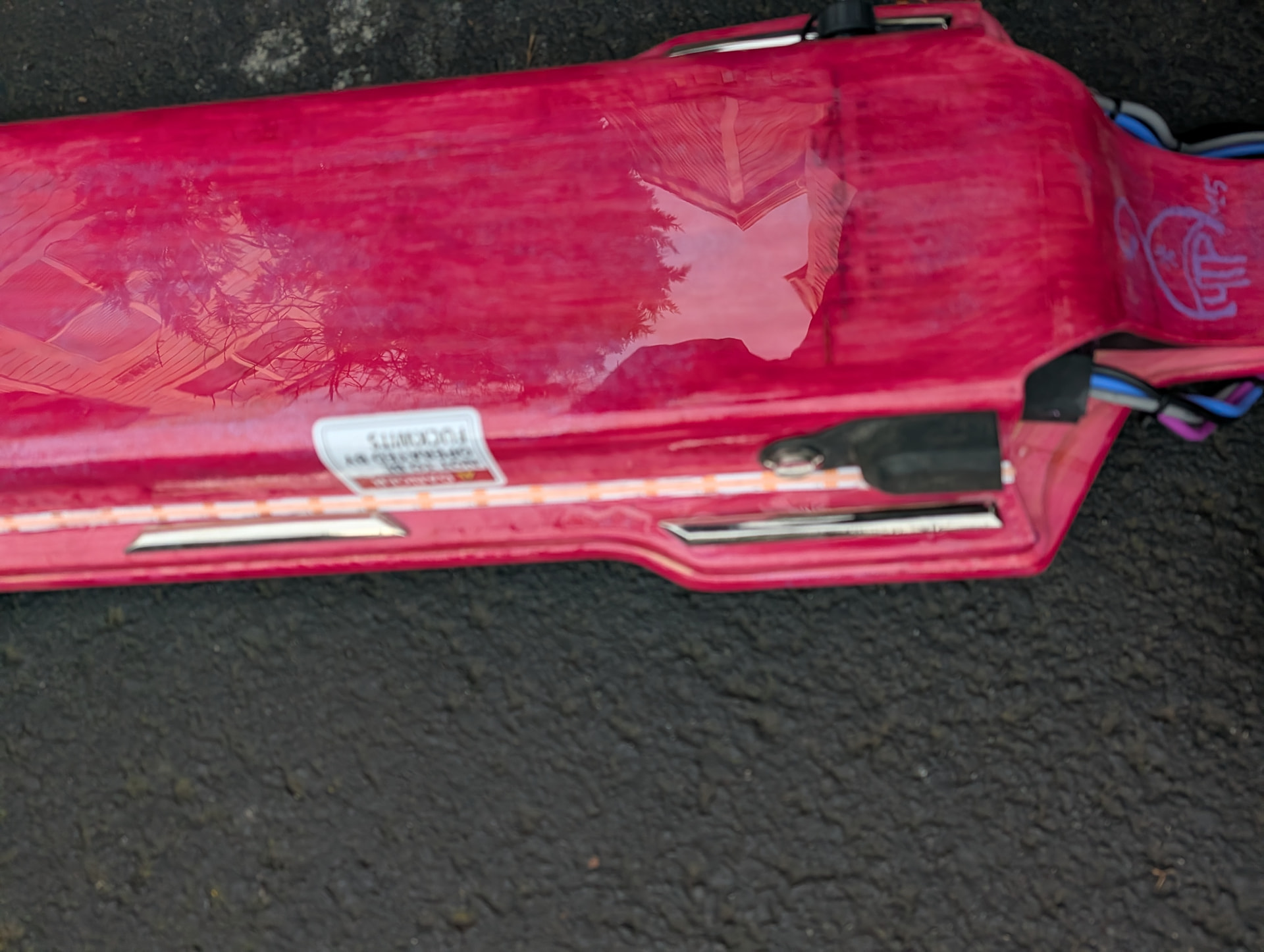

Yea it was more hidden on the forums :joy: and yea somehow it worked with using the deck as a mold to create a whole new one, concave and everything was dead on, I was surely impressed once I got it glued up and cut out. Definitely took the whole ‘DIY’ to a whole new level lol

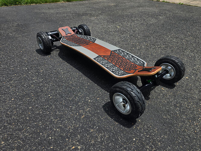

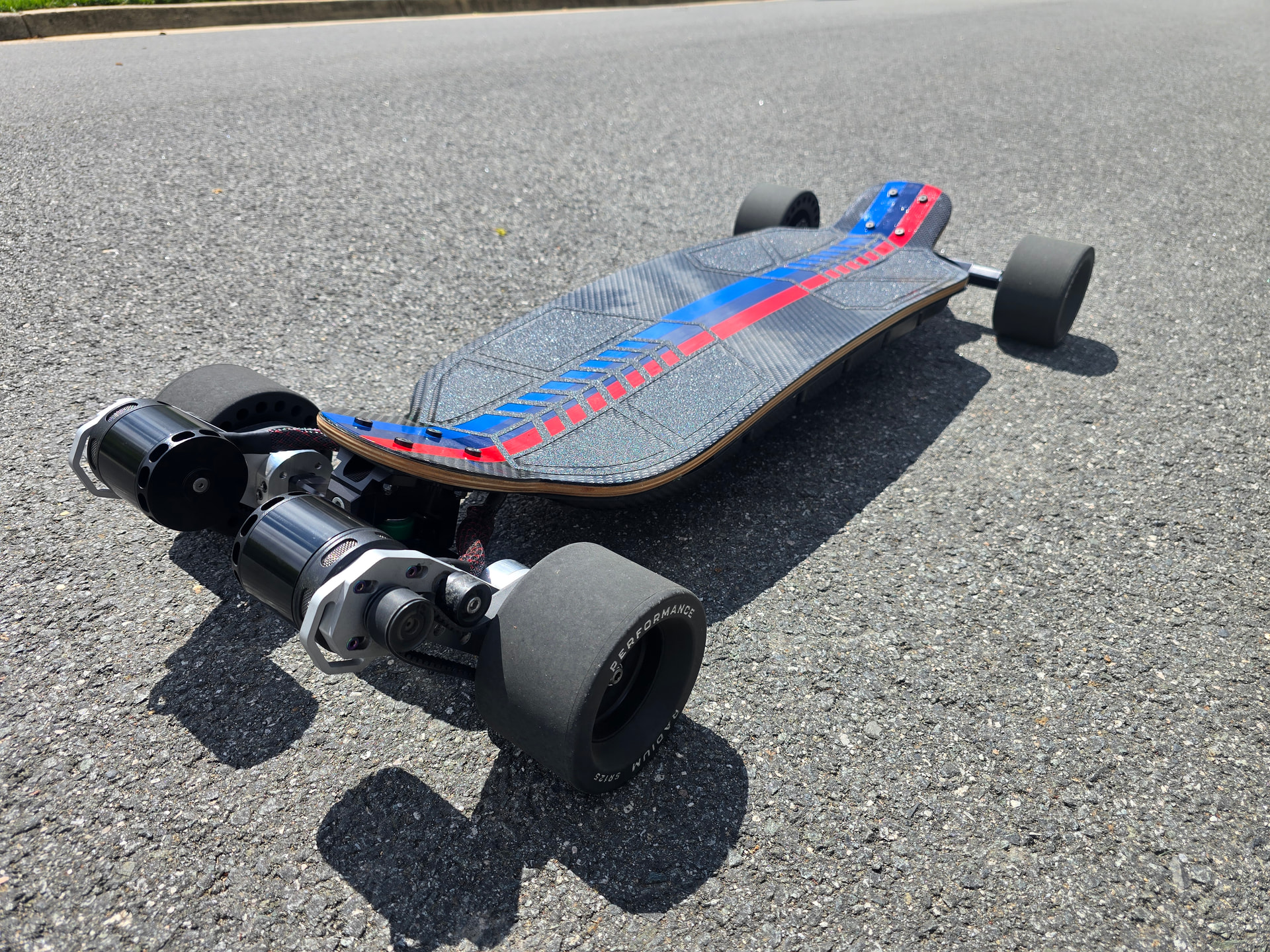

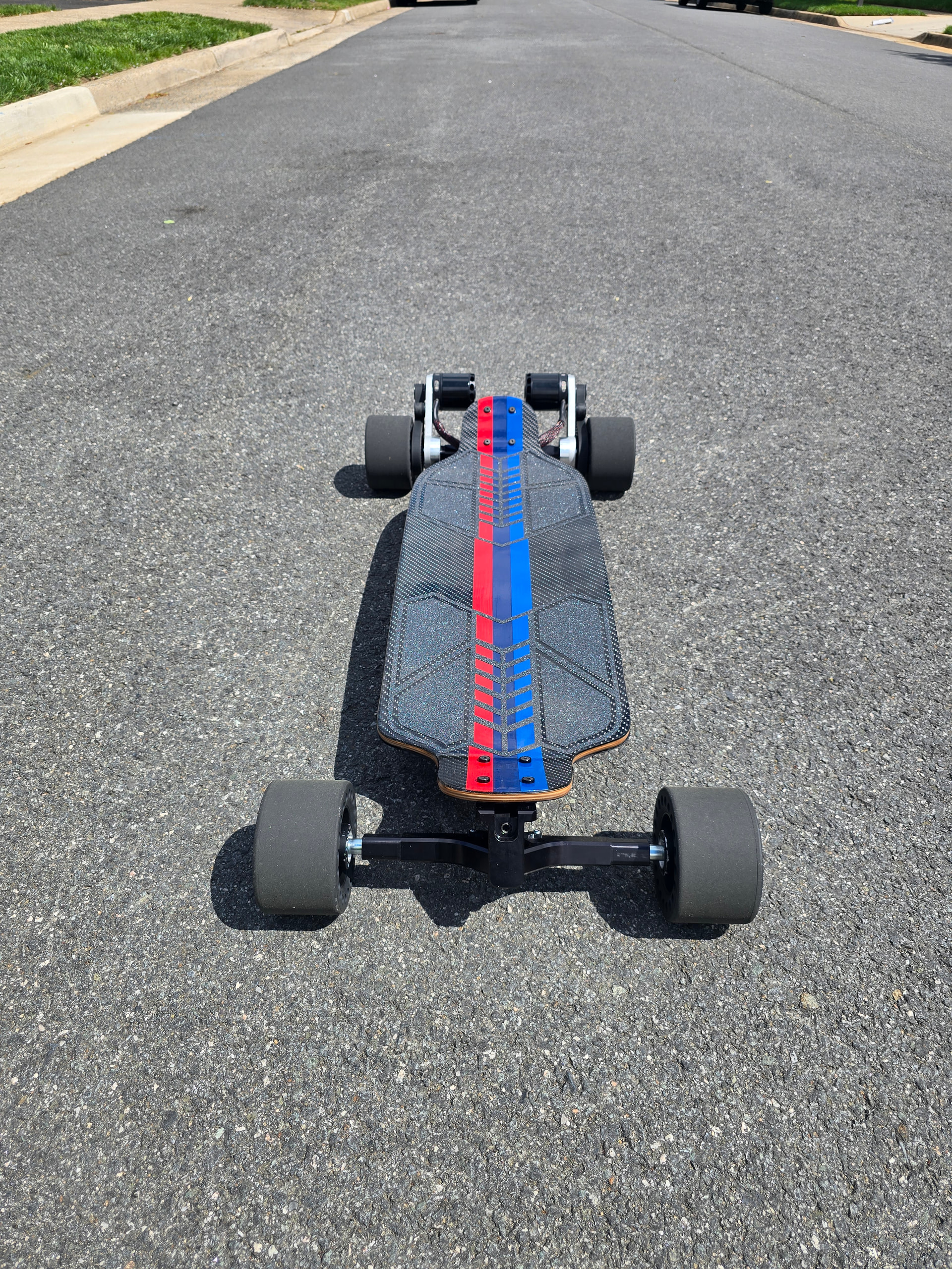

I would like to nominate The Kicker 2 from @vap because the deck is awesome and the elrs remote is really impressive :cowboy_hat_face:
I also really love this build. Especially the deck
