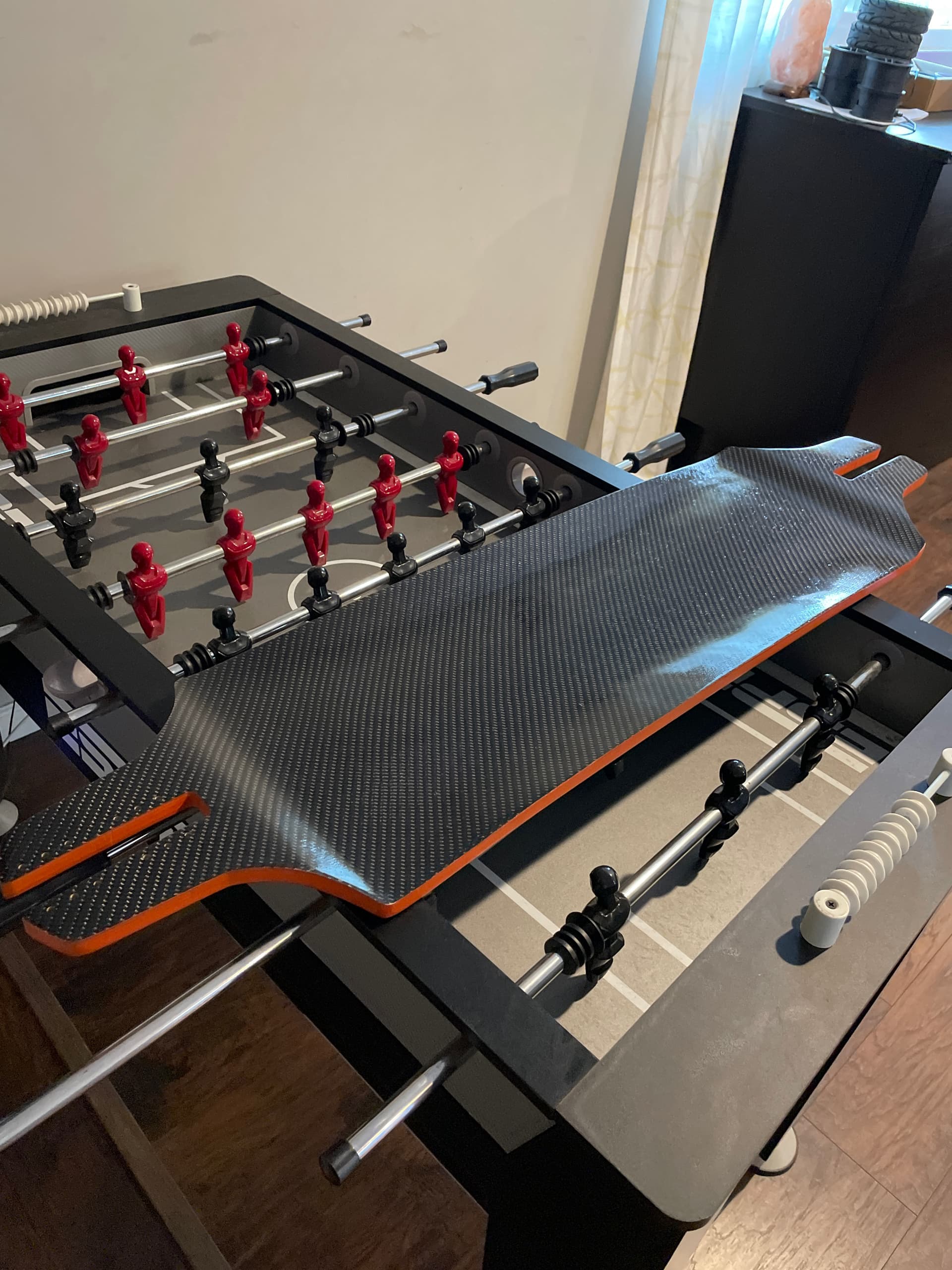

Wowzers. The addiction is real! Two years in Esk8 already and onto my fourth board. Exway Flex, Ownbard Zeus, Stooge V5 and now Tomiboi Odachi, the Zeus was really doing the job for me until I built a race board. Since then noticed the lack of power and desire for more speed on the cruiser board. My second diy, first one done solely on my own.
Goals for this build:
-better performance
-big range, ride to and from group rides, maybe join faster longer EUC rides (Also have some super ambitious skate packing trips)
-fast charging 40A capable (3 hours sitting in a parking lot charging on a trip gets old quick, especially if more than one charge needed in a day) ** I understand fast charging results in faster battery degradation, would be used sparingly even though 40A into a 10p group is less than 1C charge rate. Plan to regularly charge to 4.1v per cell and charge at much more conservative current…
Parts Breakdown:
Tomiboi Odachi V2 20mm drop
240mm Tito Duality Trucks
6485 173kv Reacher motors
My own BAK 45D 16s10p battery build
D100
GB lite remote (appears to be lost in mail). Will use flipsky vx4 pro in the meantime
175mm Mboard nova tires on Tomiboi hubba-hubs
67t/18t SRB open gear drives
Daly BMS 40A

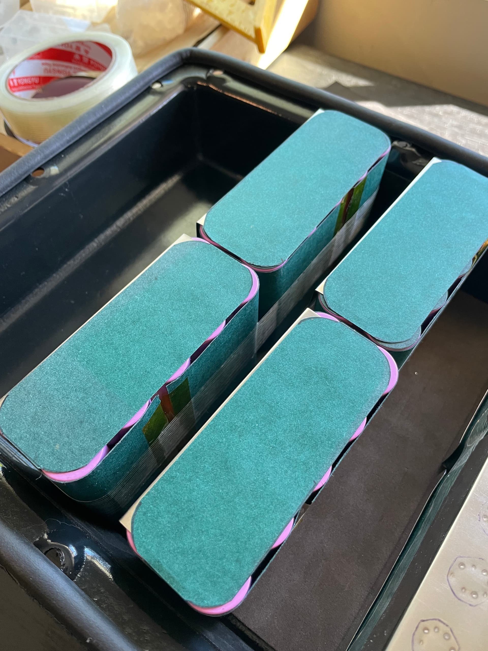

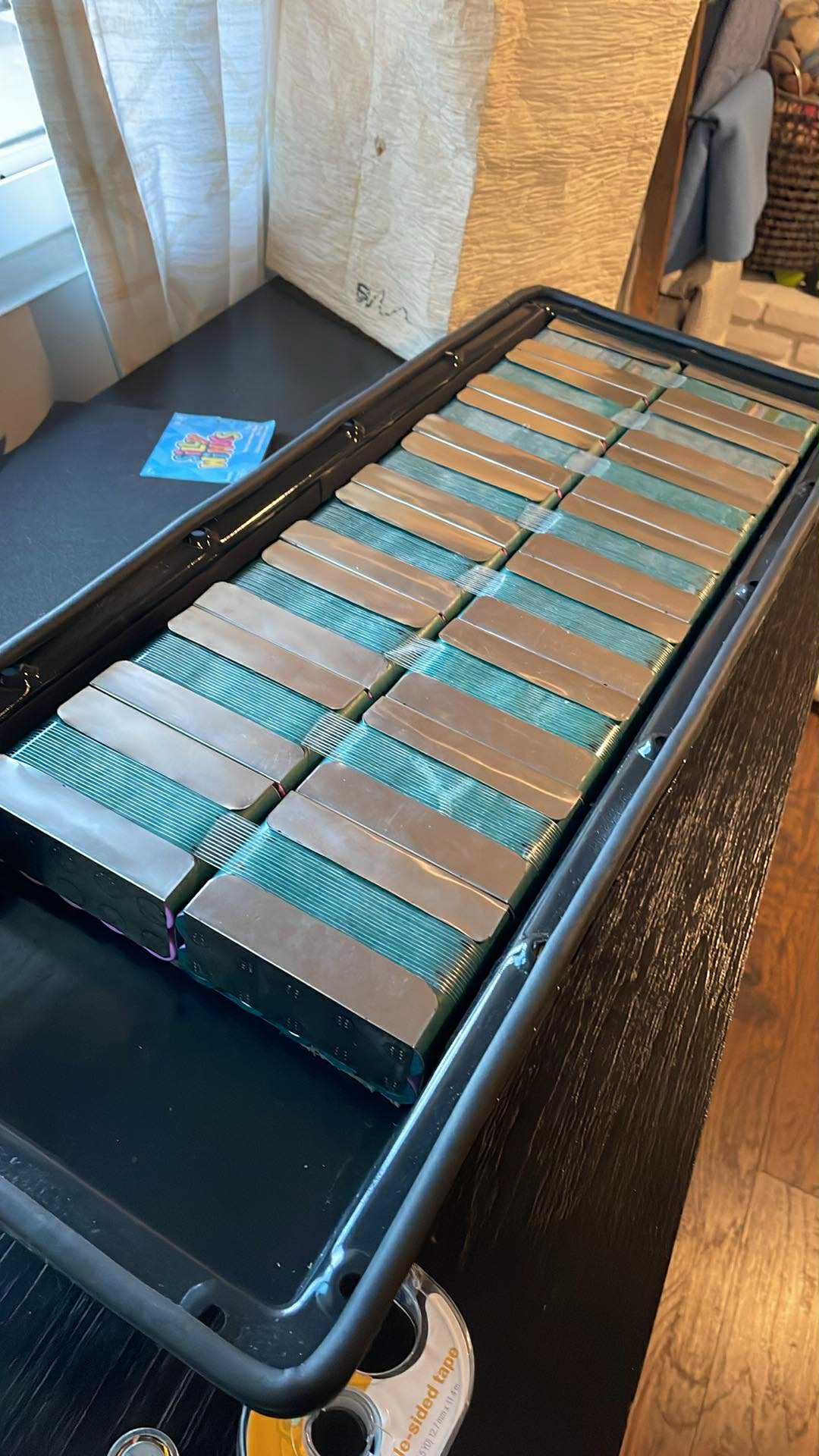

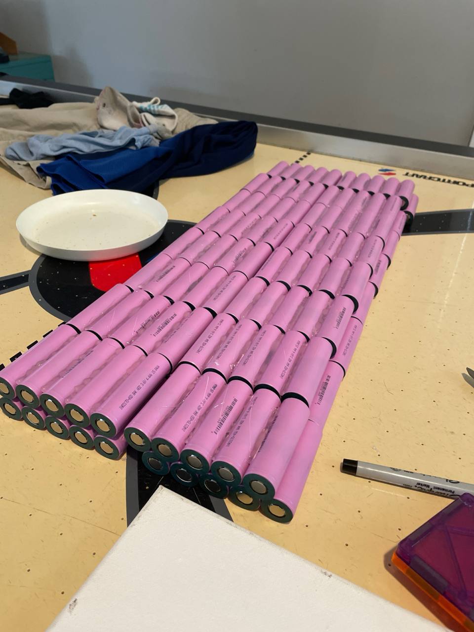

Battery Build
16S10P BAK 45D
That’s a whole lot of cells! Quick back of the napkin math the p groups are so large that the cells shouldn’t be stressed hard at all. 75 battery amps per side for 150A total battery amps / 10p group is 15A draw per cell. I can pull that battery current on my raceboard and probably won’t be pushing this board that hard. Peace of mind.
All ready for series connections, which I’ll wait for esc and heatsink to arrive first to make sure clearances are good.
Plan on using 4 12AWG wires per series connection. Unsure if I’ll use 8 or 10AWG for battery main + and - yet.

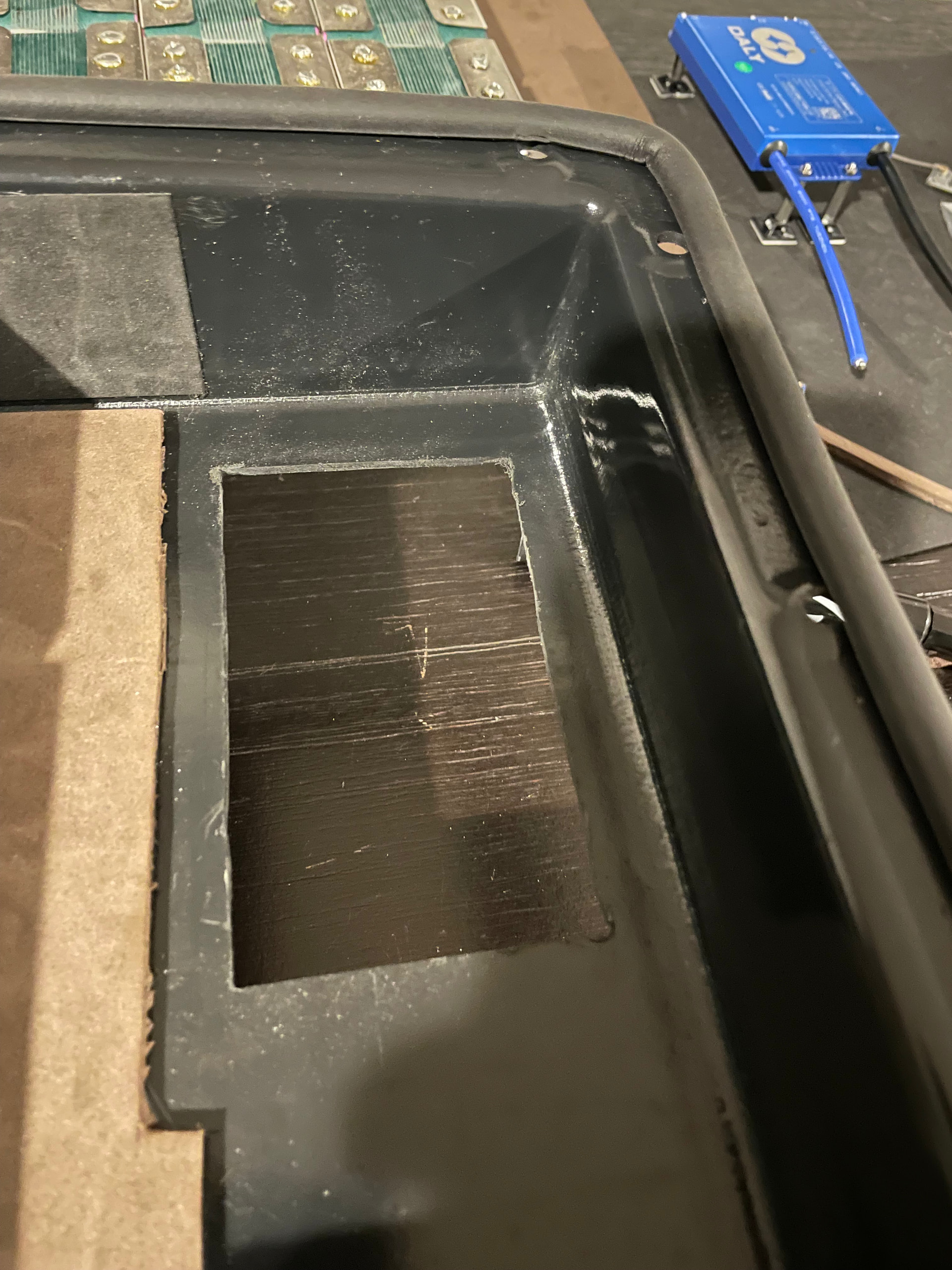

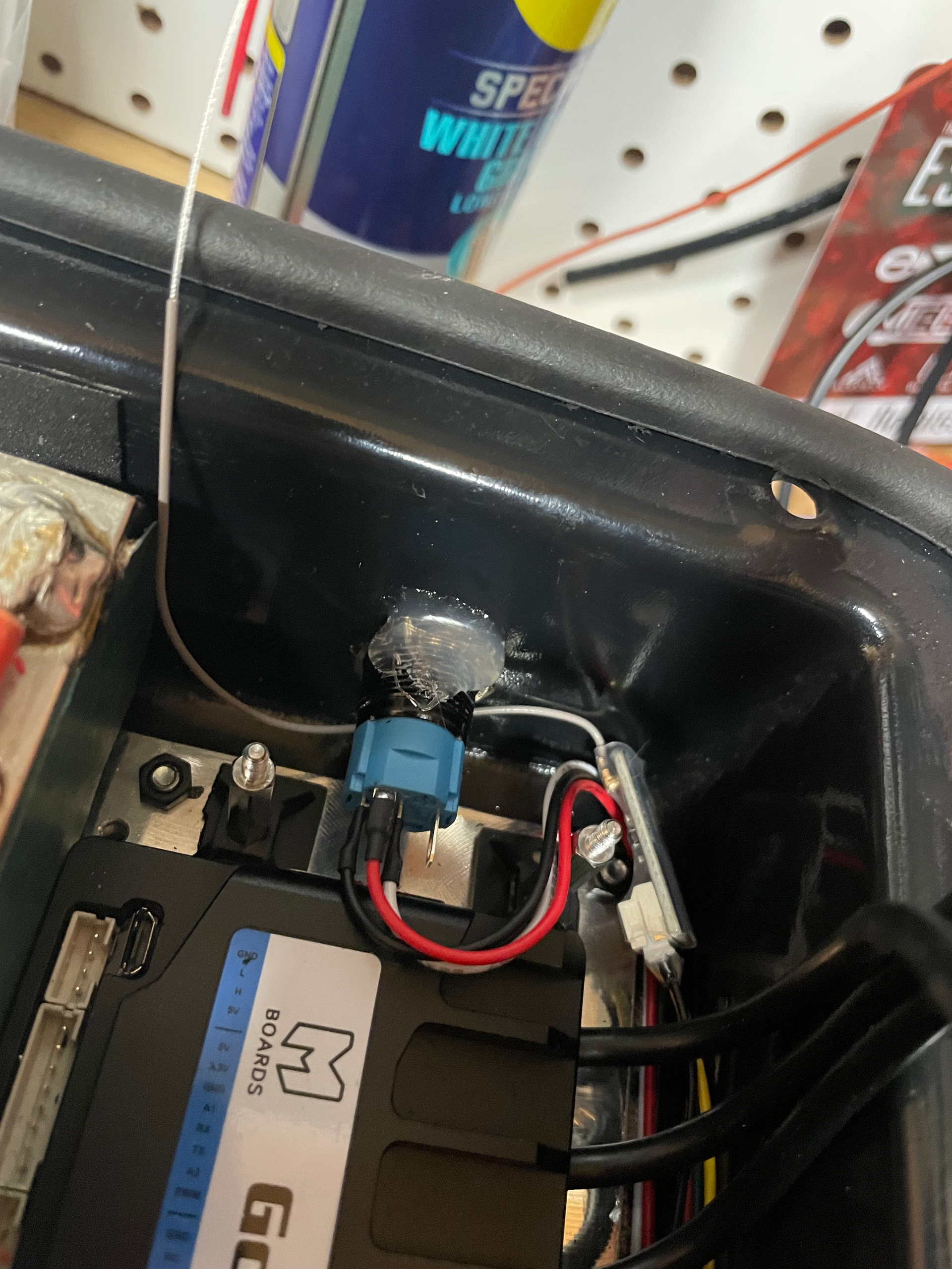

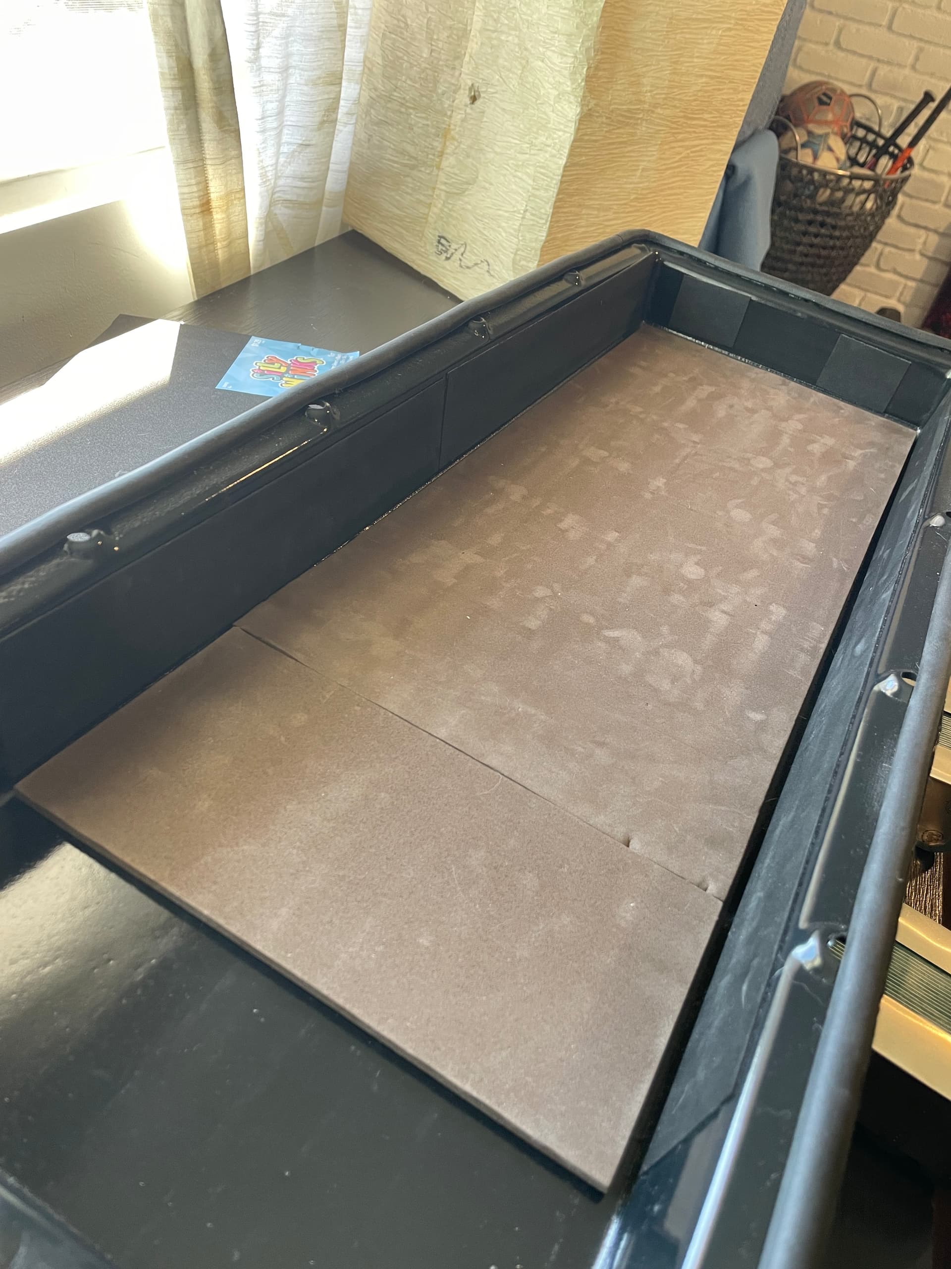

Makerx d100 on back order with mboard. Hopefully have in coming weeks. Will need to cut heatsink hole into enclosure. Will be focusing on clean cable management and strain relief.

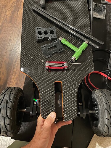

Testing wheel clearances, motor mounts on backward, oops.

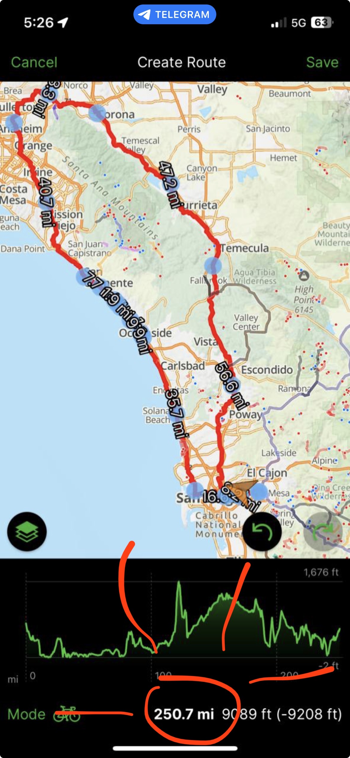

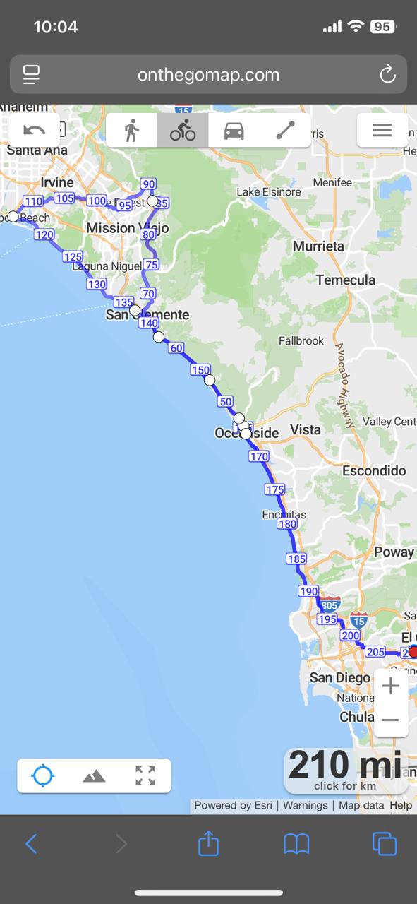

There’s something super intimate about traveling on Esk8. I use the ev car charger adapter since stations are plentiful.

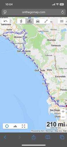

Here’s two of my ideas. Riding up the coast is pretty nice.
It sure is. So much room for activities! Really hoping I can squeeze esc inside, will be tight fit. Trying to avoid rear top esc box if I can.
In one day?? Best I’ve done is 117mi in a day.
Super stoked for you wow !
These have been overnight, maybe 60 mile days.

Damn bro I can’t believe that enclosure works with what looks like 6” wheels. Get it!

Starting with 175mm novas. Haven’t truly tested ride height yet. Hoping enclosure doesn’t scrape. Will try removing 5’ from rear if so. Or going higher duro bushings.

Completion of battery

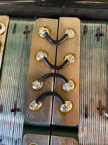

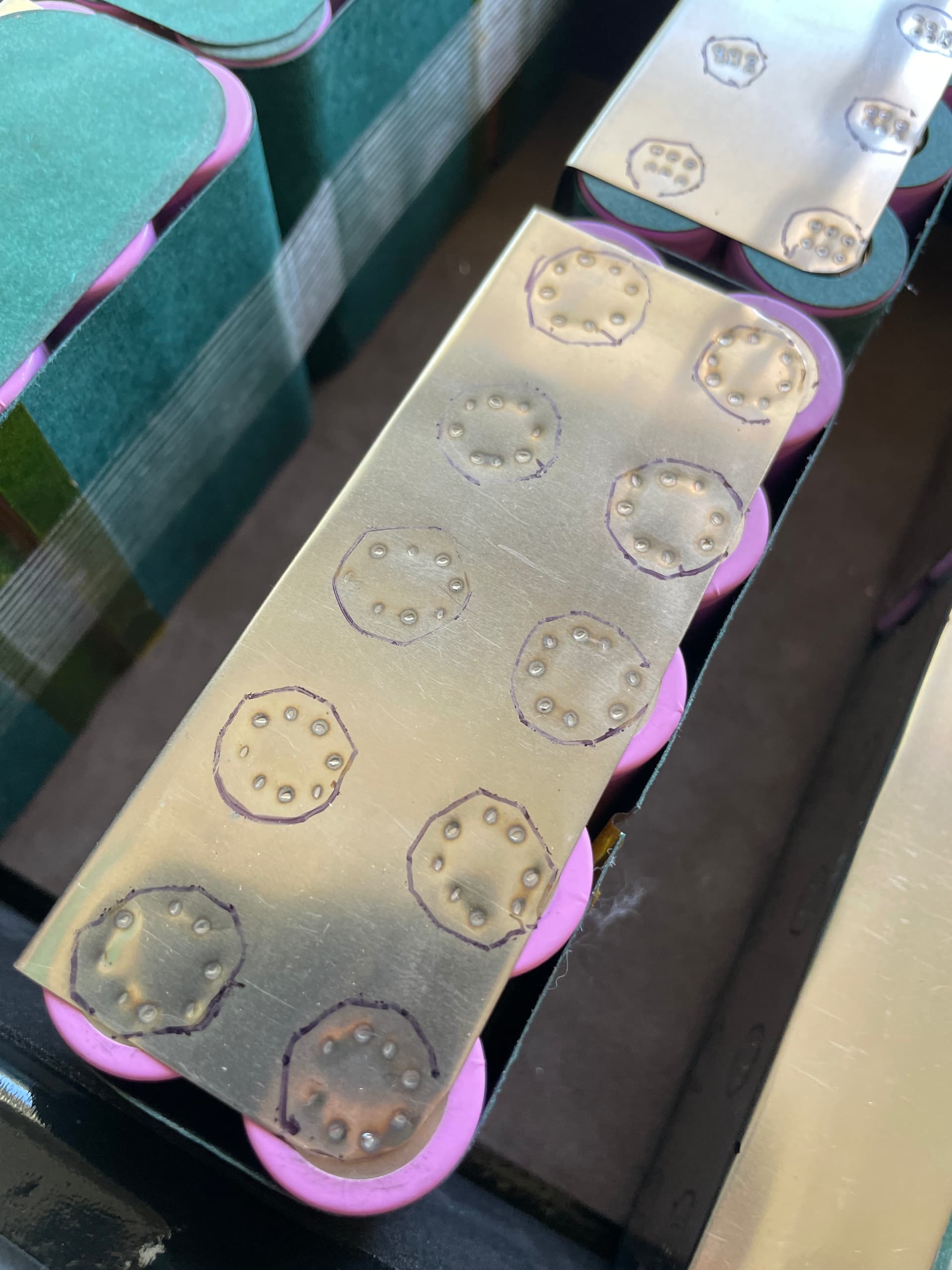

I will say I’m hesitant to share pics of battery as it’s not perfect. Had made the series connection between group 7 and 8 with 12 gauge before the rest and was decently happy with how they turned out so chose to leave. Initially wanted to do 12 gauge series connections but was struggling getting enough heat to solder, without having it wick up the wire losing the wires flexibility. After doing about half the series connections with 12 gauge thinking it was “good enough” I deemed the solder had wicked too far up each side and made wire to stiff. Looking for reliability in this board I chose to re do them. Moving to 14 gauge made all the difference and was able to get good solder joints and kept the wires flexible.

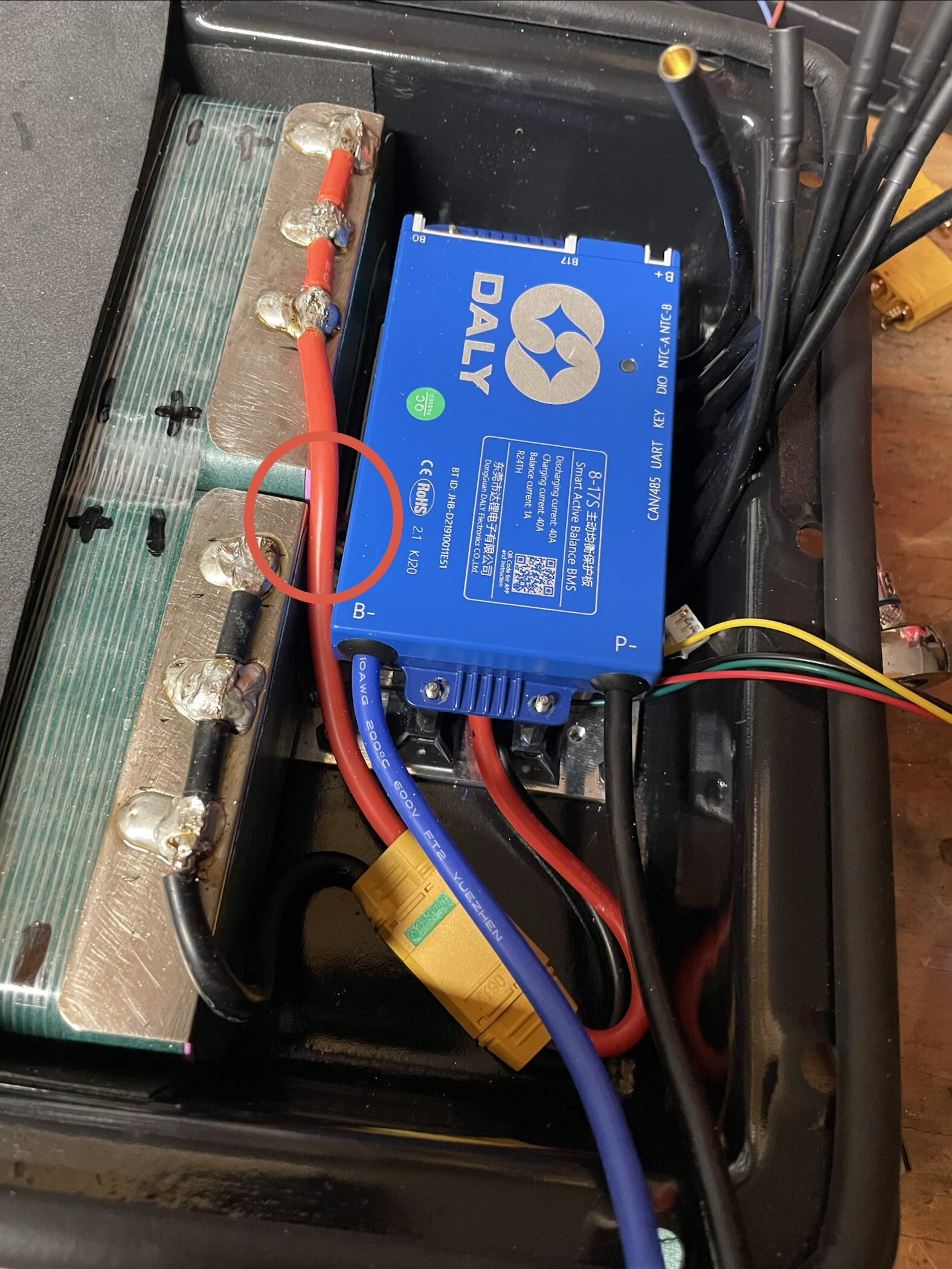

Wiring electronics went smooth enough just took some planning to get everything into the small ish space especially with all the xt90.
Electronics
I recognize the area circled in red is area of concern with the battery positive intersecting past negative terminal. I insulated the area well enough after photo was taken where they should never touch.
No photos of completed bms wiring or charge port :man_shrugging:.

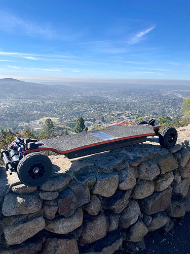

All in all the board really rips! It’s my first esk8 that’s deck width fits my feet completely without toes or heels hanging off. The length of the standing area I can actually ride at a normal stance for my 6’2” height. Can’t say that about my V5 wish it had a tiny bit more standing room.
The combination of the extremely comfortable @tomiboi Tomoboi Odachi V2deck with the @Titoxd1000 Duality 240mm are truly a magical feeling. I will also say coming from an under powered Ownboard Zeus Pro I was always slipping belts no matter how much tension I had them setup with. These 67t open gear spurs are so dreamy and feel very performance driven. It’s the performance I’m used to on my SRB V5 but having the strong braking and no belt slippage in the streets is extremely confidence inspiring. My casual speed runs got me 44mph so far and I can tell stability won’t be an issue as I grow into this board and its capabilities.

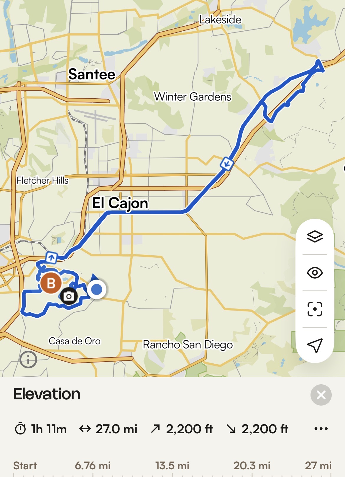

My first real ride finding this board’s limitations.
27miles pretty aggressive riding 65 wh/mi efficiency
Average speed 27mph top speed that ride 43mph. Was monitoring motor thermals briefly got to 70 ‘C
Started at 4.1v per cell can’t recall what I came back at but vesc tool said 44% battery left. I’ll have to ride a bit more conservative on the longer trips I have planned.
Impressive build! Takes a certain rider to take advantage of that range for sure. Speed too, low 30s mph is where I cap myself out of self preservation haha. I used to live in SD before picking up Esk8 when I used to bike a lot. Now up in Irvine. Where do you plan to ride between Oceanside and San Clemente (the Camp Pendleton section)? The base used to issue passes for cyclists, but I don’t think they would for PEVs. I think one is allowed to ride on I-5 but the thought sketches me out.
