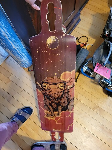

Broke my deck any recommendations?
I have a little bit of glassing know how but when it comes to properly re-enforcing a deck I could use some more info?
Are you just glassing over the whole board or what?
Yup, 2 layers on the bottom one on top is what I’d go for. Bottom is generally enough, but with kicktails or drops, you should hit the top, too.

This is the deck I have and I have been having some delaminating issues and minor cracks. And its not even an esk8. I reached out to the company and we will see how it goes.
Biaxel? Carbon fiber? vac bag?
Vac bag is preferable but not necessary. Cf is obviously stronger but conductive and blocks signal so it’s not the best for our purposes, I’d recommend using gf over it if you use it at all. The regular ol Bondo kit will strengthen it up just fine.

Careful with the Demonseed i had this exact same snap on mine a couple weeks ago. Just reordered one with rhe composite layer and am adding my own CF and FG on top and bottom to make sure this shit dont happen again. Also ordered a U drop mount bracket from riptide to hopefully help too
As you can see the real weak point here is the mounting holes for the trucks. Im gonna prolly just fill that in completely with shredded CF and resin since im not running drop thru.
Probably not. If you CF the bottom of the deck AND the enclosure, your signal will be fucked, though. Also, esc can be wherever, it’s the receiver that matters. I had a carbon fiber integrated deck for a while and it had a patch of gf on the lid which was the proper place to put the receiver on it.
But more importantly, if you CF the bottom of the deck, you need to make sure you coat it with at least a thick coat of epoxy, or a layer of glass fiber. Or, bare minimum, fish paper where the enclosure sits. You reeeeeally don’t want your electronics directly against CF, it’s a disaster waiting to happen.
