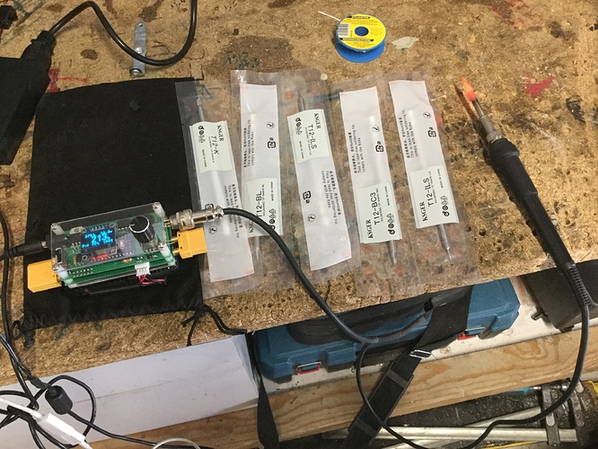

I tried soldering a couple different small 5V fans to this port, but neither worked. Are they just supposed to turn on when the unit turns on? Not sure what I’m doing wrong.
They work ONLY when the set temperature is reached. Also that port is only 5v.

Good morning, everyone,
I have a problem with my hump level, namely the regulation of the soldering iron which does not work anymore…after 100 degrees the breakdown becomes bright red…
Has this ever happened to you before?
Make sure the connector is plugged tight. Try to unplug and plug again firmly. That could be the cause
I’ve tried the technique, but it still doesn’t do anything about it. It is beyond a setting of 135 degrees that the iron failure becomes red … and I also hear when I set beyond 130 degrees a noise coming from the S2 a TICTICTICTICTIC… and the more I increase the temperature the more the noise is perceptible.
