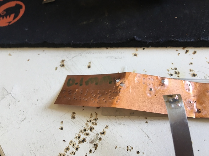

I am trying to weld 0.1mm copper to 0.15 nickel, using a 4s lipo pack (4x2s 60c rating).
I’ve experienced a problem which led me to replacing the tips which did not help. The problem was there before and after changing probes.
Basically I can make a good weld, but only on one probe…
One side is fused and the other is weak and not fused.
Any ideas? Thanks
I thought it was my 3s graphene, but the problem followed to this new, strong 4s pack.
One probe making better weld than the other is normal. Try to tweak flux time, gap between tips and pressure. Make sure lipo is fully charged.
What times are you using? X2?
First of all, find a hard surface.
A thick piece of aluminium is perfect as the strips don’t weld on it.
It is normal for this type of spot welding to get a larger weld nugget on the positive probe than the negative.
There are a few things you can do to combat that but first start with a hard surface.

I have increased bit by bit to 14ms for copper. I was using a piece of silicone underneath to stop blackening, maybe that is not a good surface.

Ok alan. I had some time and tested this for you:
As mr @taz said surface matters. You can test nickel on silicone but not copper. You will make a hole if the surface is not stiff. I used crystal.
1st I tested copper on steel and nickel on it.
Good results as usual
2nd I did copper on nickel. Not very good yet acceptable.
3rd nickel on copper. Very good.
As you can see the order matters. Copper on nickel makes weaker welds using the same settings (9ms X2)
Copper on copper sux. I said it several times. Not viable not even using tungsten points. At least I didn’t succeed so far.
Make sure the strips are flat and you make good pressure or you will make holes. Copper needs a lot of practice to master. It’s as easy as nickel once you figure it out.
Btw this is the first time I use that pen on copper. Not bad
