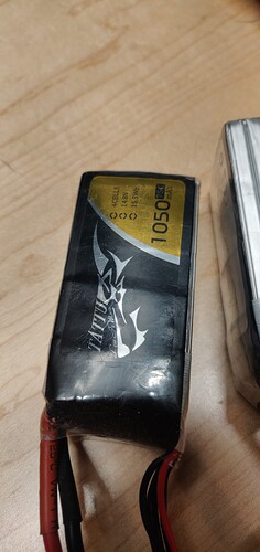

I cranked the welder into wild terrain and still the copper welds weren’t strong
I suspect both that the iron cells have a big voltage drop and also need more in parallel.
And almost ready for that test:
Before was using a graphene 3s and it does well and can get a weak copper welds using the insane setting u can see in the pic above.
I’m assuming those settings are not recommended but I’m also assuming the killer is current and heat and if it’s not even able to weld the copper and I’m keeping under the 50c limit it should be ok. ? So tempting to turn the push-button knob and keep going higher

TLDR: [WTB] [US] lipo for welder supply
I’m about to build a couple more packs with this welder! When I first used it I simply paralleled most of my 4s packs together and used that to power the welder but it still wasn’t as good as I was wanting. I’m now looking for the best ways to supply it and have tried making my own 3s out of large 8AH pouch cells, but it didn’t improve anything especially with the 0.2mm nickel I’ll be using. I’m thinking the suggested 5AH 130C rated nanotech might be the way to go but it’s quite pricey with shipping from overseas. Does anyone have one sitting around that they’re willing to sell that will 100% weld 0.2mm pure nickel? (I’d like too make sure it’s a battery supply issue before checking electronics)
Shorten and thicken your wires first.
Do you mean the battery wires? They’re only ~3" long, and the parallel connector is very tightly packed, I’ll take a picture when I get home.
