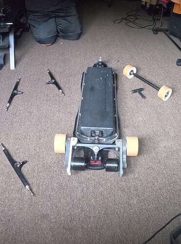

boardnamics trucks maybe failed.
I was wondering if this truck is cracked. I can’t tell . What do you guys think? It looks like a weak point because my other trucks looks the same way. The trucks is great, but it needs more metal meat. Revision maybe?
@Boardnamics what do you think?
It will fail soon, I can replace them.
Wow that’s actually like one of the first I’ve seen
Second one seen at least for me. Others did not crack just bent over time, see Steel hangers threads.
Now I got 4 Boardnamics trucks with the same issue. They all cracked at that area. So far, the axles and the hanger shape is good. In my opinion… That area is possible weak for my weight(280lbs). This is my feedback(if @Boardnamics decide to make a new revision). This is under a year. I’m going to buy it one more time. If it happens again. I might have to try a different company or make my own.
how much? do you have a steel version?
To be fair you’re putting over 300lbs static of load on ~300mm hangers with small urethane wheels, the newer version of the 270 hanger is a bit slimmer than the original (mine got ran over by a car and survived) so you might want to see if someone is selling a set from the first batches, or setup your board with a more forgiving configuration (bigger wheels or ditch the spacers, maybe shock absorbing riders)
In other words, I’m shit out of luck. Where I ride at is mostly city, so using big tires will decrease my range and cops will spot me quick. I dont know if I should buy a other one then. Also, I never saw the first batches. Is the hanger fatter? The material is steel?
Yeah kinda out of luck, I’d start with flipping the hangers so the crack is in compression and ditching the axle spacers, or I can sell you a set of gummies if you can live with the extra wheel diameter
Yeah they had a fatter neck but we’re still aluminum
@Boardnamics I brought new ones, but I hope you make steel hangers near the future. People like me that are not fat need stronger hangers. Seriously, 100% will buy it quick if you add that in your store. It’s my fault for going to the gym. lol

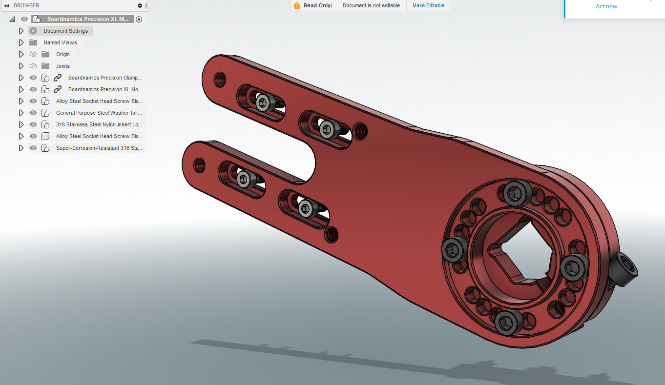

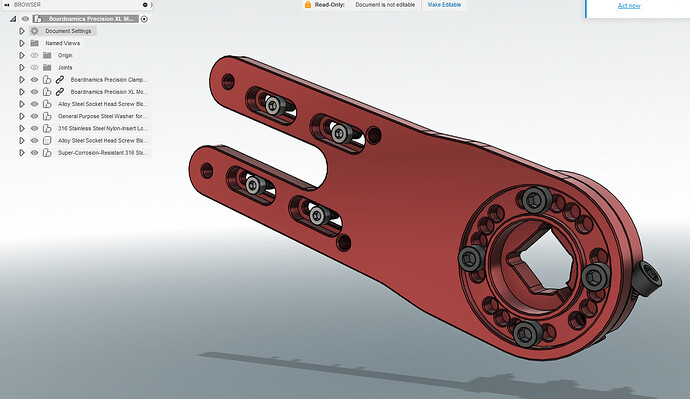

I rather support this dude, but if it happens again. I will 100% copy the trucks and cut it in steel. I rather wait until get the answer from @Boardnamics. Steel version needs to happen. So far, I only copy his motor mount because the product is great. I’m not joking, either.lol
