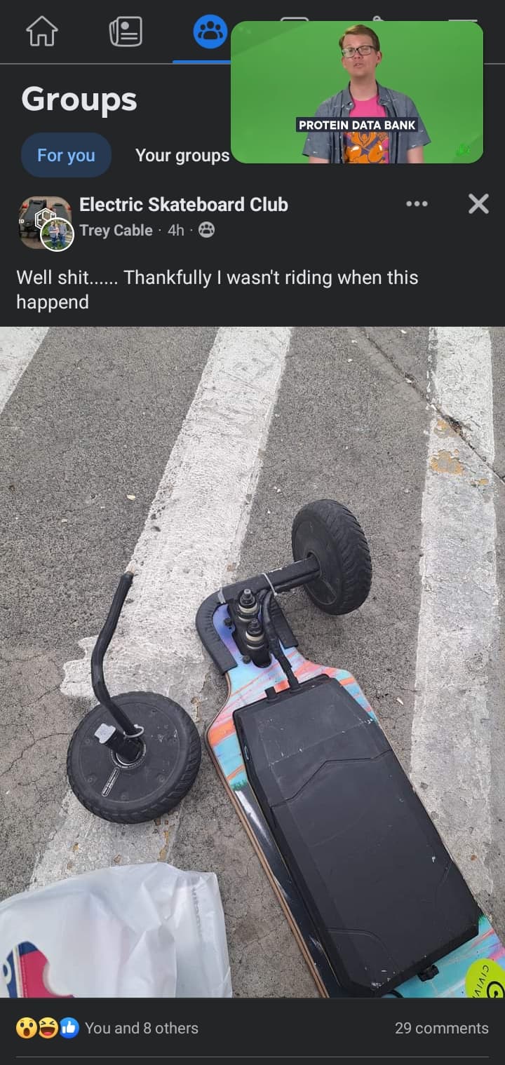

boardnamics trucks maybe failed.
To be honest, this hanger looks like is designed for steel only. That’s my vibe with it. Beside that, I will keeping it in the store, so the gearbox is still compatible. In the future, he should make two versions.
For example:
Heavy users/crazy riders is steel version. Add $50 to $70 for this service.
Light users/lightweight mode is aluminum version. Original price.
Done. This will be cool because he will be the first one in the market to do this. 100% I will buy it.
I’m still going to support Kevin for his nice work.
I’m curious to know how heavy is a steel 300mm hanger
Steel is around 3 x heavier for the same volume.
More than a kilogram
Guesstimated dimensions and drawn on a bus hence the shaky lines, but rough calcs without accounting for axels gives approx 900g so @rosco is pretty much right
It’s very heavy
900g is the same weight as my FPV drone. That’s light still.
Actual weight is closer to 800 g without axles and 900 with but yeah pretty close, they chunky
Aluminum with axles is 375 g each, axles are 48 g a pop, and steel to aluminum is 7.85 to 2.7
