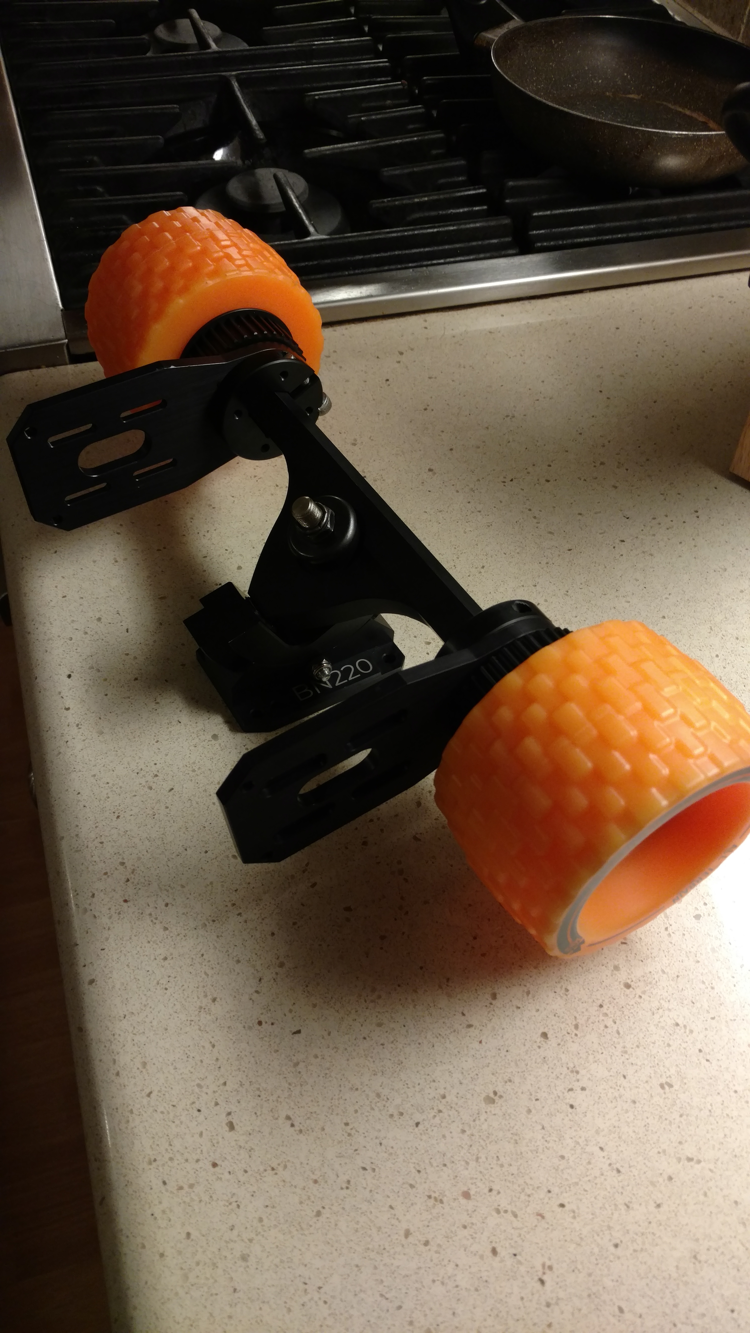

Did anyone try out these trucks with 3d serviasas geardrives?
Yes, I use them with 3dservisas nano gears, for e-caliber. To make them fit I had to file like 1-2mm of the hanger and sand the shoulder bolts a bit. You need to install the gear drives motor plate with the shoulder bolts screwed in and unscrew them for installment of the pulley, cover and wheel, otherwise it’s really hard to get the shoulder bolts in.
If you have the torqueboards compatible version of the gears, I think it’s a straight fit, on the initial thread Kugs mentioned that you need to file the torqueboards hanger to fit the e-caliber gear drive.

The sample pulleys fit! Tight press fit, mallet required. Not sure if I will loosen it up.
Some of the best pulleys I’ve used are just as tight on certain wheel cores (forward kegel)
And they work great
I’d leave them tight
