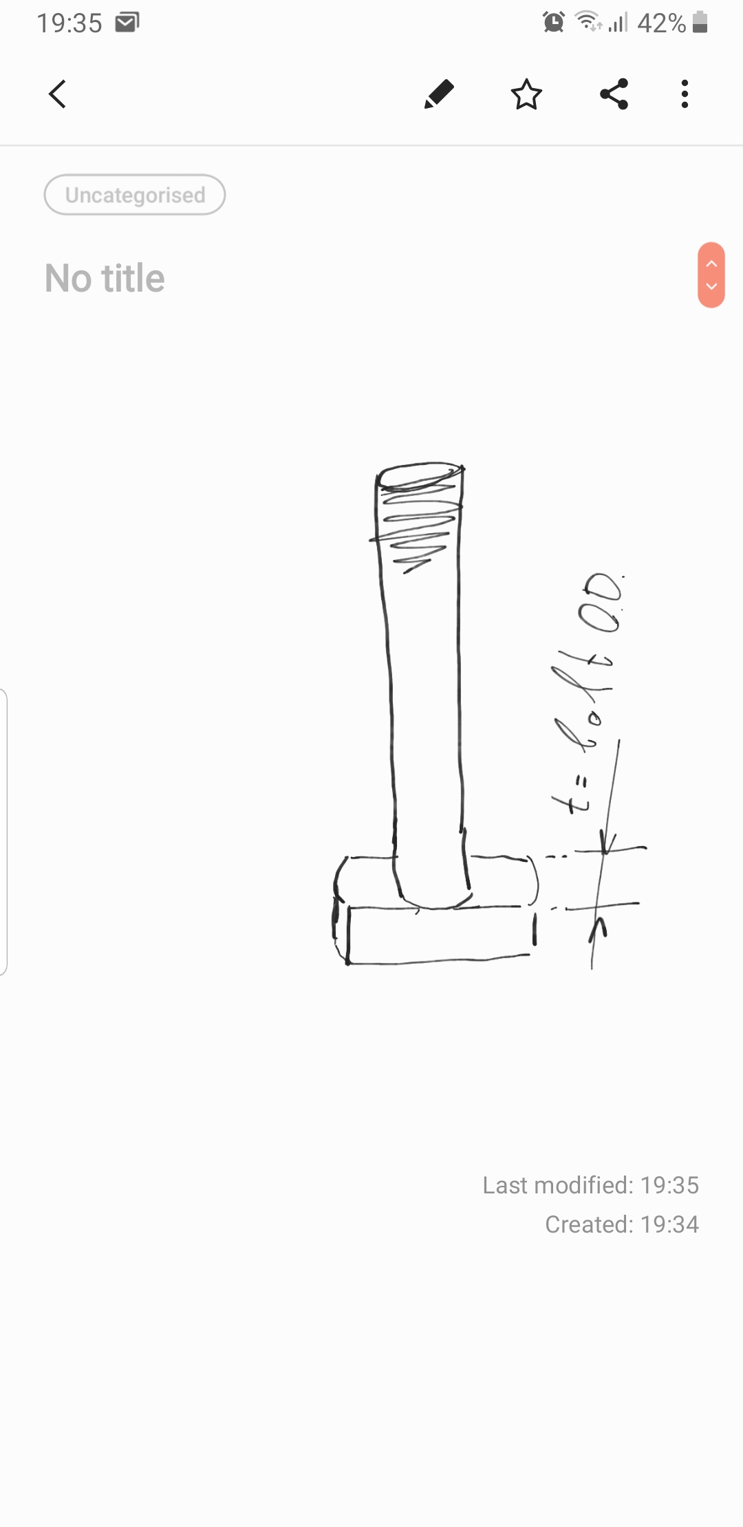

Well at least someone seems to have gotten the kingpin design in adjustable baseplates right. Well done sir.
Yep. Hardened nickel coated 3/8"-24 press fit inside. It ain’t going nooowhere. It was a pain in the ass to get it right.
I take it you pressed it in from the rear?
(Yes, I know what you creeps are thinking…)
Like this, with a smaller hole to let the air out
I would prefer a normal kingpin bolt with the sides machined down to its OD and pressed in from the rear. That way there are no chances of it ever coming out.
It would increase cost a bit though.
Do you really need to worry about those forces on the kingpin though?
Not that I know, but I would think most of it is side forces.
Cost is king, pin.
sorry didn’t realize it twas you who had just said it was done right
also 420th reply
You think correctly, hence my original post on how he did it right = no threads on the entry point to the baseplate
Brain not processing… Can you do a MS paint of this?
