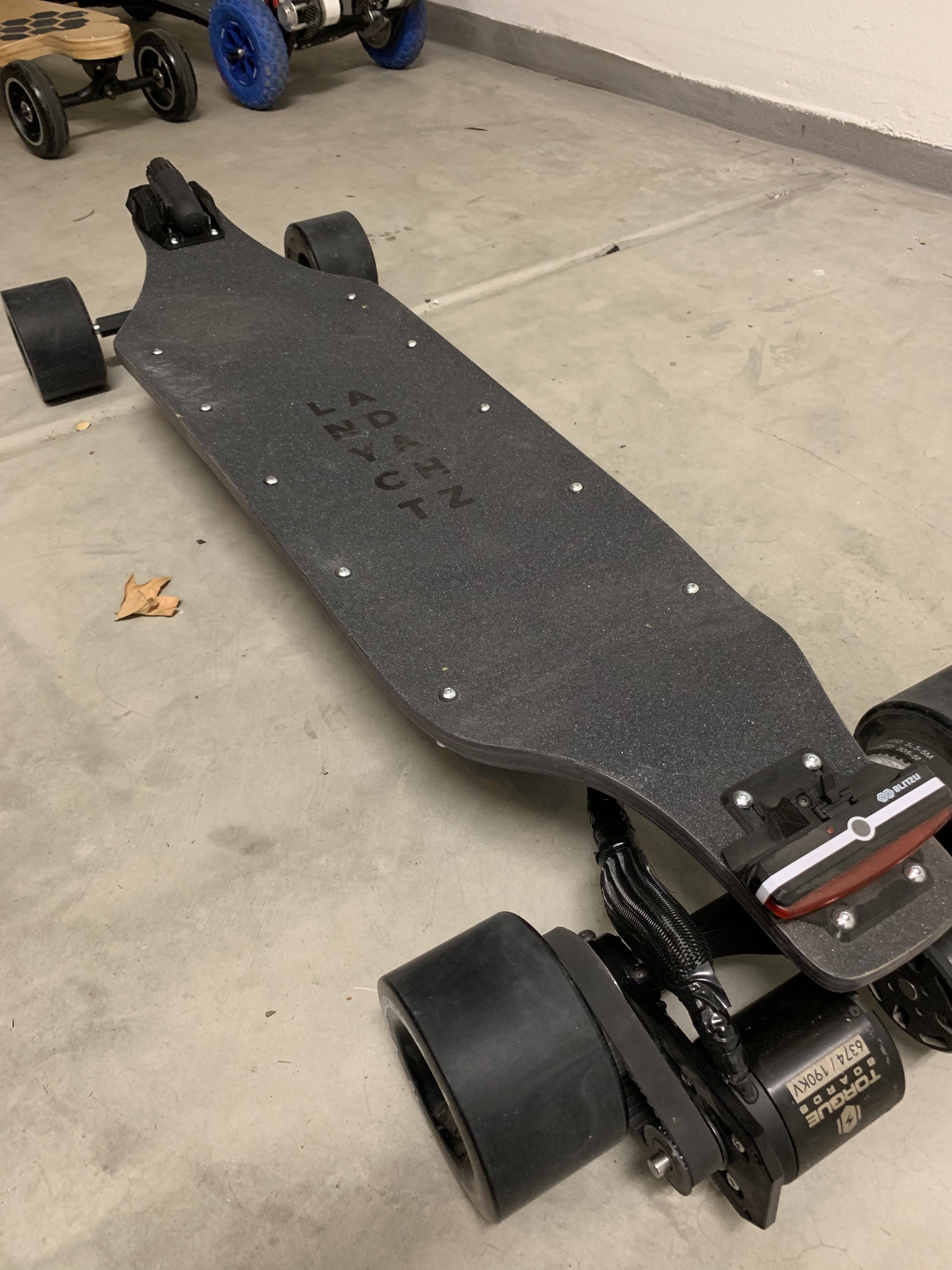

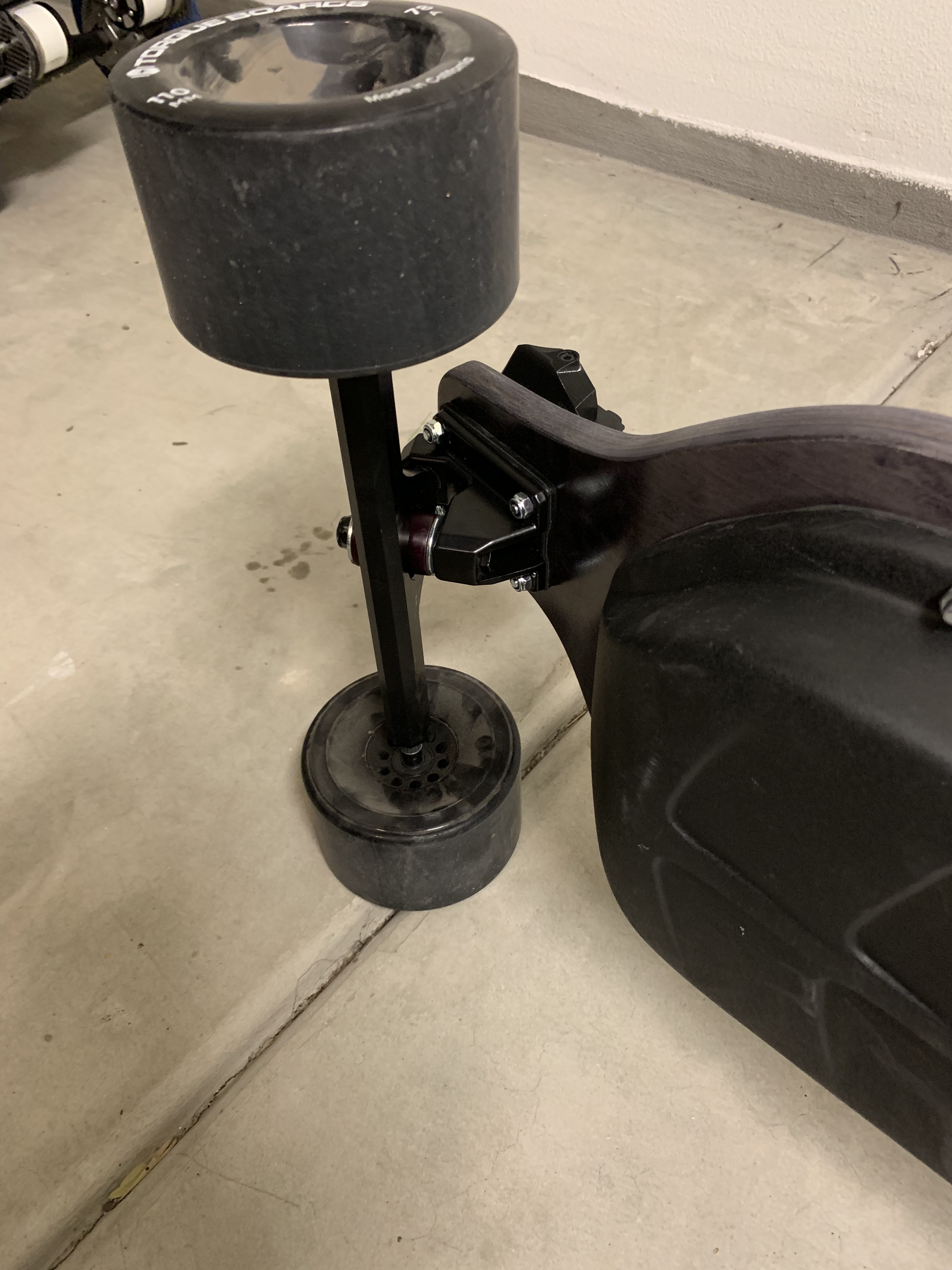

Absolutely. The axles are long enough to support any AT wheel, and the wheelbase is very wide for the needed clearance
Dual sk3 with plenty of room :heart_eyes::heart_eyes:

Spent the night finished installing. Nice work

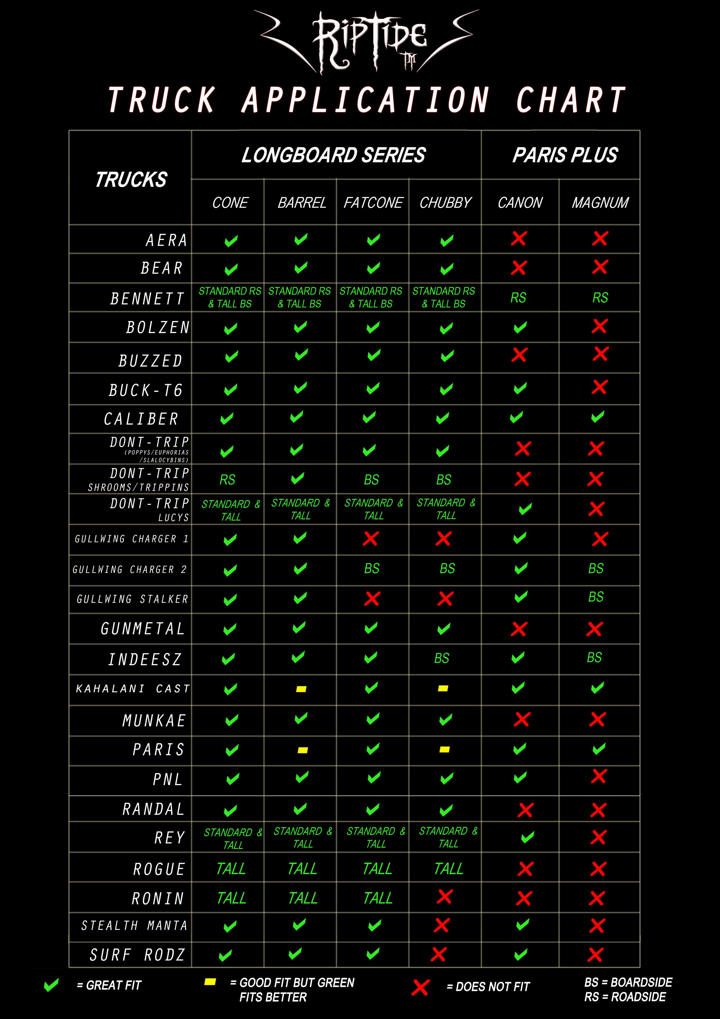

Yo @Boardnamics, what bushing sizes are recommended for these hangers? Are fatcones and magnums too big? :ok_hand::point_left:
I was wondering this as well, what are you running on yours?
Any barrel or cone will work. I personally run 2 barrels, 96a and 93a. When I sell the trucks, they will also include the same riptide barrel combo. Excellent stability but still carvable.
I assume the 96a would be boardside, 93a roadside? With a washer cup

Does this mean they have the same bushing compatibility of Caliber?
I would assume so. Its a clone hanger after all. Don’t think he messed with bushing seat geometry.

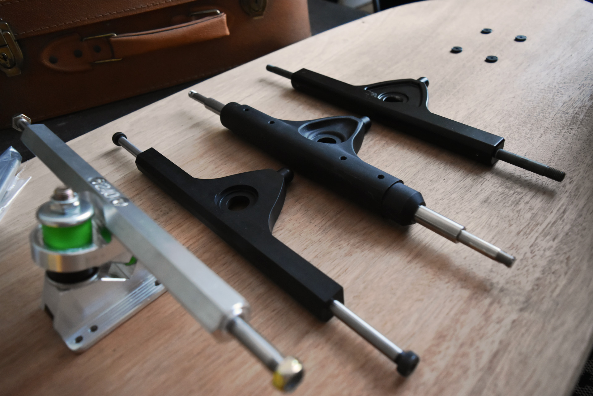

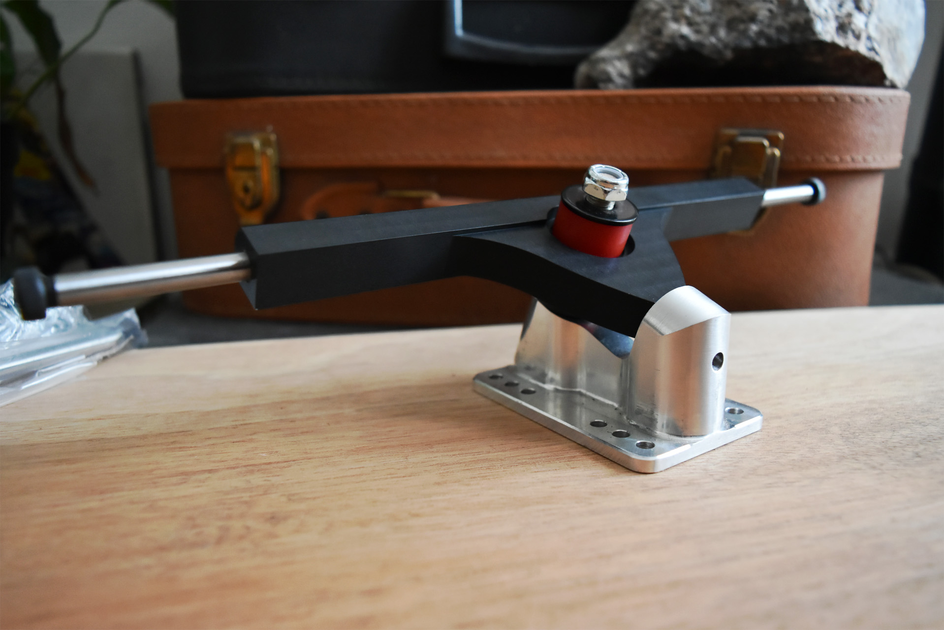

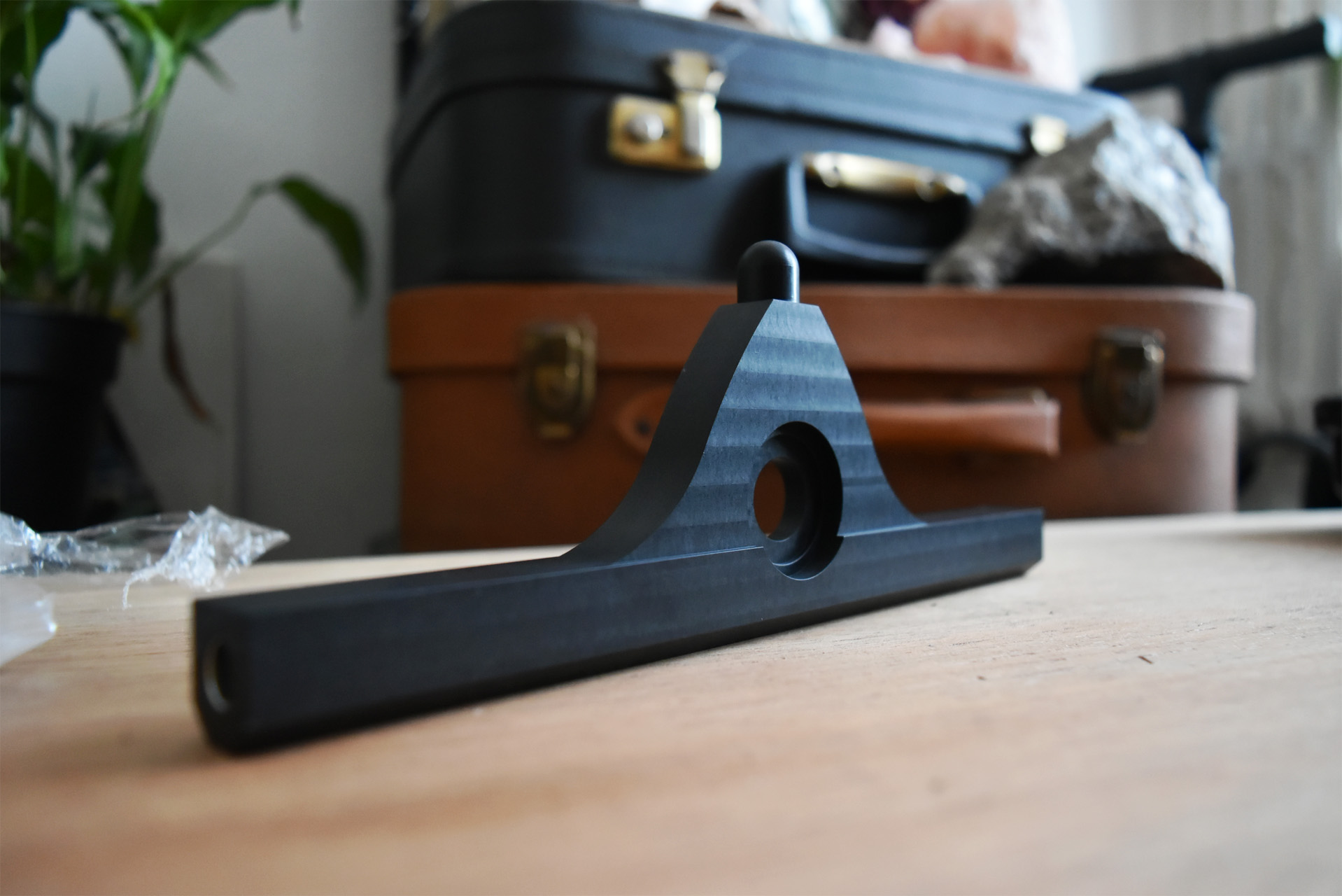

Some BN220mm of porn now :stuck_out_tongue:
I’m so happy ! I will set one on the front of my Mad Furry setup :v:
