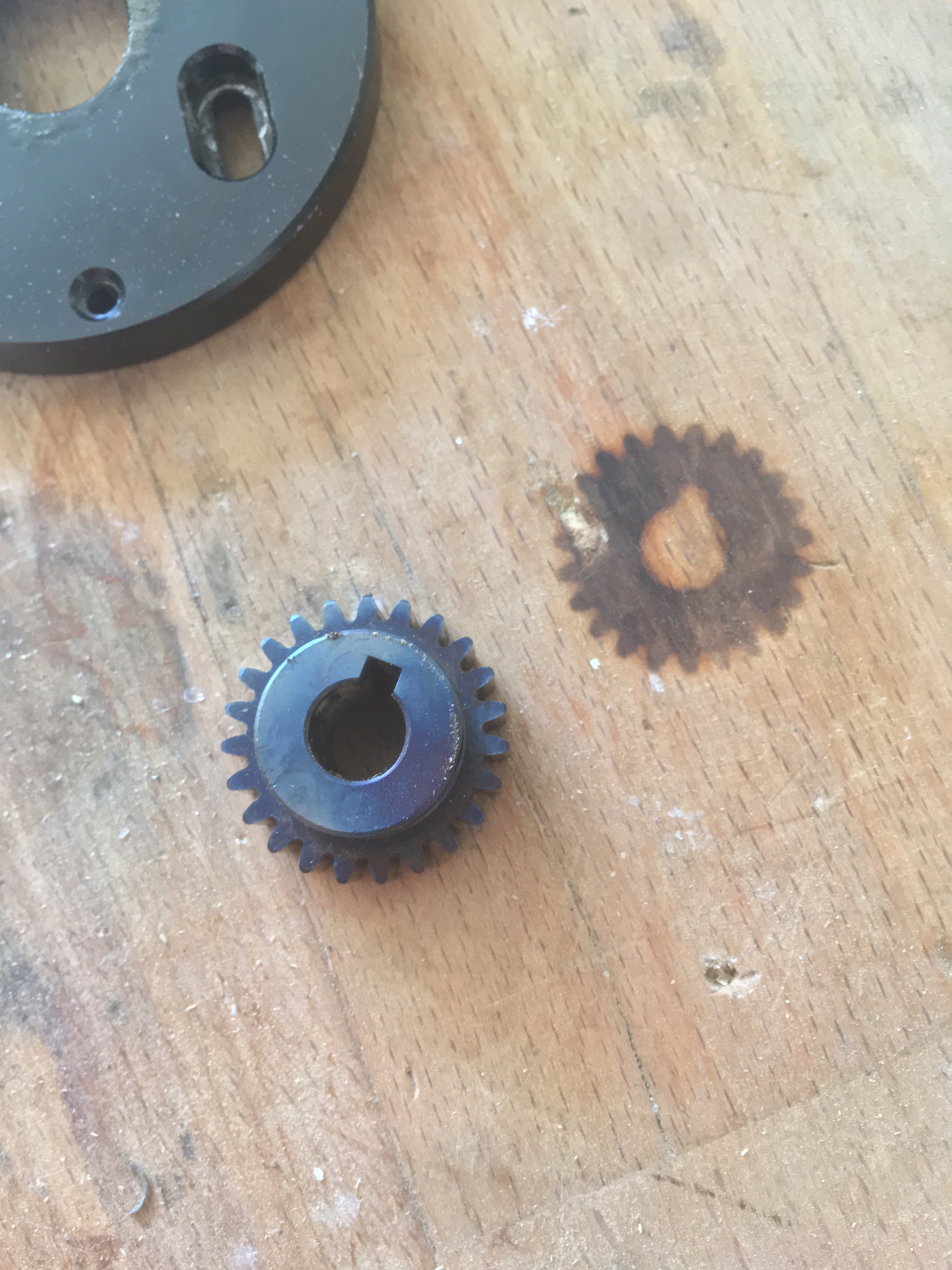

Removing my gear affixed with green Loctite was quite a feat, now I’ve got a pretty design on my bench and a colorful gear.
Make sure you get a powerful blow torch when you remove it, my two little eagle torches were far from adequate.
Doesn’t need to get that hot :sweat:
Really???
Before I got it this hot to make the gear colorful I had like three trials of heating it, hammering it a bit, than trying to rip it out with pliers, each time failed.
My last trial I made it super spicy and than it slid right out.
