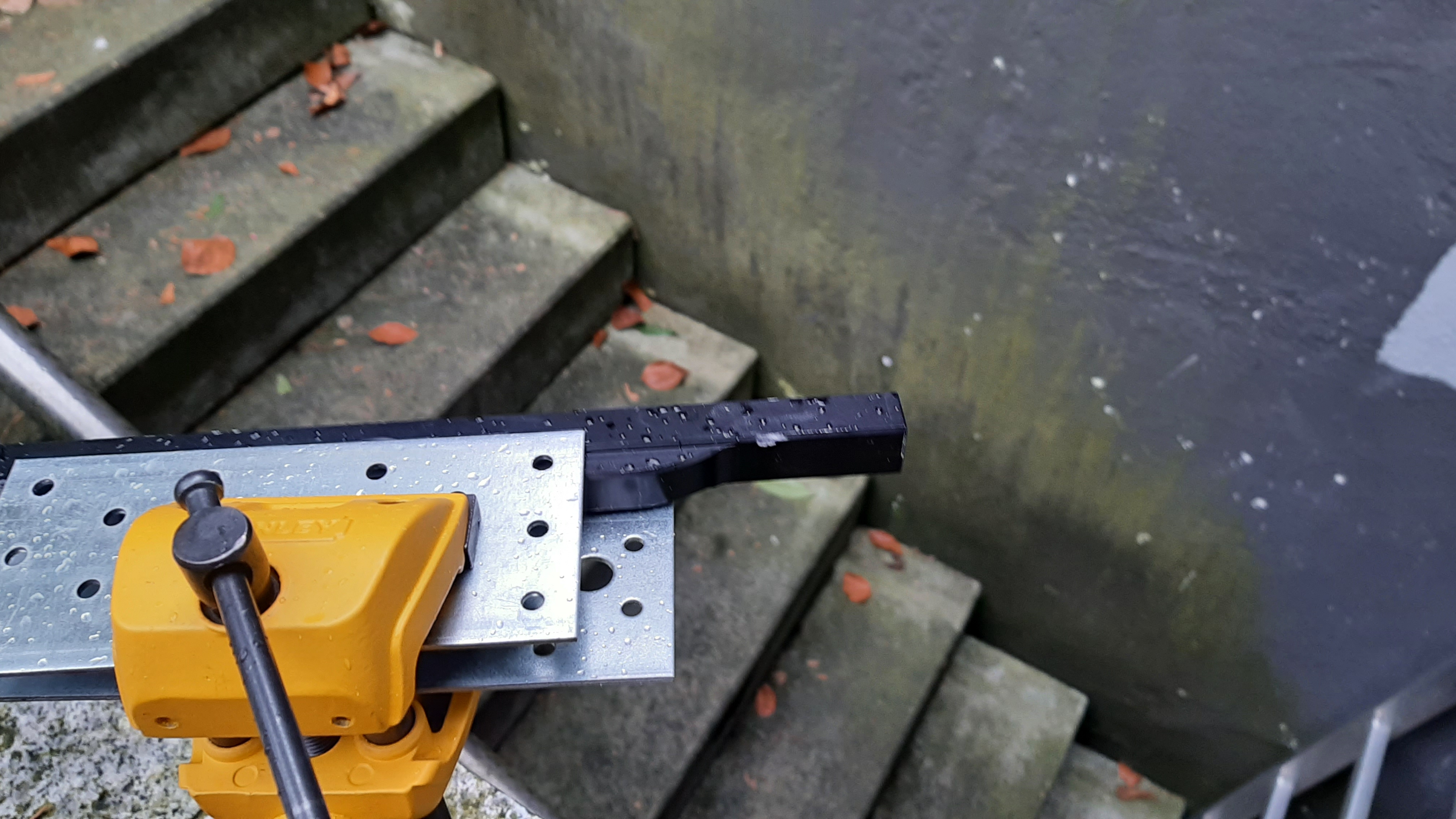

Besides someone who has no idea about what he’s doing, do you guys know what’s going on here?
It’s as if the bn270 hangers are combustible :sweat_smile:
You’re angling the torch down (might also be the wind), this causes liquid propane (or whatever gas is in your canister) to come out. That and the fact that the torch now has a hard time mixing in oxygen makes the torch burn very rich and you end up with big flames like that.
Put the hangers somewhere higher and torch at them from the bottom.
You’re choking the nozzle with liquid propane, that’s all. Keep the canister under the burner and it will be fine.

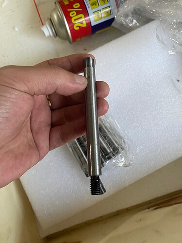

Quite right. Managed to melt the loctite and to rotate the axle.
Weird thing is that it rotates now but doesn’t get out. I’m quite sure I didn’t force the thread either on screwing or otherwise :man_shrugging:
Use a pair of vice grips and twist back and forth while you apply sideways pressure, that’s how I got my last stubborn one out.
Success!!! Did exactly that: back and forth and sideways pressure and it came out easily!
Overall it felt pretty easy, once I managed to hold the torch upright…
Now it started to rain :confused:

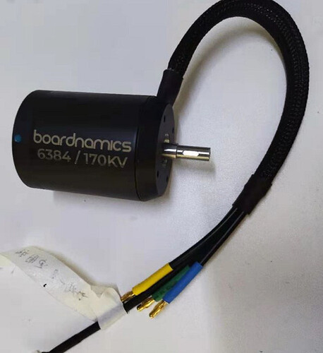

Do these fit on the 220 hanger with your GD’s? If not, what’s the largest motor that fits them?
4mm bullet connectors right?
They do with the adjustable baseplate.
@moddedlife yes 4mm
