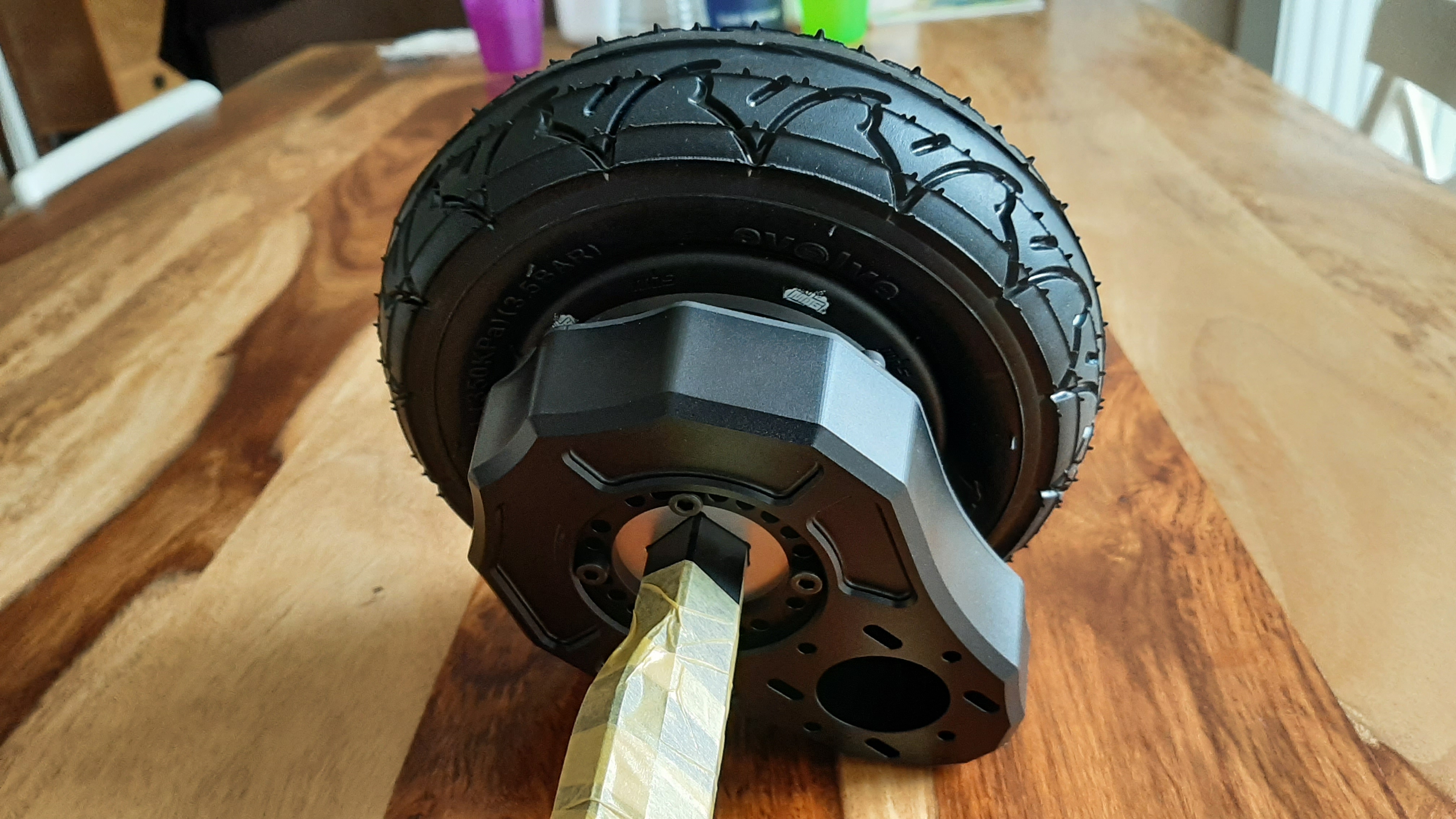

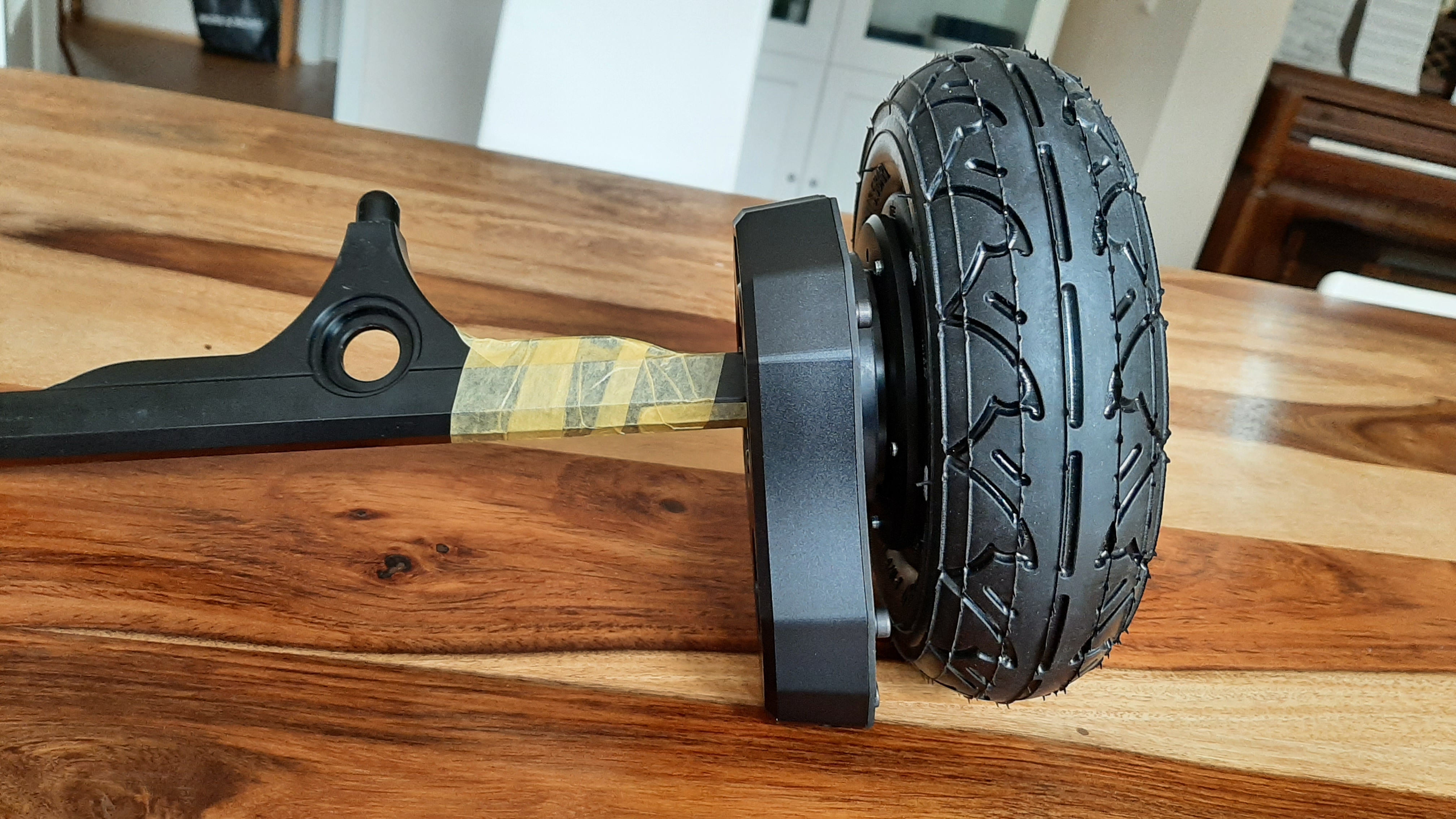

Ended up with 90mm long shoulder bolts for Moon GD + BN270 + MBS Rockstar combo.
Waiting for the 10mm bearing spacers to come and still need to figure out how much of spacer is needed between the GD and inner wheel bearing. Not so sure how I’m gonna do that, probably through trial and error.
Can you post a side view with the geardrive mounted?
Hope of these is what you asked :slight_smile:
Thank you! Looks like 90mm shoulder bolts are the way to go!
