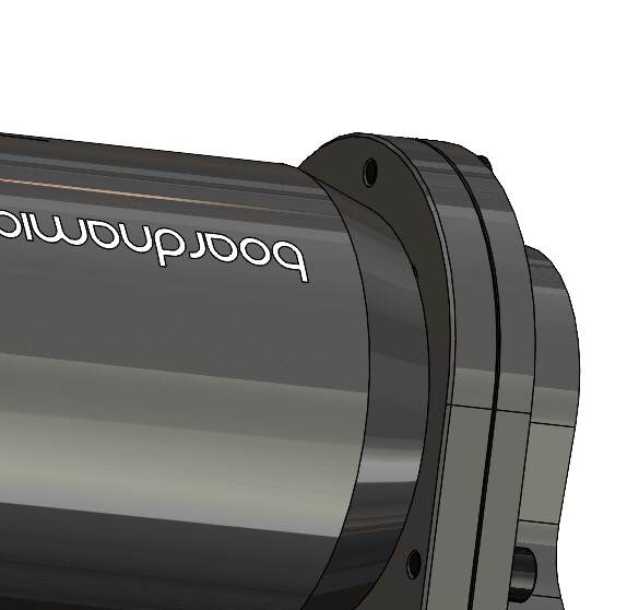

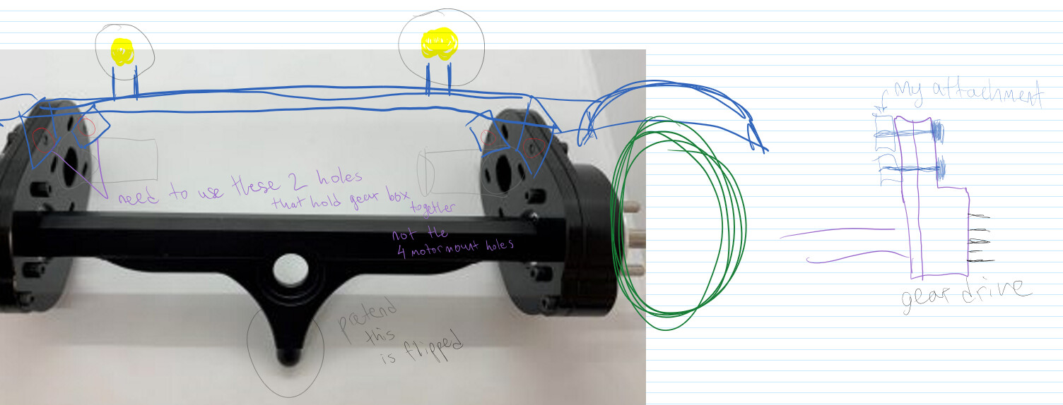

@Boardnamics would it be possible to order m1 at gear drive kit with longer bolts? Or do I replace them with regular m3, m4 bolts? I’d want to add a 3d printed bar connecting the two gear drives, as well as light mounts and mud guard mounts. Is it okay to add these things like this or it wouldnt be good for the gear drive in some way?

Those bolt are m4, the way you have them in the pic you would need to use nuts on the backside or thread into plastic I guess.
Best to just order the bolts yourself.
The fenders are nice haha
I have a kit of m4 bolts from amazon that are stainless steel and manufactured from china. Yeah id definitely add a nut mount to the plastic part. I just want to make sure this wont be doing anything to affect the gear drive in any way after long term use like with lots of vibrations? Maybe Kevin can speak to if a nut will even fit by those bolt holes? With the 6384 he has in the kit I wonder if there is room to have a longer bolt that sticks out or the motor diameter is too large where it covers the inside of the mount and those holes need to be flush with the mount.

@Athrx The 270mm assembly is quite specific, sorry for not giving you good instructions. The new axles will simplify the assembly greatly.
10mm diameter, 60mm effective length. Big 5mm hex drive.
The Flipsky motors in the future kit wont technically block off the holes but it leaves little space to add anything else on the other side.
