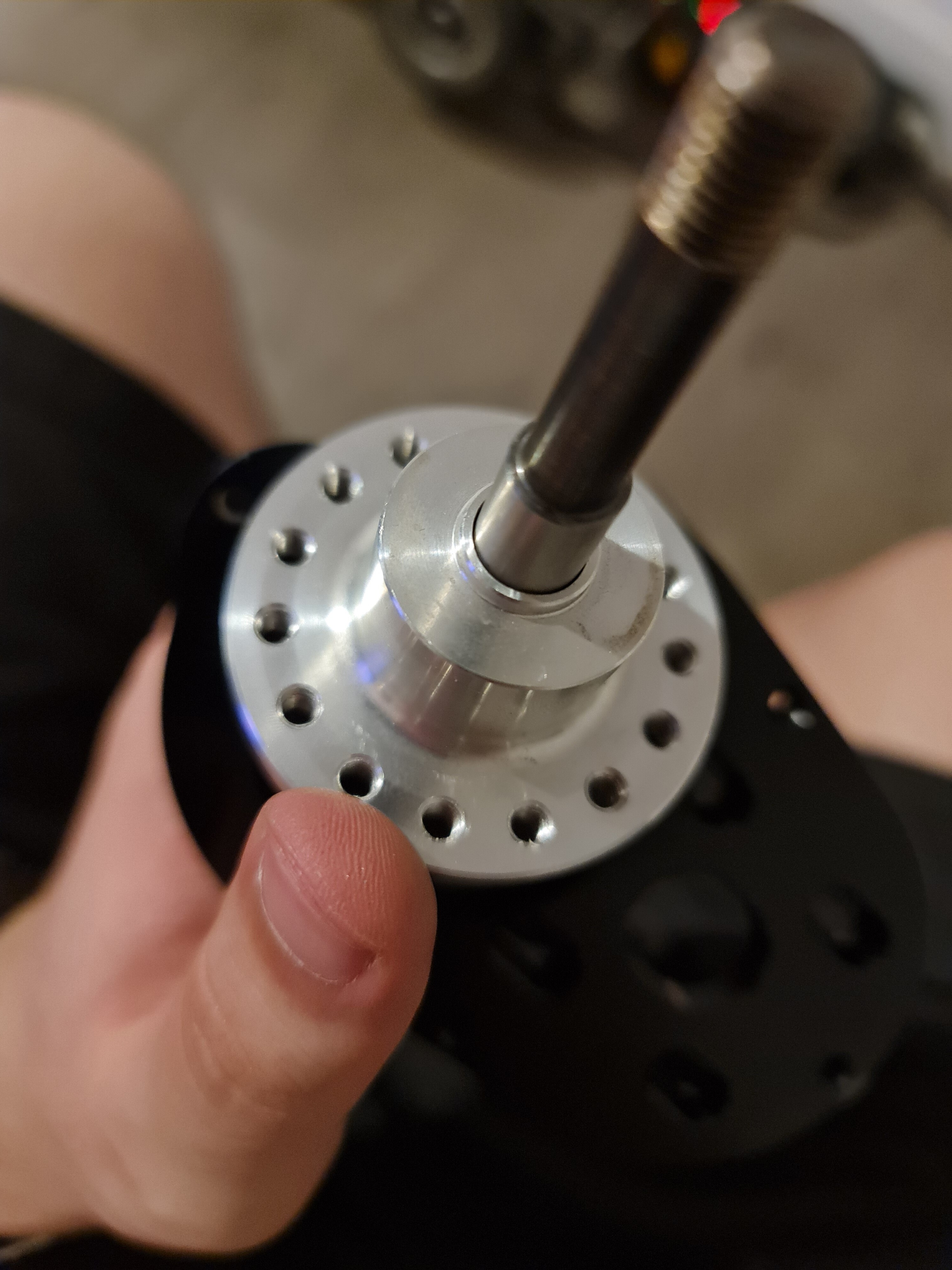

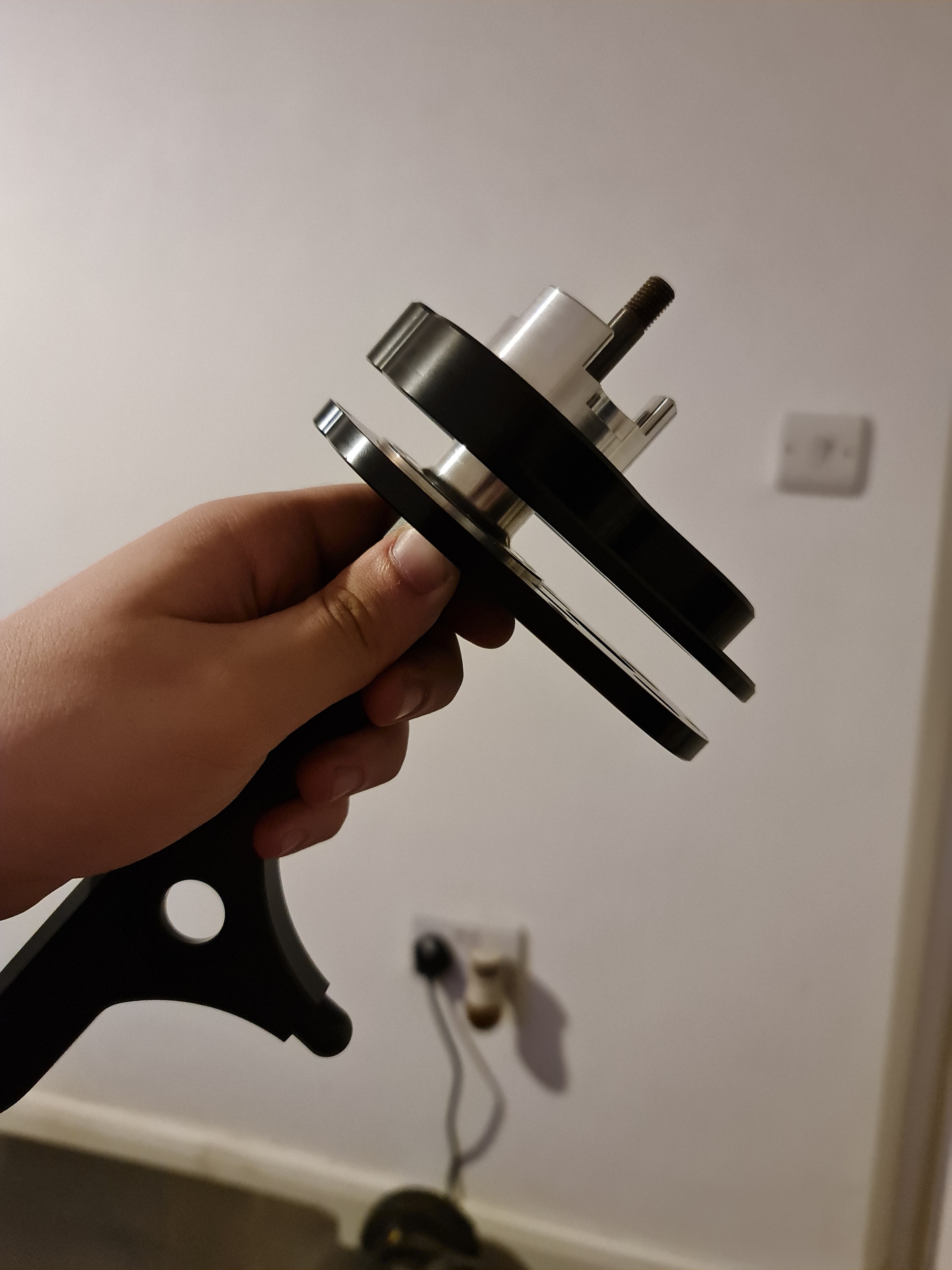

Well, got the 220 adapters to fit the 270 hanger
…but.
This is gonna be a long week.
Anyone know what else is needed beyond a 6900-2rs bearing and a 1mm washer?
Is it a good idea to add some grease to the o-ring?
**i also forgot; how about on the bearing that goes onto the adapter?
Not necessary as it is a static seal.
No grease on the bearing either. It should be a light press fit but I messed that up on the first batch. Not a big deal

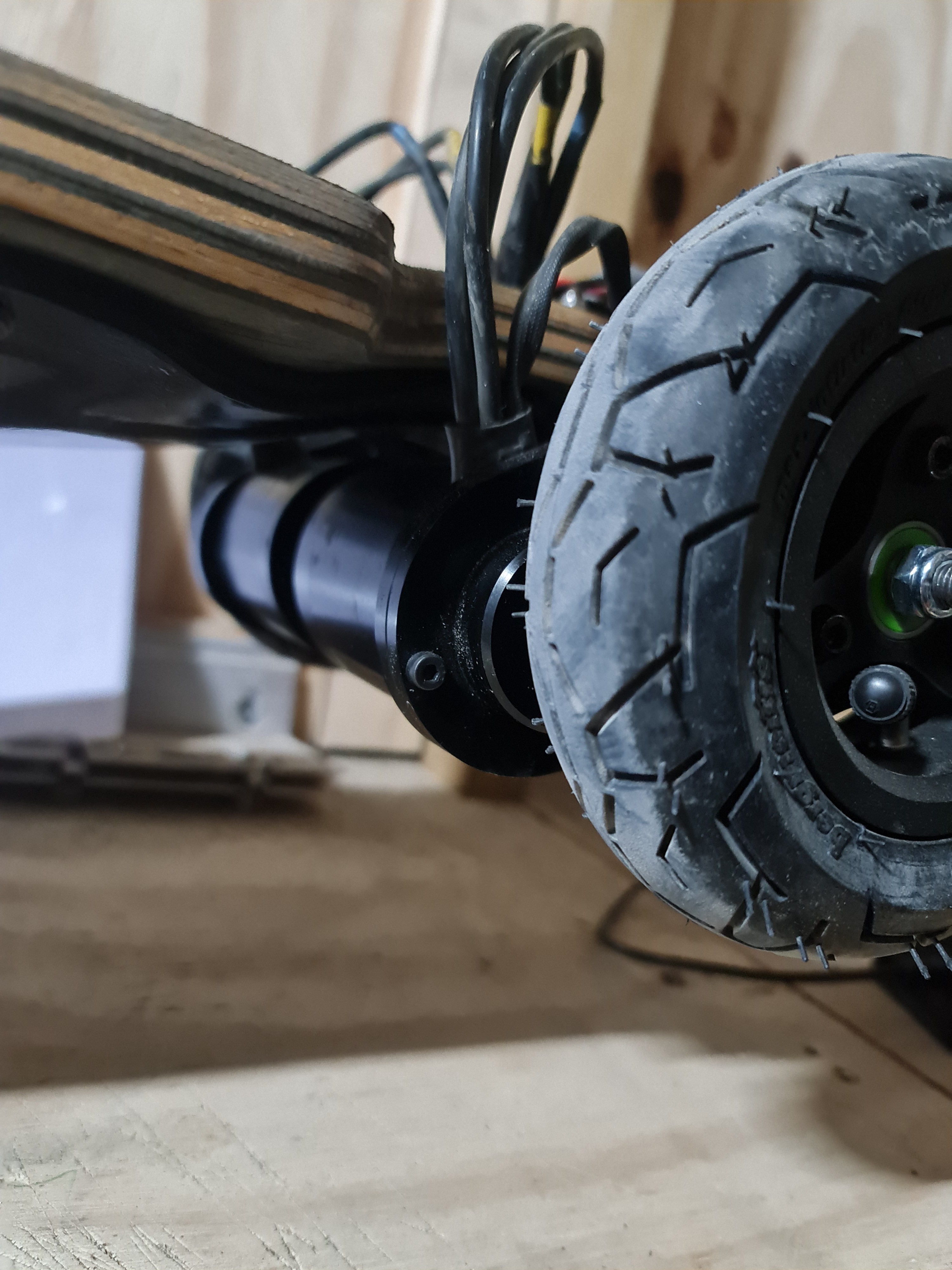

Did anyone manage to grind down the 270 hanger and get some good pictures of it?
NOOOOOOO!!! hahhahaha
I swear someone with a manual lathe and mill and a stock of @Boardnamics parts to modify could get some good business.

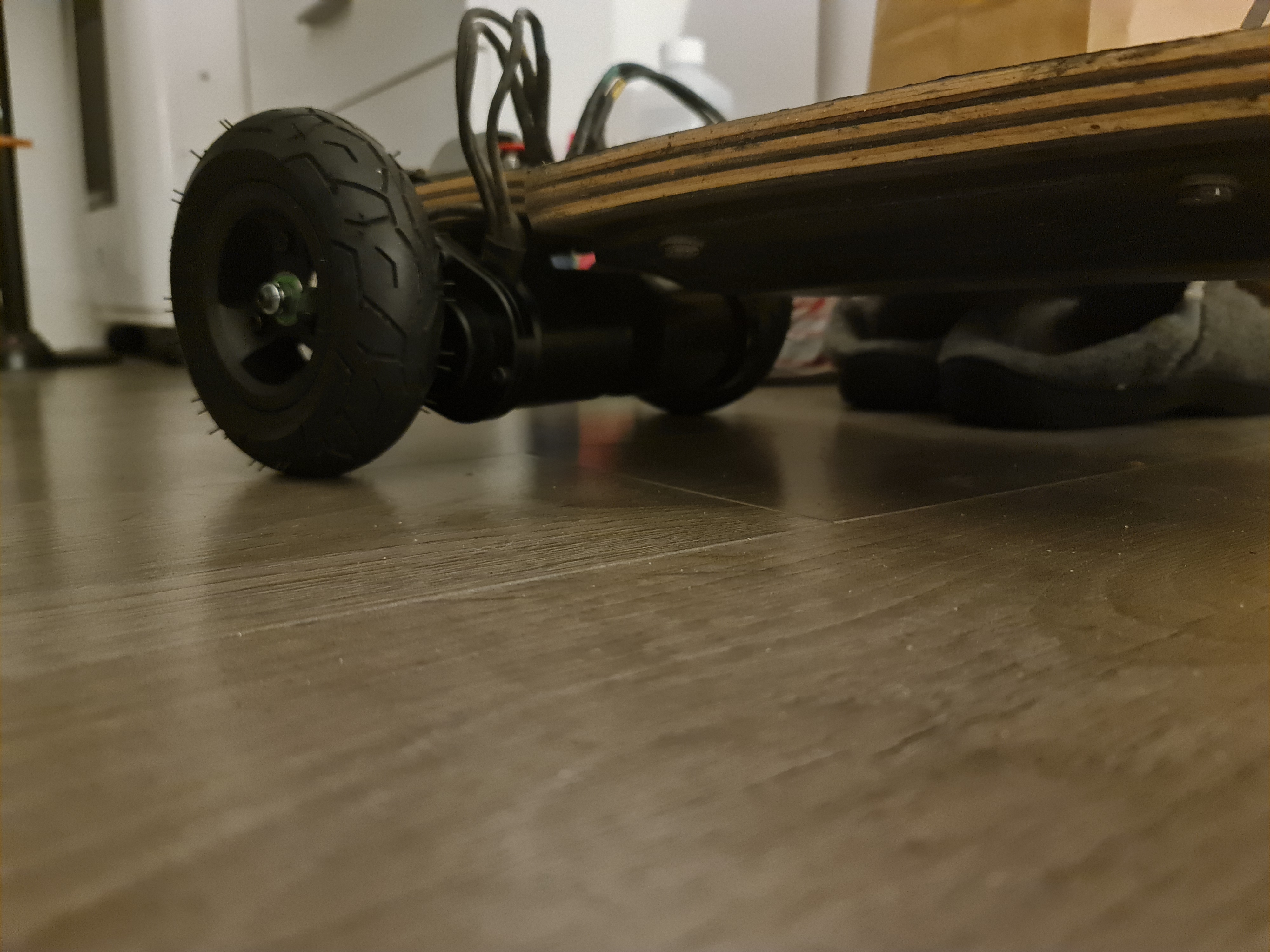

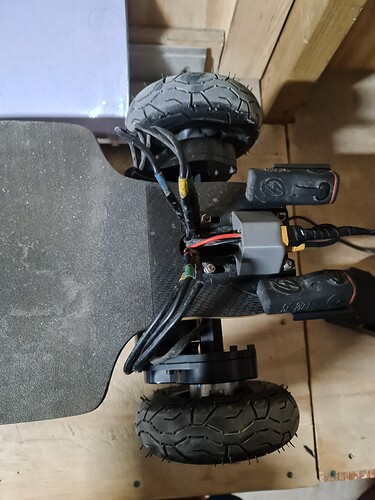

Could you take another picture from above? I am thinking of switching to 270mm hangers…
It’s on 220 now, got the wrong adaptor and couldn’t wait one more day to have the correct bearings arrive from amazon so filed it down last night & everything
