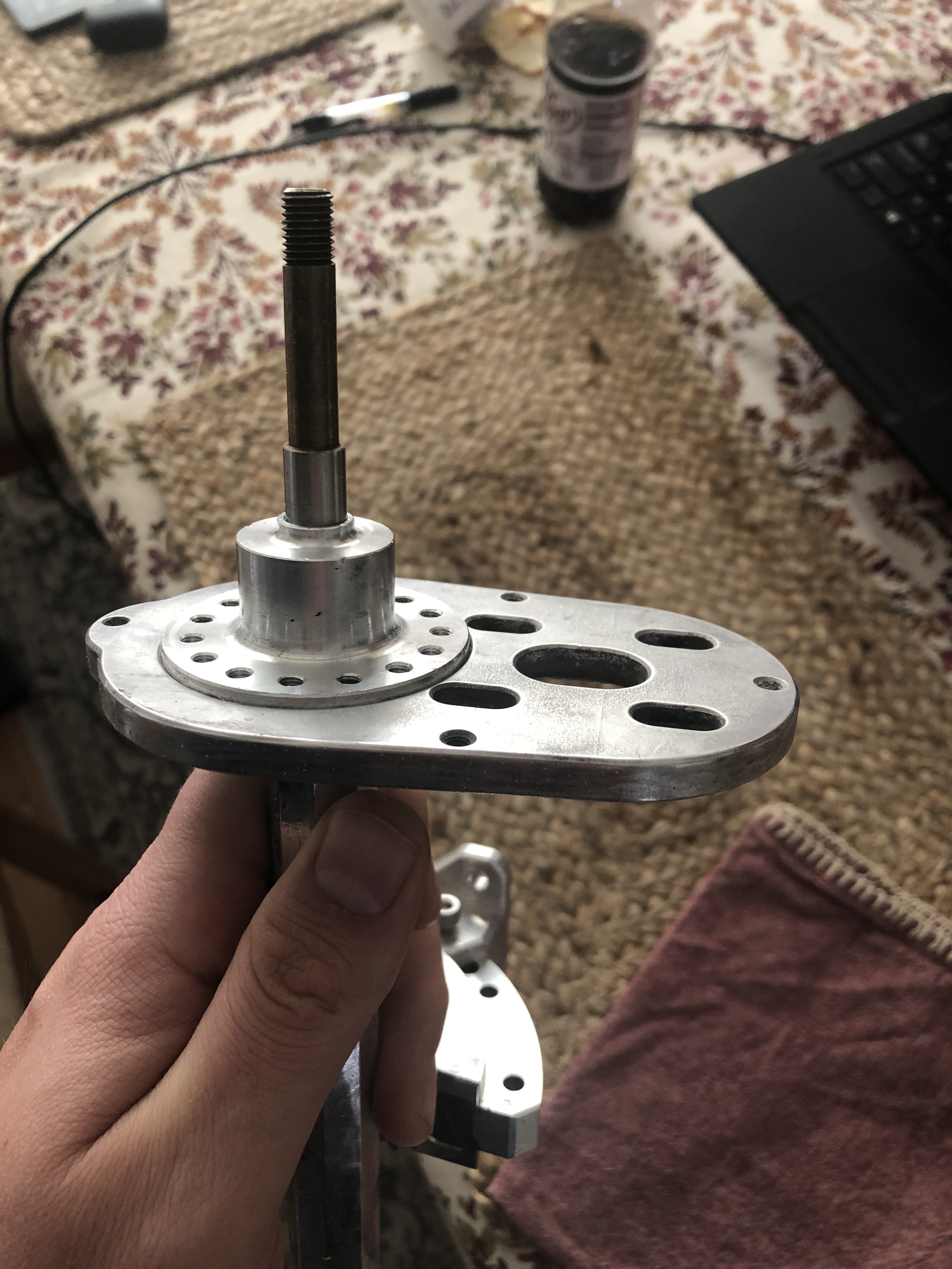

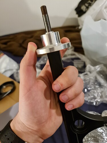

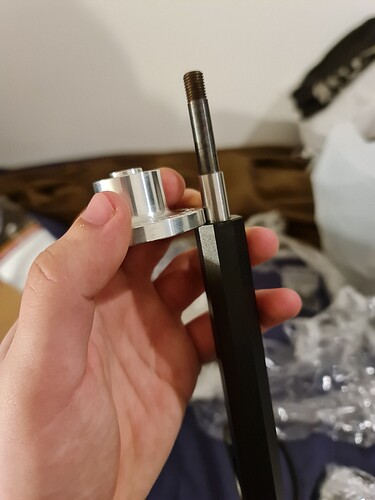

It overlaps for less than 1mm and beyond removing the axle nothing makes it come through. Pretty sure i asked for 270 adapters

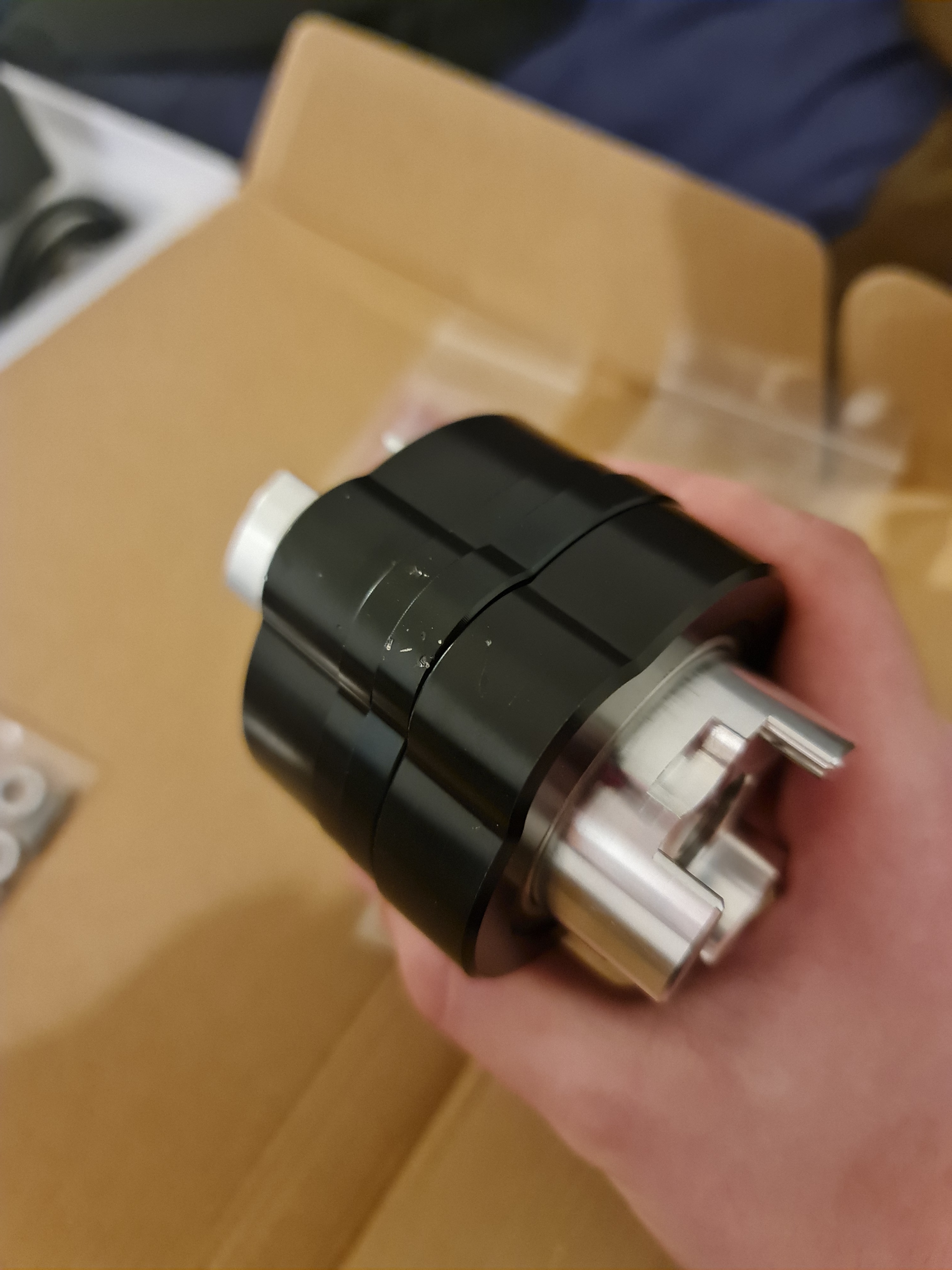

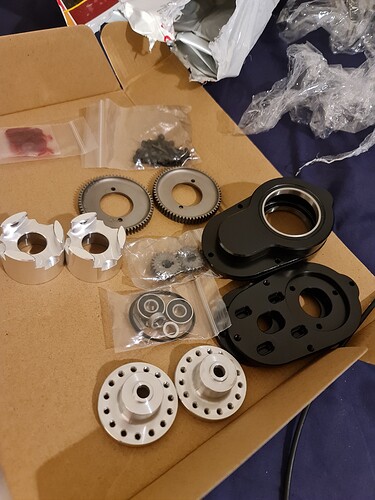

This is everything in the box
You are correct, something isn’t right.
It’s a really tight fit, you need to break out that man muscle and muscle it on

That 8mm hole will not fit the 10mm axle by any means.
Weird that i have 2 608 bearings included that i assume are meant to fit at the stepped axle part
Edit: nvm, 6900-2rs bearings were supposed to be in. 608’s just fit in the berg adapters

yeah looks like you got the wrong adapter. you need the 270mm hanger adapter. did you get sent the wrong one? i think the checkout process asks you to select which adapter you want

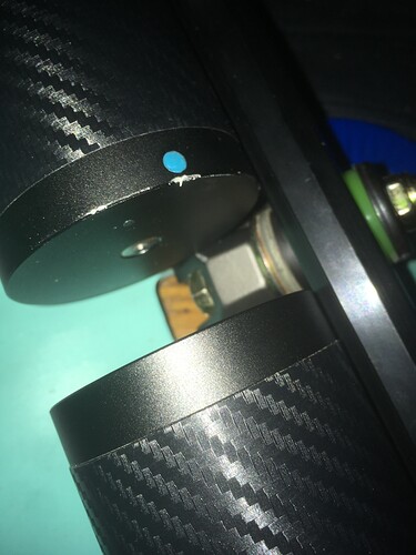

I discussed with him here to be sent both 220 and 270 adapters and paid the difference. In the meantime it took so long i bought 270 hangers from anubis and now wish to transition to the bigger hangers completely but i only have 220 adapters
Anyone have any suggestions to remedy my motors hitting the trucks that doesn’t involve shaving the shit out of my trucks?
This problem was discussed a few posts up.
Ah shit… its on backorder…
Yep my stocks getting really low at this point. In March, everything will be back to normal but until then…not much I can provide.

I’ll drop an order in March. In the meantime, do you think Maytech 6365 would clear fine?
Seems there only a couple mm shorter…
99% sure that a 6365 won’t have this problem.
