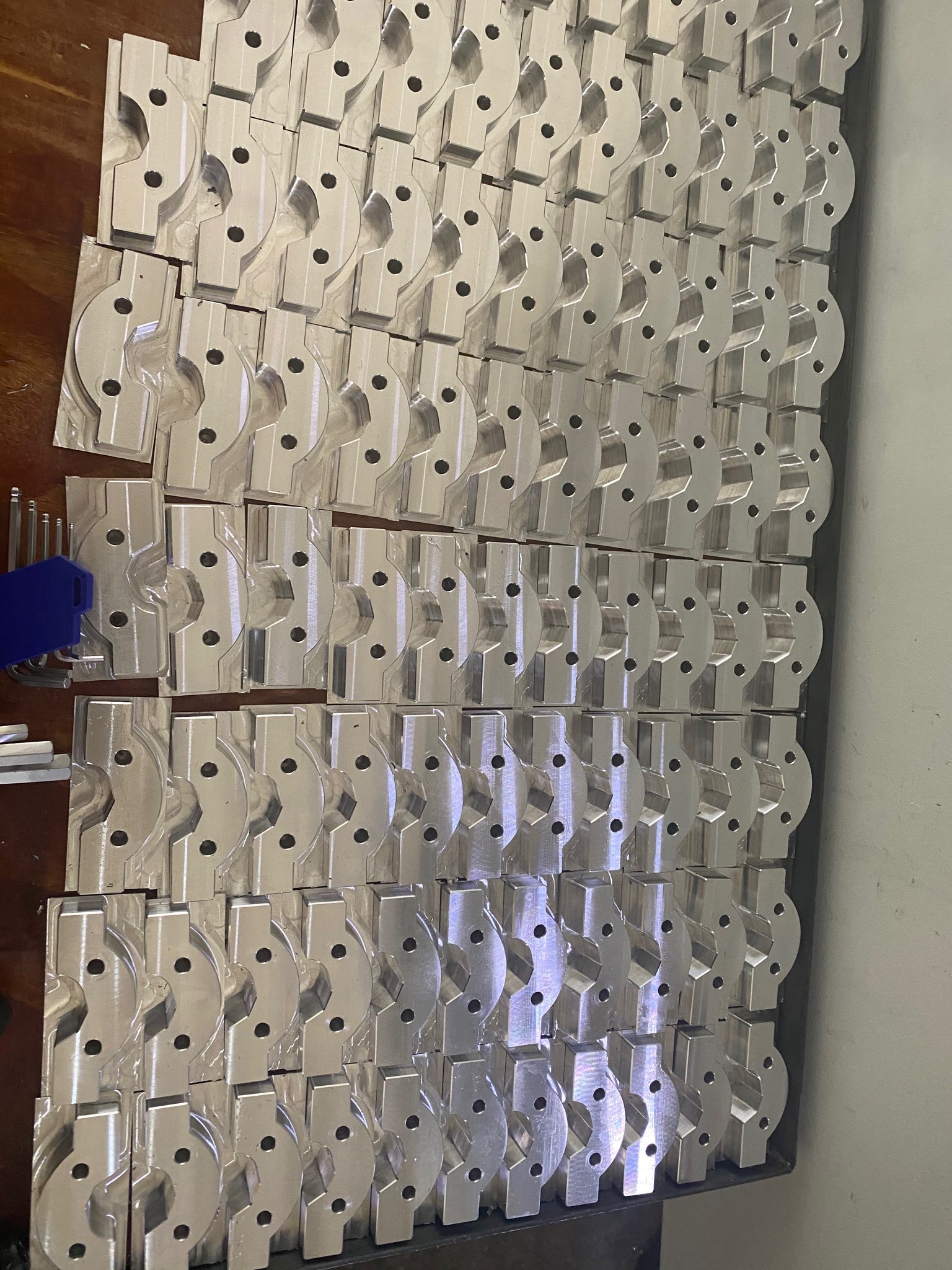

Btw installation guide
Paris/Randall will not help. The geometry of the baseplate that adds wheelbase(compared to BN/Cal) works against clearance for motors.
