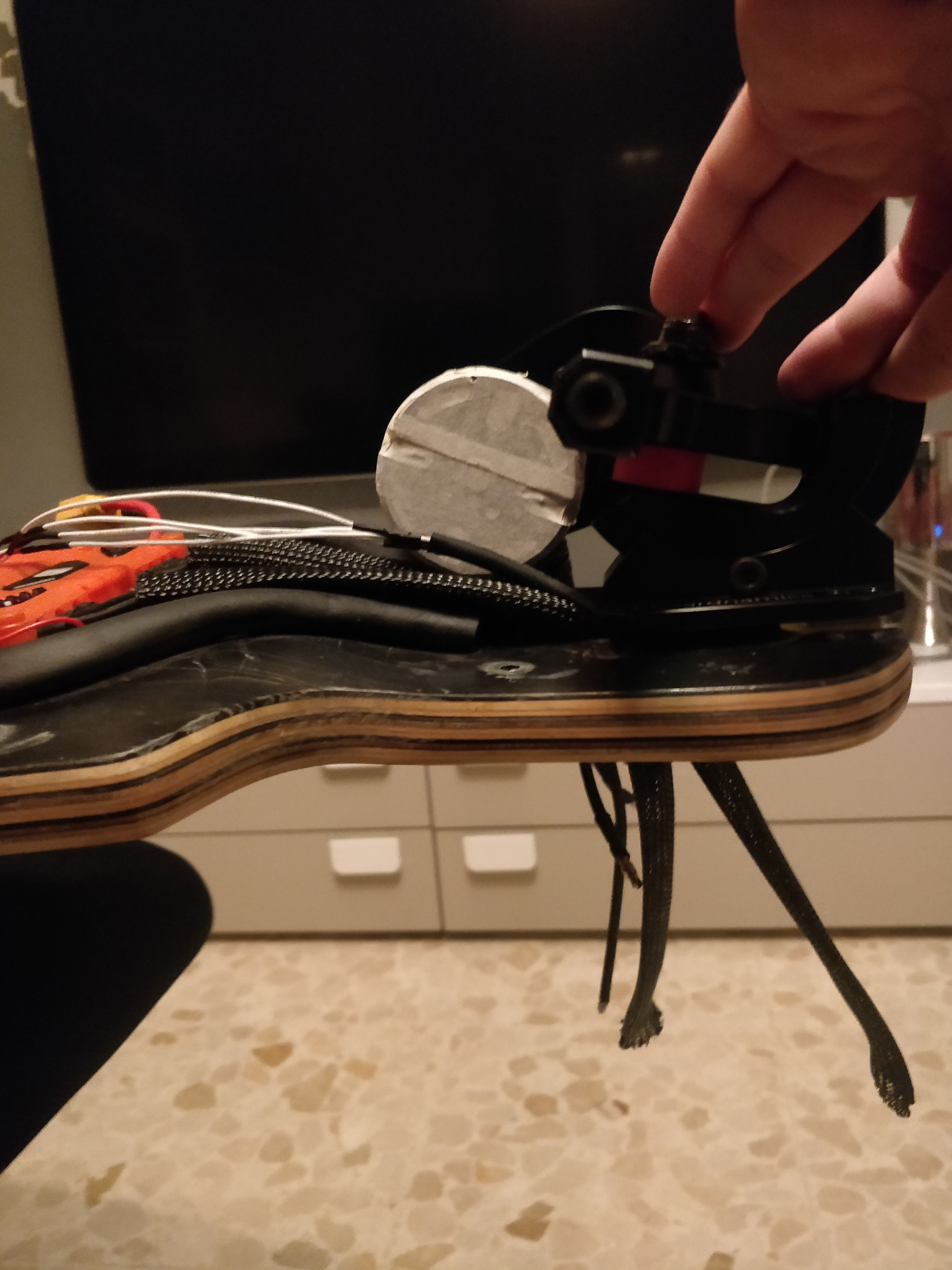

Hey, @Boardnamics, I just got my adjustable baseplate to try to solve my motor problem. The solution I thought off works great, but I have a pretty extreme angle in the baseplate. Can we get a pic of the new adjustable baseplate model to know if I can cut this one safely? I don’t know if I’m comfortable with no steering in the back of my board at all
In that angle my motors don’t hit the baseplate.
Edit: Don’t worry about the deck clearance, that will be taken care of later.
