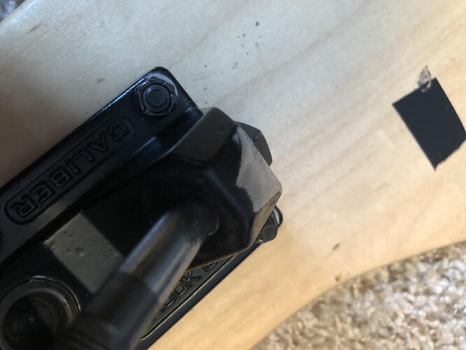

Hey guys so I got the single gear drive on the 184 axle and am running into an issue using my 6374.
So what I did was take the hanger off the baseplate and set the backlash using the paper trick. This way I knew ahead of time exactly where the motor would be sitting.
As per @Boardnamics advice I started sanding the baseplate and made pretty good progress, but no matter how much I do, I can’t seem to take enough off.
It clears without turning, but when you start turning the trucks, the motor strikes.
I have no problem continuing to file at the baseplate until it clears, I am just worried about taking too much material off.
I know wider hangers or a shorter motor are the obvious choice but I’d rather not spend any more money on this board😂.
I could file this so it’s even (like the white line) and it should clear no problem, I’m just want some reassurance that I won’t somehow snap my baseplate lmao.
I would buy a single 220 hanger from boardnamics and be done with it, not worth the risk of weakening a part that is keeping you from going full meatcrayon. They cost 40$ ex. shipping.
I have the same problem, I’m trying to get ahold of an adjustable baseplate to try to fix my problem, I have 220 hangers and dual 6380
Can you put griptape on the motor can and just let the motor itself make its own clearance?
Sounds a lot easier than filing, and you won’t take off any more than absolutely necessary.
Like this except a motor instead of a wheel
Depending on the baseplate you chose you may have some issues with adjustables ones aswell. I had to file a bit from my hammock baseplates to fit some sk3 6374 (which are huge for 6374) on BN220 hangers
