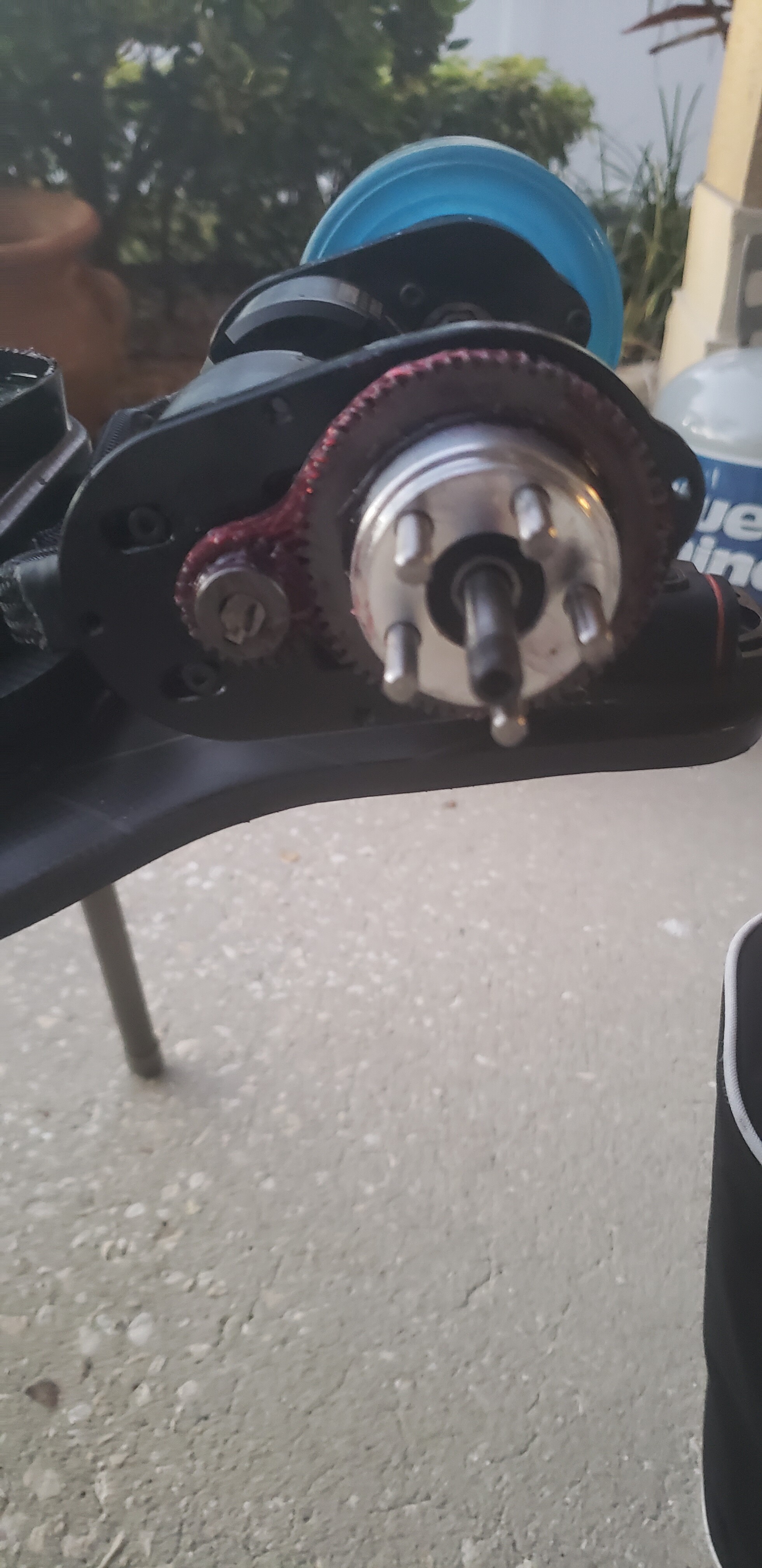

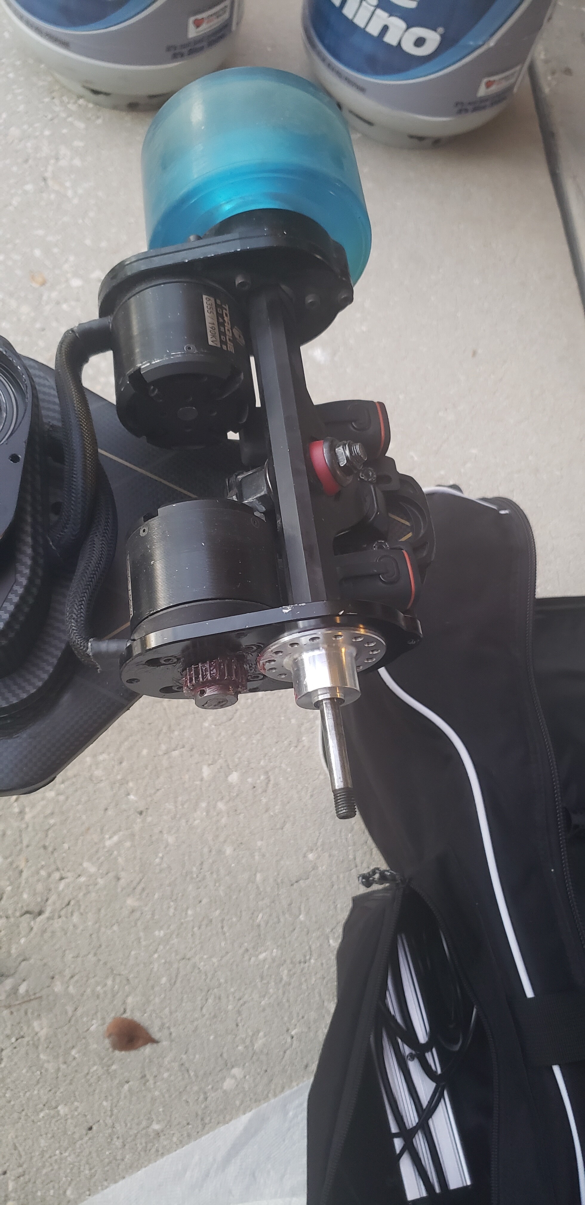

Hi affordable gear lovers. Got a few pics of my setup with the case open. Applied a fresh greasing and added a video so you can hear how the M1 drives sound. I’m personally obsessed with how they sound under braking.
Nice dude! How many miles do you have on these so far? They holding up good?

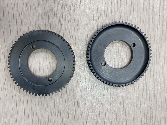

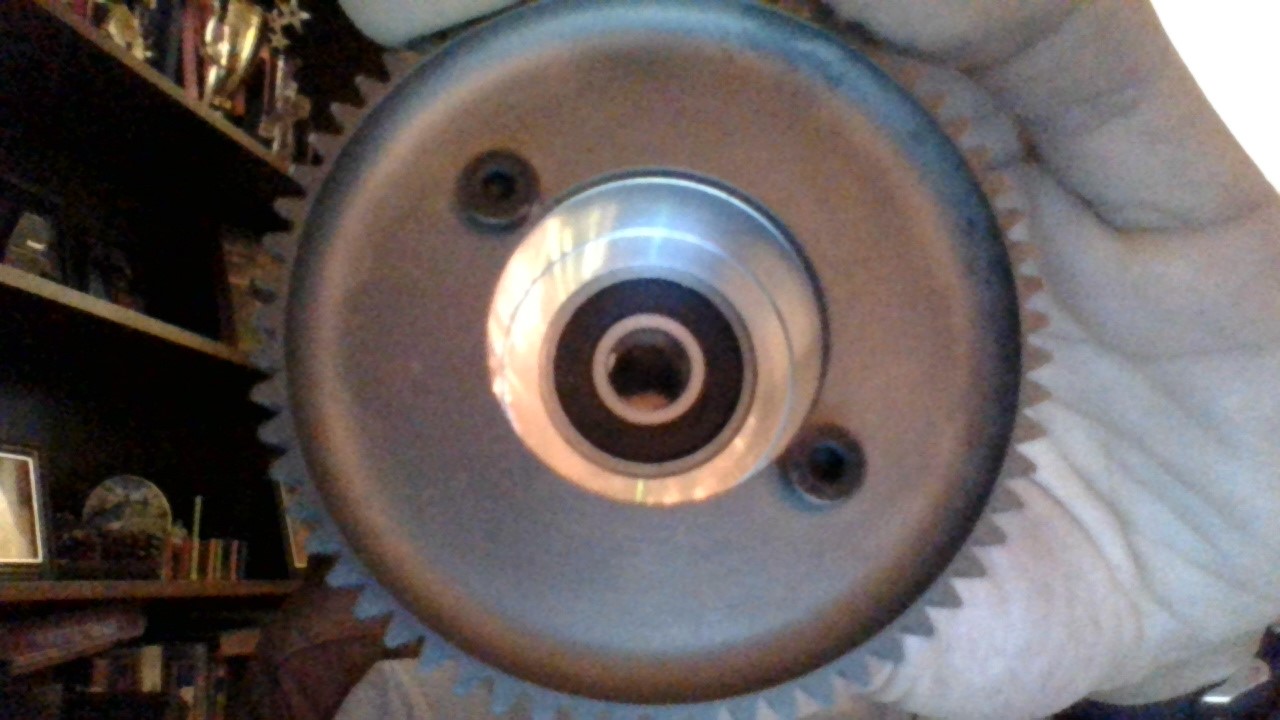

So I’m assembling my drives and it seems that the two screws that hold the larger gear on to the wheel adapter are rubbing when I put the assembly together. Did I do something wrong here? Is my hardware too tall?
Use the button heads
they look like this
I mean eventually it would wear down and everything would fit so whatever
I’d just file the bolt heads wherever it rubs. If it still rubs, file it some more.
Okay thanks guys. I’ve had a hard time coming up with metric hardware that fits exactly what’s recommended. Metric selection at local stores here in the US very limited. :man_shrugging:t5:
Don’t buy stuff locally if you’re in the USA. Order it online.
Yeah looks like I will have to get used to it haha. Thanks for the advice! it’s gonna be a file for now and I’m going to order the appropriate hardware.
Exactly why america is in the position it is.
It should have button heads in the hardware bag included just for the gear mounting specifically. No need to buy any

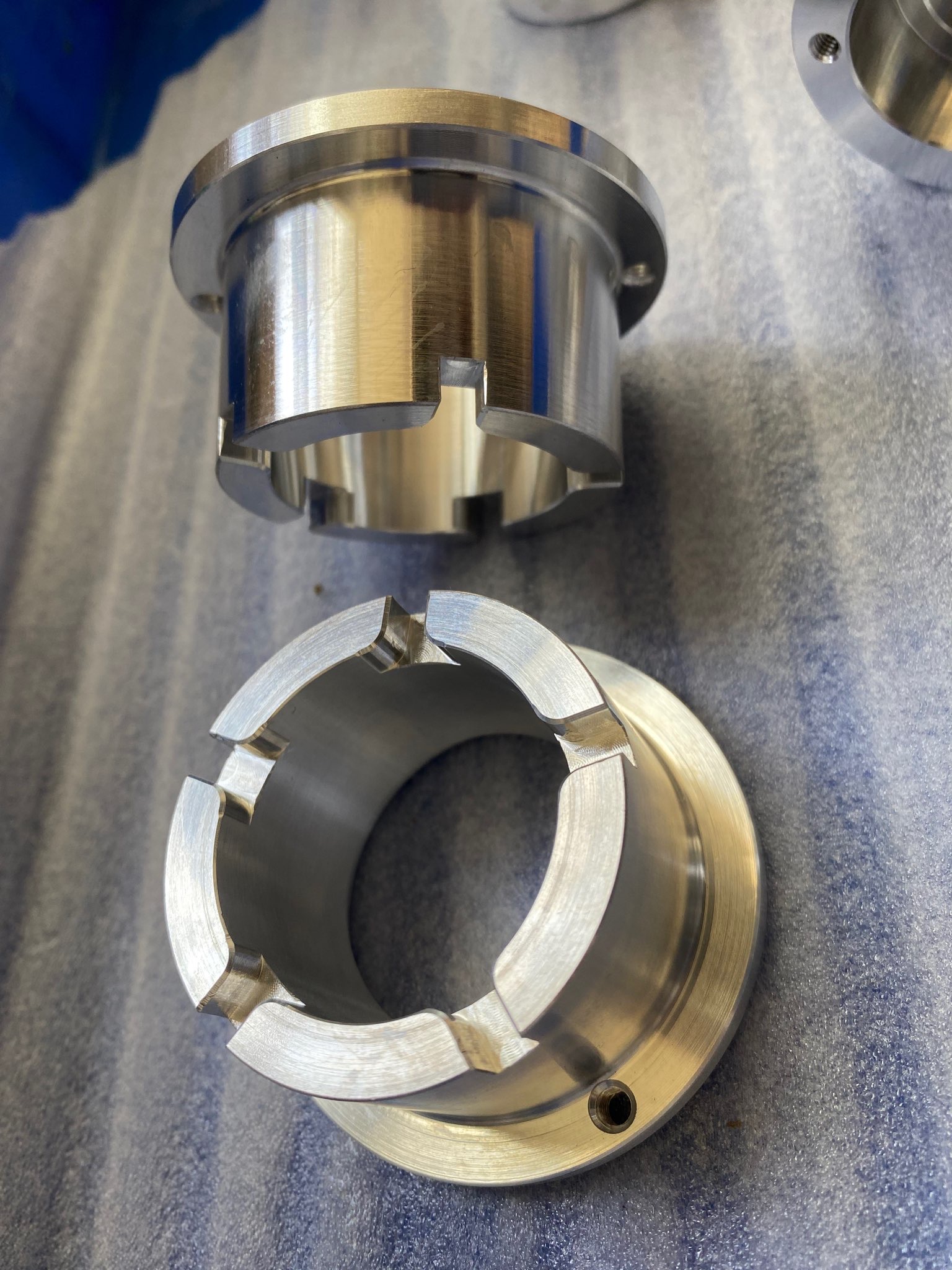

Are these superstar adapters? wot
Yes for the M1-ATS.
