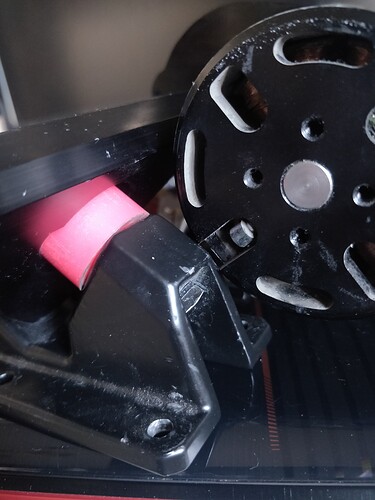

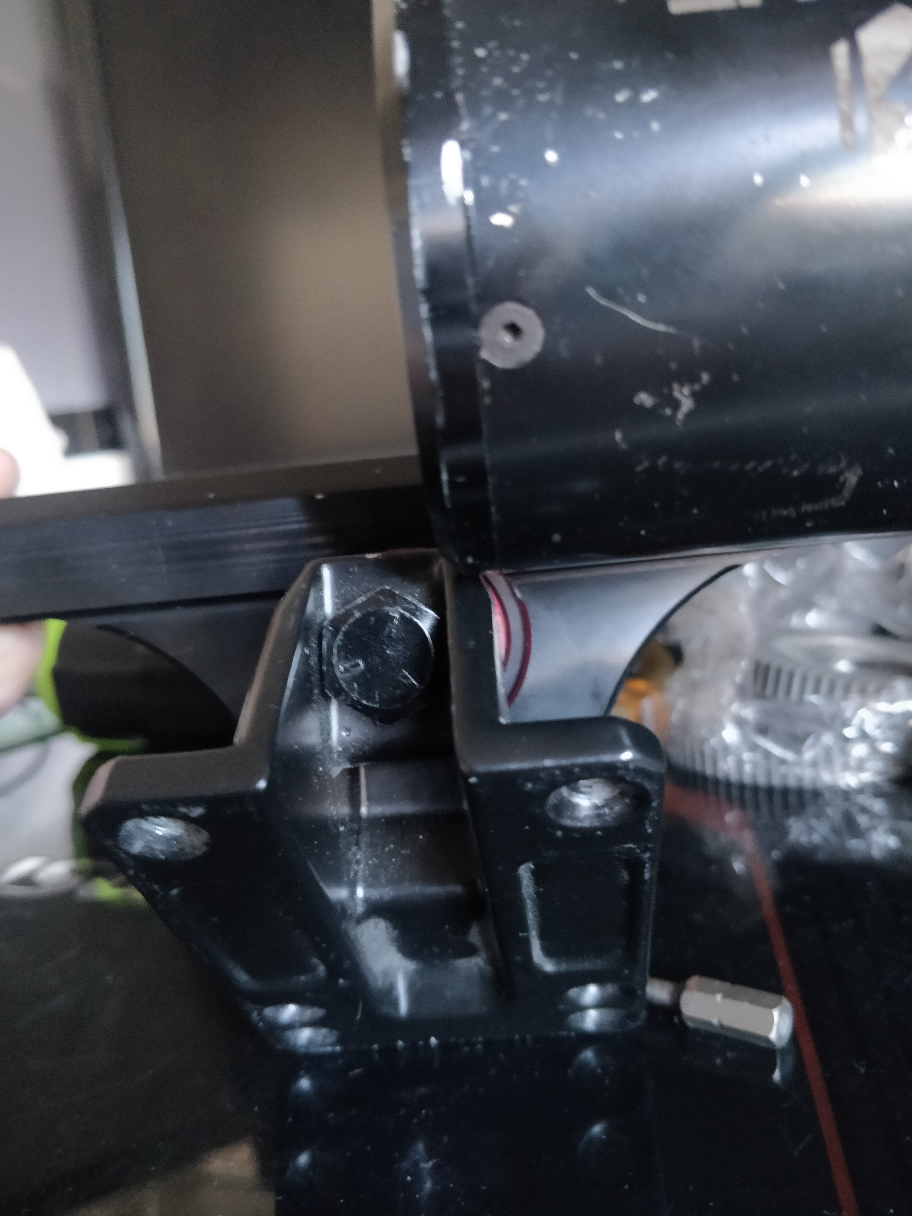

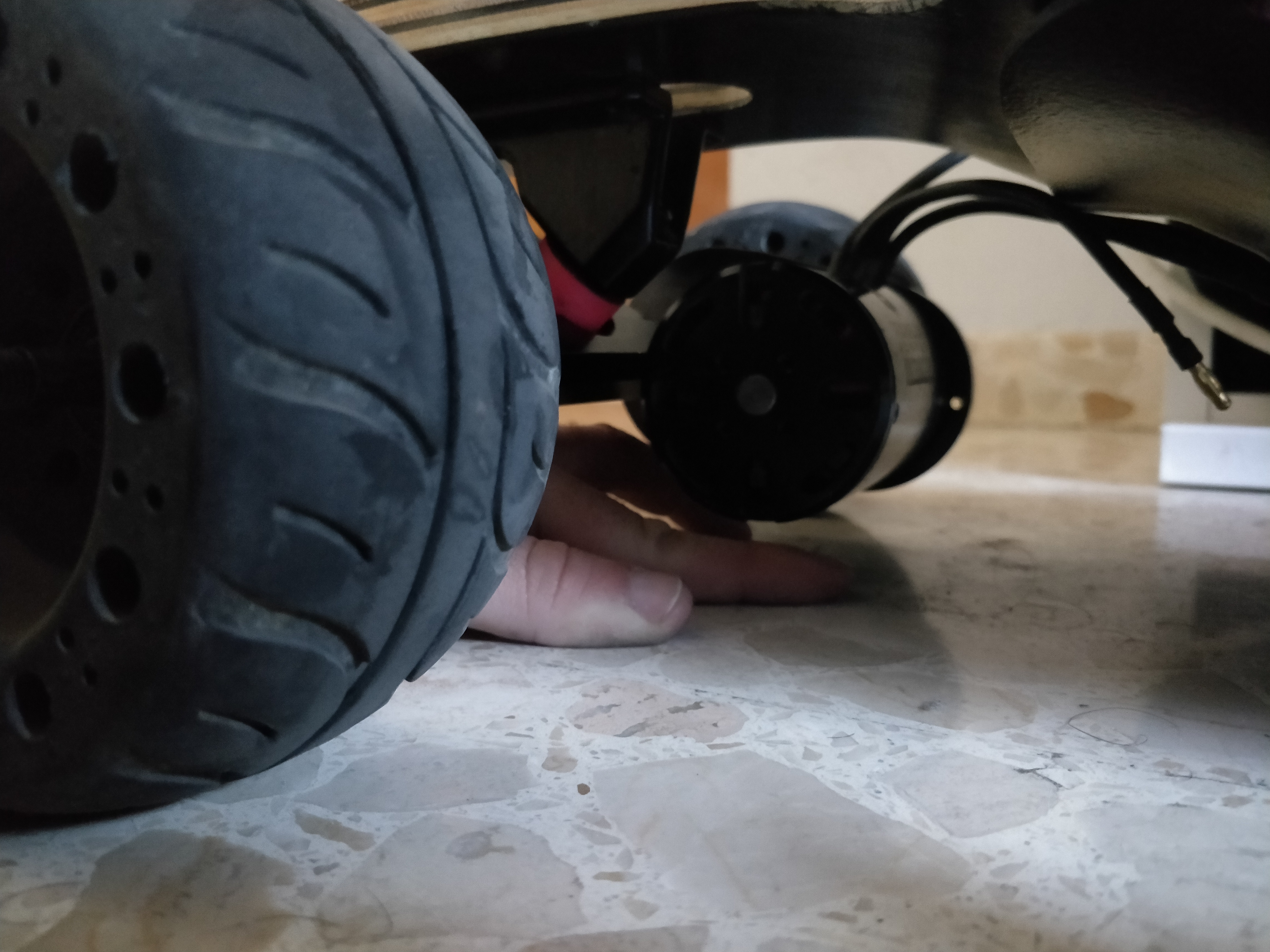

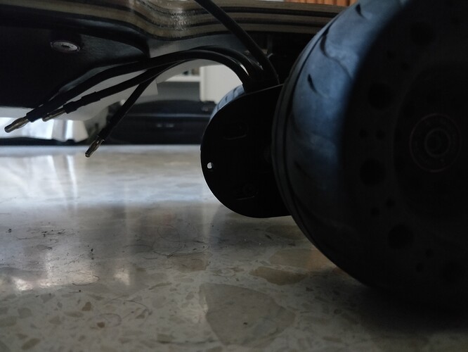

Dual 6380 fit the drives with 220mm hanger, but I have a clearance problem as in the ā€œideal positionā€ they hit my baseplate, so I have to put them one position lower and I have like 1cm clearance. Should I buy an adjustable baseplate? Try to cut the one I have now? Stick with the shitty clearance? Thanks in advance for the ideas
Adjustable baseplate + riser pads
Okey, I will try to find a used one as 77€ for a 3d servisas one it’s outside Budget XD
Talk to @boardnamics about getting a blemished pair
I got a pair from him for a really good price
The thing is I really don’t want to wait another 20 days for the baseplates :frowning:
Fair enough but it is the cheapest way

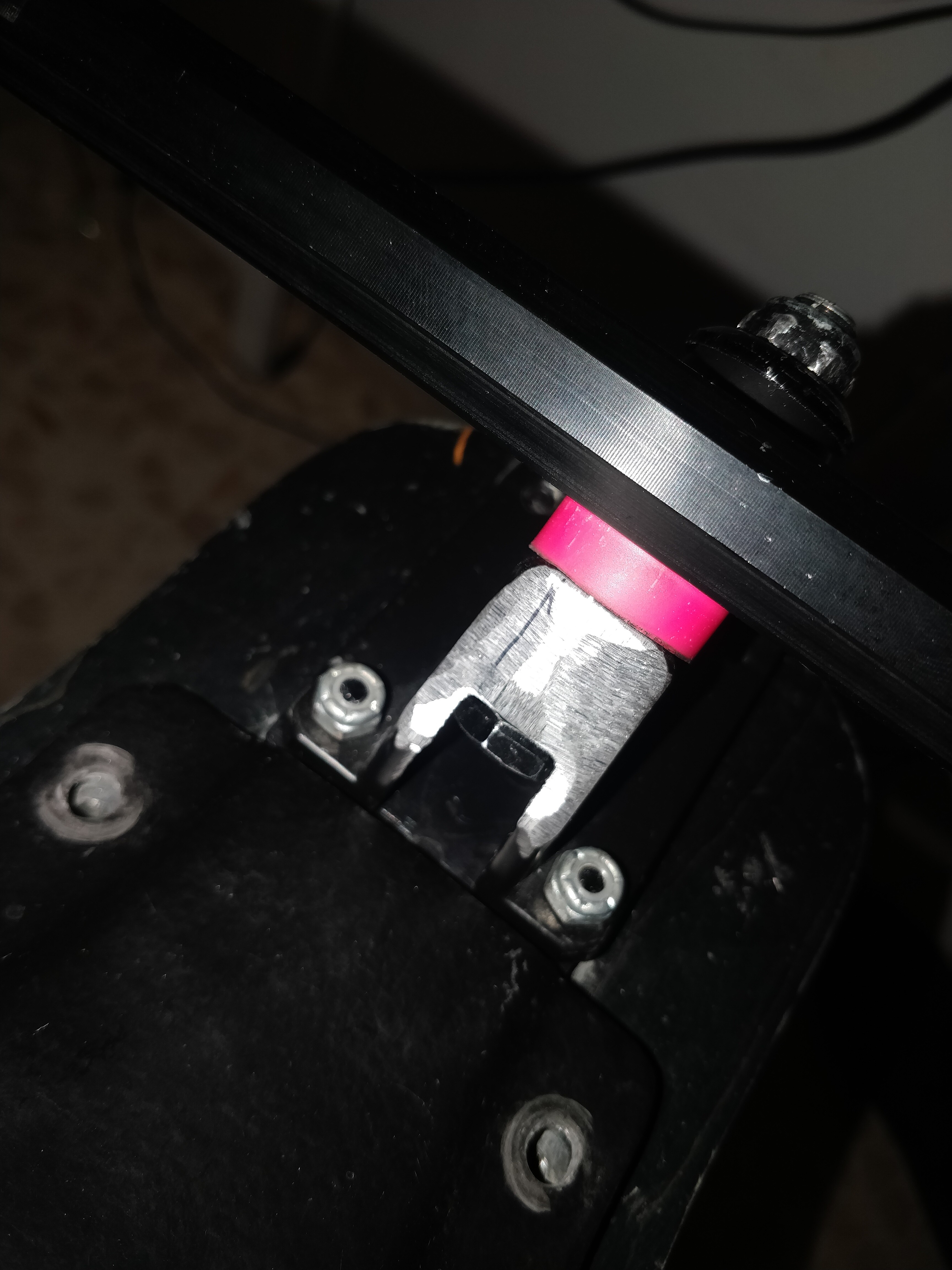

You could do some filing though
I’m on that while I find a permanent solution
Yeah, I was going to suggest just cut away the offending portion of the baseplate, but you don’t want to take a chance on compromising structural strength.
You could downgrade to 6374 motors and then it might clear the baseplate just fine.
On my drive I put spacers on the axle first before the aluminum drive mounting plate and that gave me the 5mm I needed for the motor can to clear the baseplate.
Had very little wiggle room with the wheel and the nut on the axle, but it works.
Worth a go, and if it doesn’t, adjustables might be the way to go, although I found that (mine atleast) are chunkier and introduced an issue with motor can clearance anyway.
