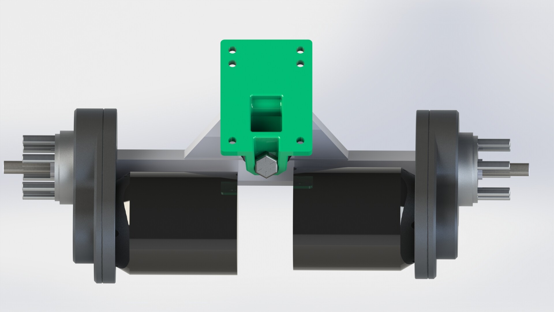

What is it that you’re modelling here? (are you reverse-engineering the geardrives or something?..my noob brain can’t work it out)
down to the .1mm range yeah. I have skipped the slew bearing and o ring for now, not hard to add.

I want to use the gearbox and also just some of the components for other purposes like the Electric freeboard projects. At least the pinion gear will be useful for sure.

Is this an accurate representation of how much space remains between two 6374 motors mounted on the BN220 hanger?
I’m wondering because I’m designing a 3Dprinted spacer that will allow me to leave a little more length on my motor shafts while still being compatible with the gear drives.
I cant fit 2 SK8 6374s on the 220mm hanger… Think theyre just chonky af though

these motors are 74mm exactly
model is really close
all important O-ring added.
