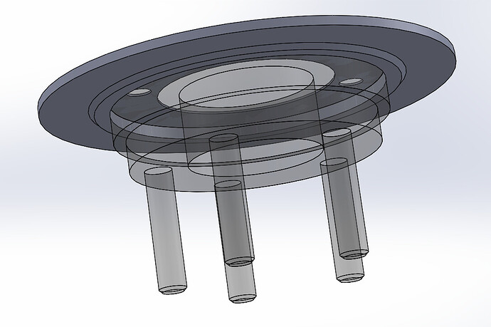

Yep the pulley and gear drive flywheel adapters are identical. They should fit, although they might a bit tight because they have thick spokes. Genuine abec fits like a glove but clones also fit, just takes some more gorilla strength.
Hi @Boardnamics, was wondering if your kegal fittings on your press-fit pulleys are identical to the design of the kegel fittings of the geardrives? - I’m guessing they would be (I.e that you recycled the design so the geardrives are essentially press-fit.)
Yes the pins are identical, but the actual pieces themselves are a little different. The gear drive one is longer
I ask because I’m getting some 3d printed berg hubs with kegel holes based on the geardrive pins, but I would like to use them with your 44T pulleys and basically want to know if they’ll work.
@Boardnamics idk if you share this stuff or not, but could you possibly share the cad model for the wheel adaptor compenent? I’m considering making my own trampa bolt pattern adaptor to run metro 155s, but I’m not sure if the geometry is something i can machine rn. If you don’t share cad I totally get it.

bn kegel adapter.STEP (68.9 KB)
part of a pulley.STEP (38.7 KB)

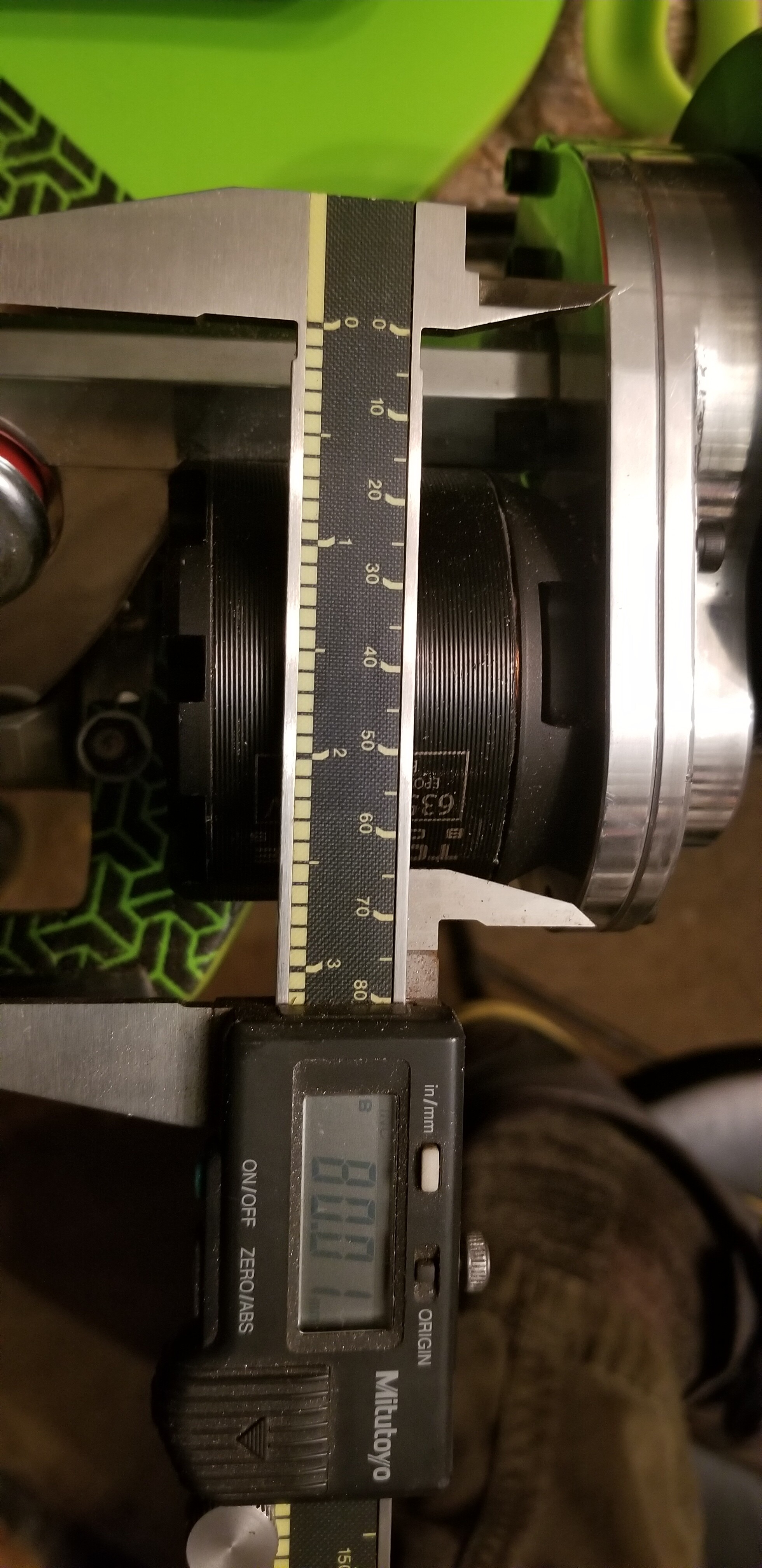

Anyone able to give me a centre of axle to furthest point of geardrive measurement?
Champion
thanks dude
