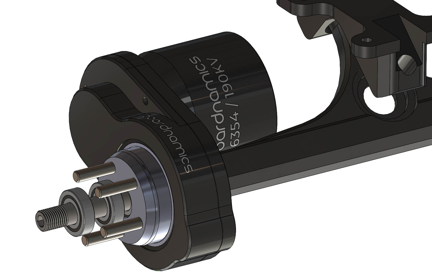

I had m1 reversed with 270 hangers. I suggest against it. There is only one angle you can have the gear drives set to without the motor hitting the baseplate when turning. That causes the motor to be very close to the ground and take some crazy abuse. Also to mention you need 2.20 gearing to reverse mount as the motor gear is bigger with 2.20 so the motor sits a bit further away from the hanger which allows just barley enough room to reverse. I was using 6374s so if you were using shorter motors you may not have to worry about hitting the kingpin when turning. Hope this makes sense
dang.
i guess i was tripping…
thought it was a thing that was doable.
i sure can;t roll with the 2.2 gearing…
do you have any close up pictures of the bottom?
Glad to see this response. The challenge with rear mounting these has more to do with how small M1 drives are (allowing them to run urethane, even under 100mm) versus hangar width. Motor can gets super close to the hangar once backlash is correctly set. The shape and angle of the hangar allows for more clearance when mounted inwards.
Everyone wants to go rearward like they do with belts, without understanding that urethane gear mounts need to be much smaller, while a belt drive mount’s length is practically limitless providing more clearance.

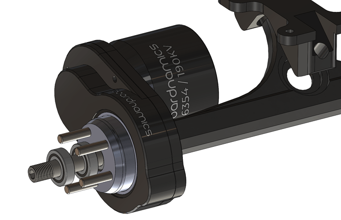

I’m wondering if reverse mounting will be easier with the newest generation of 270 hangers? Kevin sent me this screenshot:
It depends on that rising lip thats next to the “6354” of the motor which is the biggest factor in why u can currently reverse mount

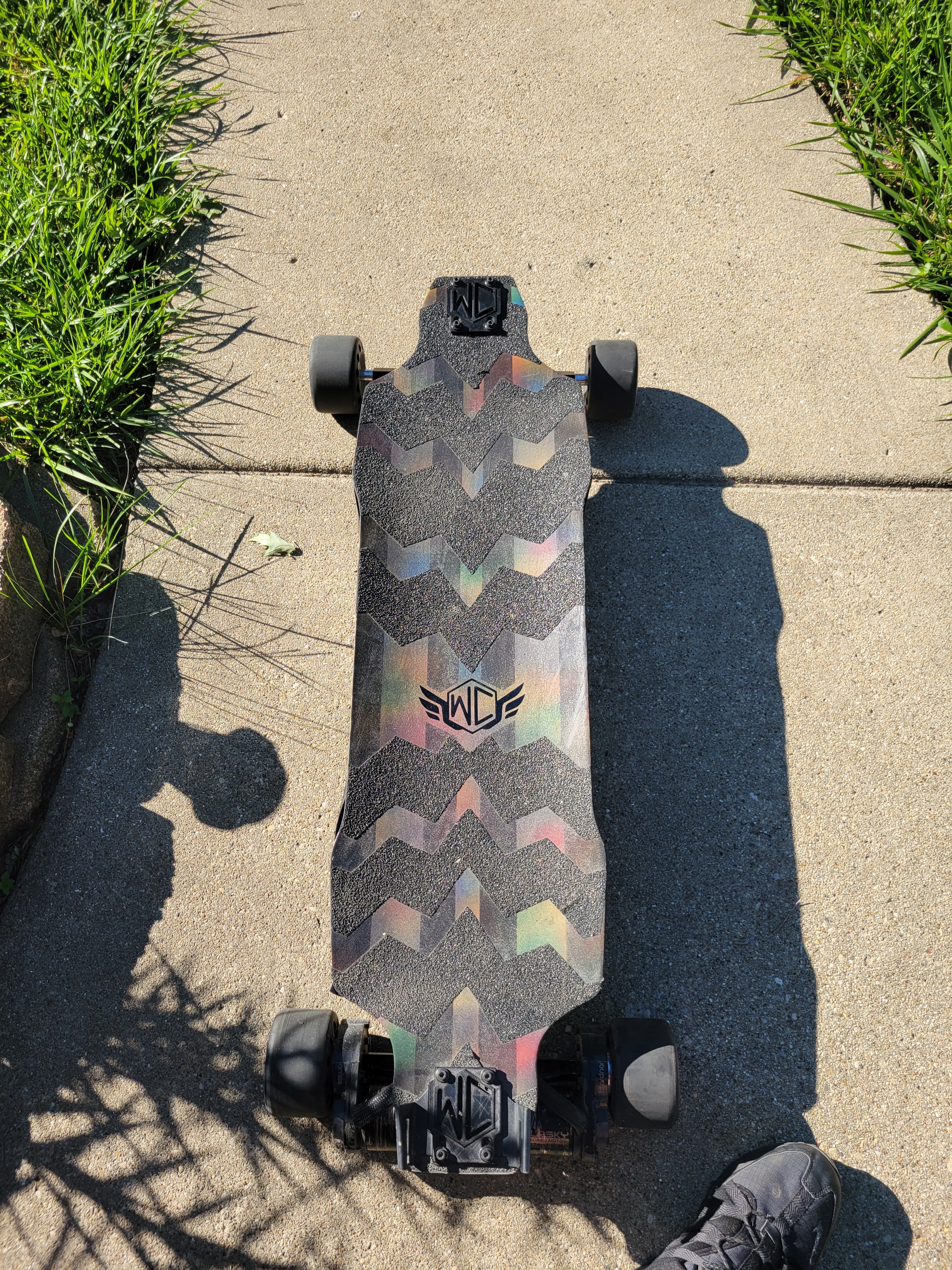

my lil test ride after finally finishing my pack

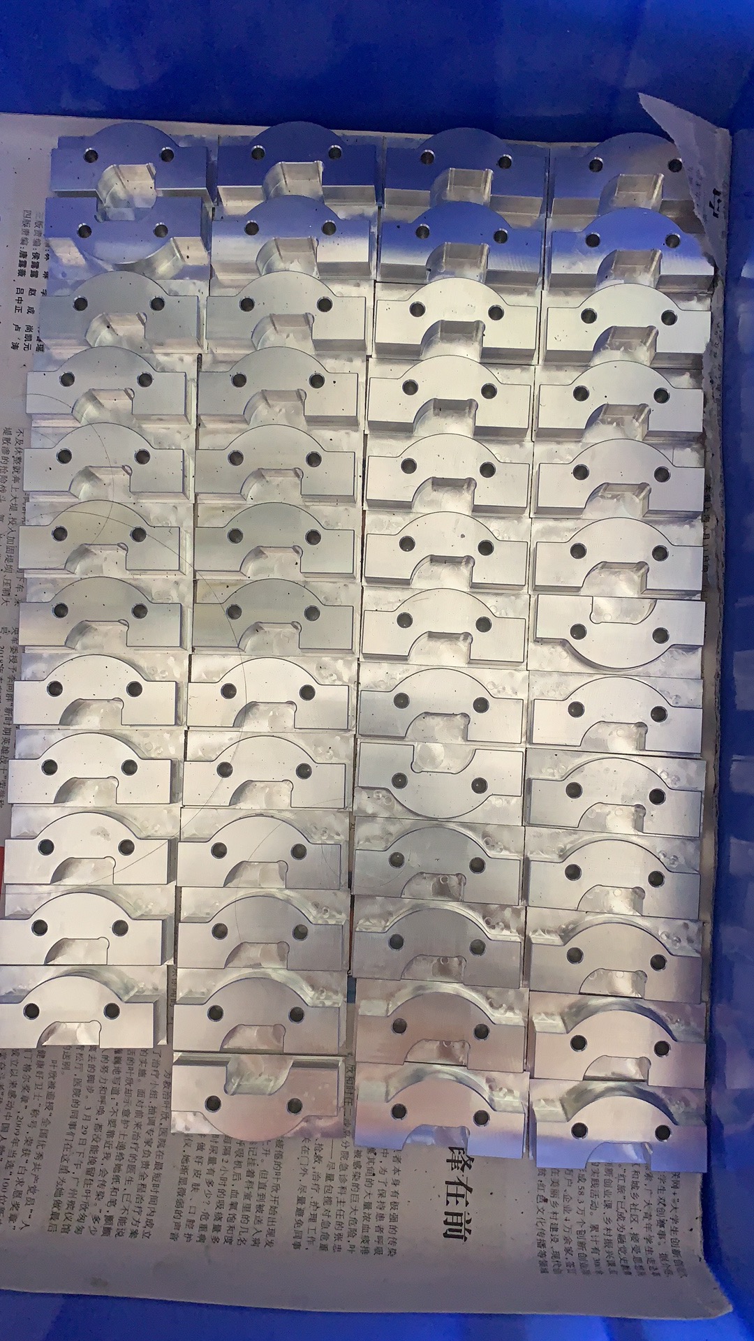

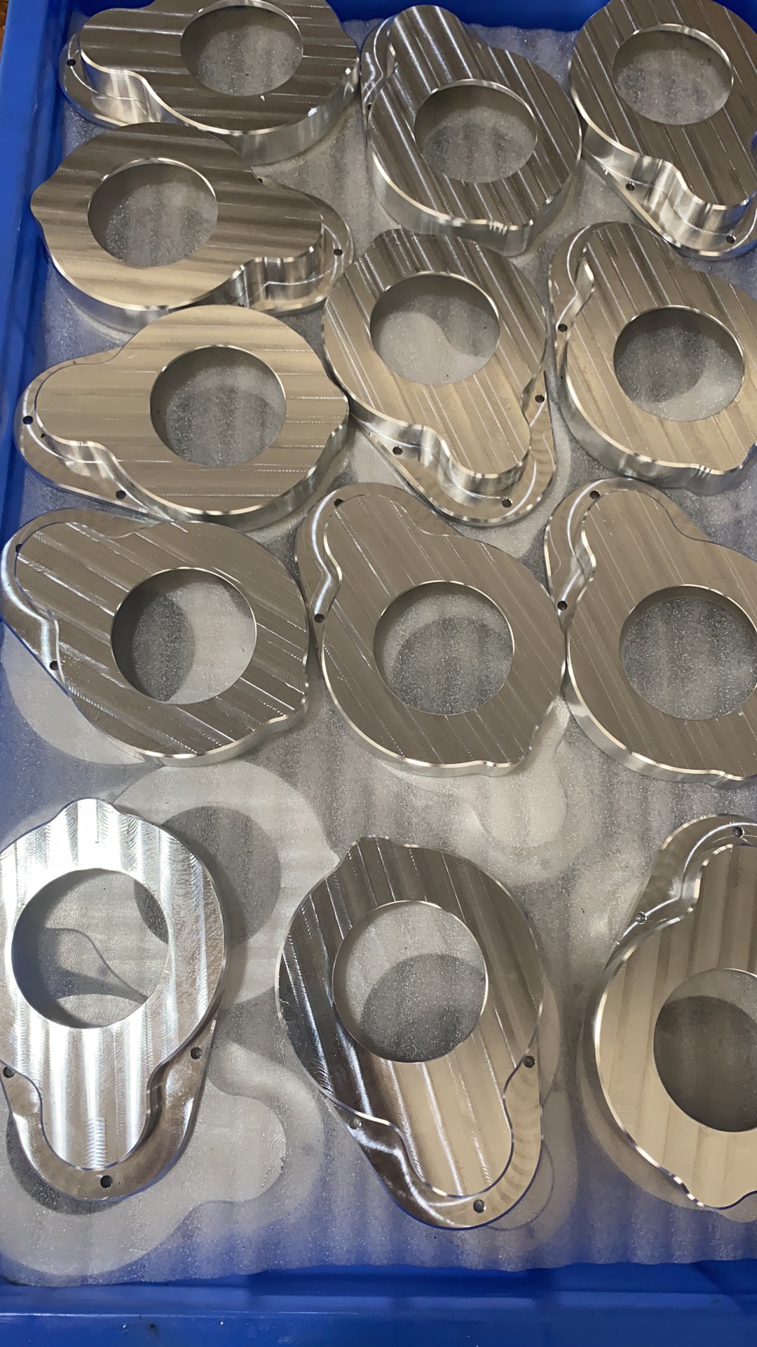

I shipped something like 25 packages today. Finally got my “care package” in. It is already nearly depleted…
More on the way
V2 Adjustable baseplates also coming very soon. :smiley:
