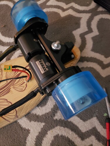

Anyone mounted 6380’s on the M1 with 220 under the board with the new adjustable base plates?
Yep
30 degrees is a comfortable fit with good road and board clearance. I bumped it down from the next higher angle because truck clearance was close and road clearance wasn’t as good.

So I’m running 50 in the back and with my angled tail that makes it 40. I wonder if that will work, can you post a pic when you have a chance of wheels on the ground to see those angles?
