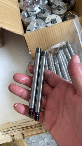

Yup they were, and they will be the new standard axle for the 270mm hangers.
On the 270s, they stick out 61mm. They have a hex drive for easy installation. Uses a 7/16" kingpin nut (included)

You mean future 270s will have a full 10mm axle instead of stepped to 8mm?
That’s right

Any reason why? Strength? I want the stepped axles so i can use 8mm axle bearings haha
Why though? Just use 61900 bearings, easier than finding 8x28mm bearings lol
I wanna use urethane wheels and bergs on them :dizzy_face:
61900 is 10x22 though, that should work with bergs right?
It should work yea, but i have many sets of standard skateboard sized bearings, and no 10mm ones. If there are still any stepped axles left i’ll grab them, don’t wanna deal with 10mm bearings :laughing:
