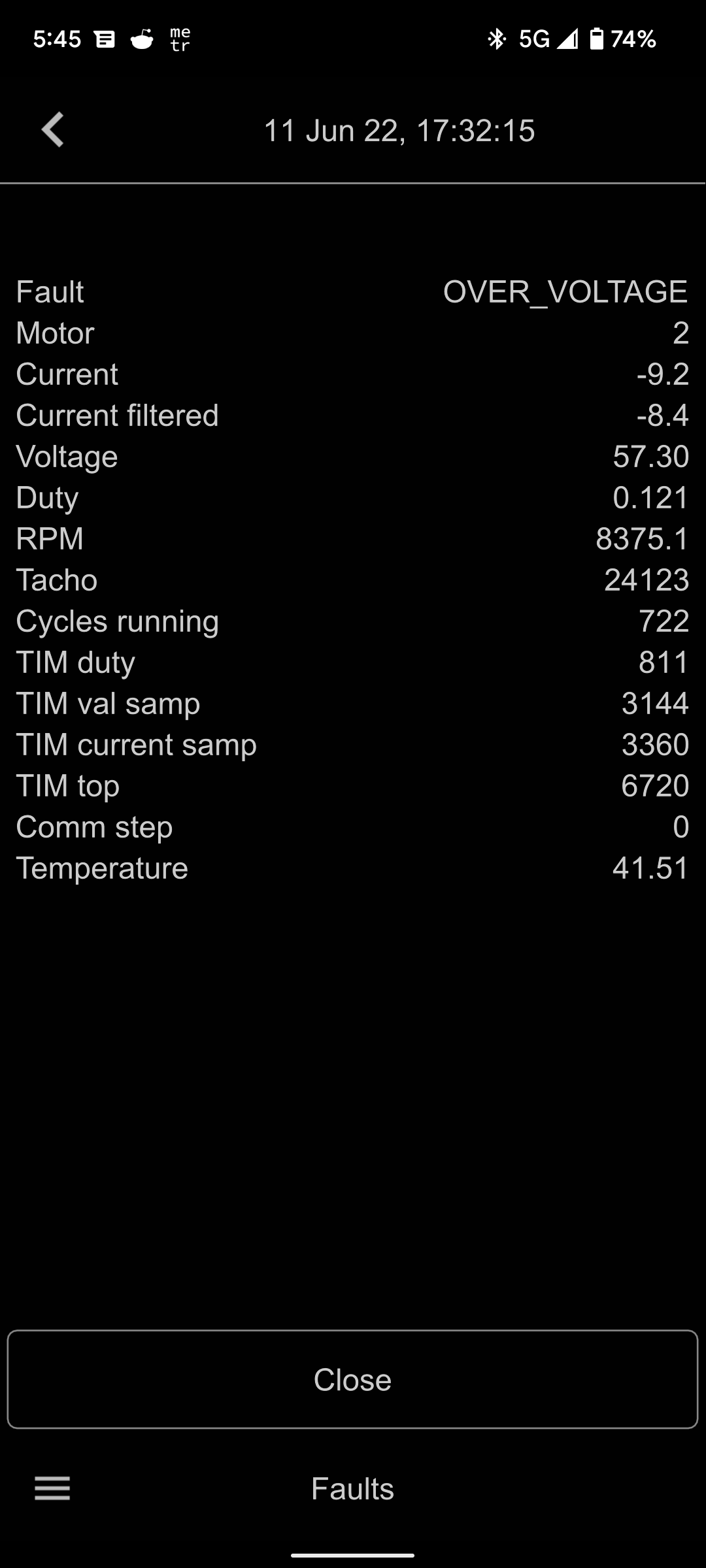

Hey everyone, it’s been a long time without much posting. I’m still rocking the board as described. I haven’t done anything to it besides maintenance. I wanted to reach out to anyone who might have an idea of what’s going on in my build currently. I’ve noticed a few things that may help explain what’s going on.
The issue is that my board is losing power and sometimes braking capability.
  1. METR reports an overvoltage fault when the incident occurs (keep in mind the battery is 42V max charge).
  2. The board would sometimes lose power over bumpy terrain and then power would return.
  3. If I tighten the battery enclosure down, the reported voltage would drop down to near 0. Motors would barely turn if I engage throttle.
My initial thought is that some wiring may have become exposed after all these years and something is shorting. I’d appreciate any feedback or ideas. Hopefully, I’ll be able to diagnose the issue and fix it once I have access to my tools again.
Maybe some xt plugs are broken or a plug came lose and you havent noticed it. Sometimes if hub motors or dd are hit hard bumbs they seem to cut off for a second. Have had this phenomenon one time, but dont know if them motors did the short cut off or maybe something different happened inside the board.
I would check all plugs first. Maybe the battery is damaged bc of a lose connection.
