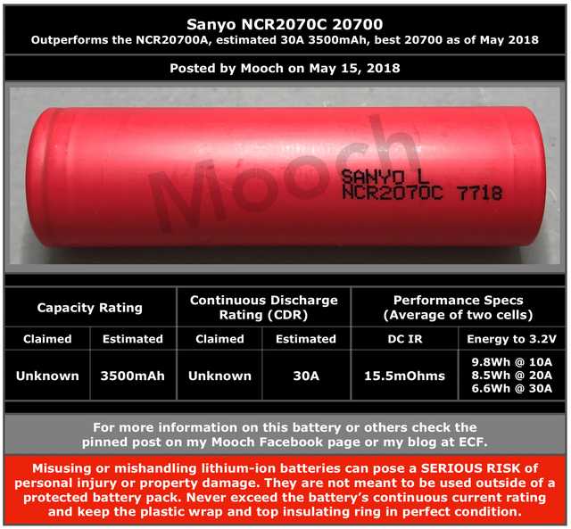

If you have ‘fuck it’ money, I think upgrading to the 12s enclosure, along with a 10s4p (12s3p if you really want that voltage :man_shrugging:t2:) of Santo 2070C cells would be the bees knees.
Increased capacity compared to 30q, even comparing the 12s3p setup to your current 10s4p (but only by like 30ish watt hours)
Higher amp output
Better sag performance (?) - I assume that you’re not running these cells at their max amp ratings, and with how highly mooch praised these cells I figure they would have equal or better levels of sag.
Unfortunately moochs thread on the vape forums seems to have poofed, and this was all I could find:
seems like noticeably less capacity at high draw
Well yeah, most cells do when they hit the 30a range

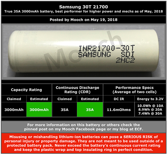

Here’s the 30t for comparison :man_shrugging:t2:

I get that just don’t think they are good value, 30t has considerably less drop in capacity at 10-30A
it’s as if the 20700c is a 3000mah cell at anything above 5A
True, just seemed like one of the better high amp 20700 cells :thinking:
I can’t think of anything other 20700s besides Sanyo and they seem to all be very similar in performance
