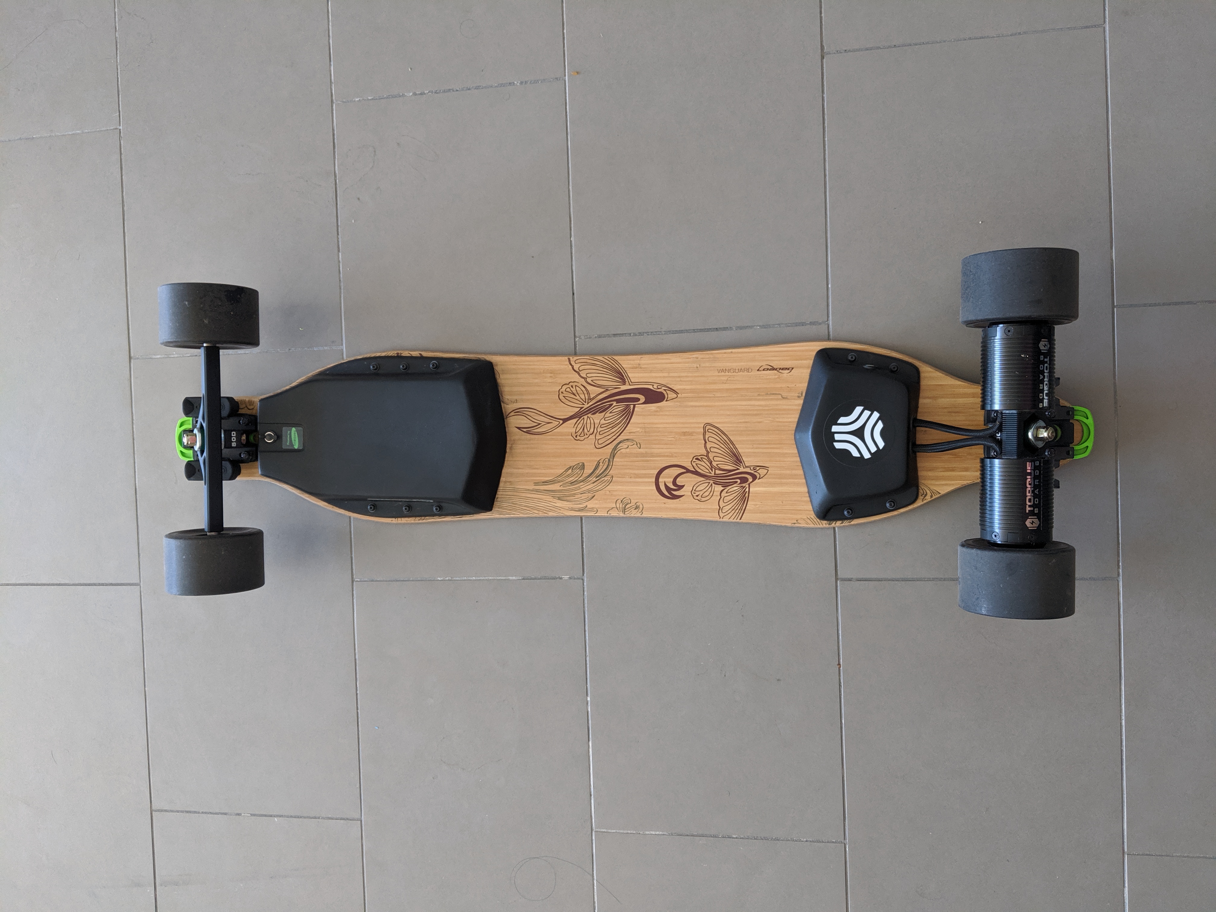

Hello everyone, many of you might be familiar with my build since it was on the other forum. Now that I finally got it working again and bought few upgrades, I figured I’d repost it here! I absolutely love the board. Compared to my v1/1.5/v2 Meepo that this DIY was born out of, it doesn’t come close.
Build:
  • 42" Vanguard Flex 2
  • FOCBOX Unity ESC
  • 10s4p Samsung 30q pack with D140 BMS (bypassed discharge)
  • Torqueboards Direct Drive
  • TB 110’s
  • eBoosted 10s4p enclosure set :heart_eyes:
  • Flipsky VX1 remote
  • Red X braces from ebay
  • Loaded 1.5" hex bolt set
  • V1 and V2 Shredlights
  • Green Flatland3D bash guards
Configuration/Specs:
  • Battery Max/Min = 70amps/-20amps (2520W nominal, 2,940W peak)
  • Motor Max/Min = 70amps/-50amps
  • PPM, Current no reverse with brake
  • Top speed = 30mph
  • Range is estimated at 18-22 miles. Average 21Wh/mile, pack total is 432Wh
  • Acceleration is superb, beats a boosted rev and V2 easily. I need to drag race more people in my group. Pull off the line is strong and continues up to 30mph quickly.
  • The control from the VX1 and Unity is sublime! I love this remote and ESC so much. No longer do I fear being jolted off from a small movement of the thumbwheel.
I am really impressed by the power and quality of these direct drive motors and the smoothness of the Unity. The build quality on the Flipsky VX1 is a nice upgrade from the mini remote that I used to have. I basically set out to “build a better Boosted” and I feel like I have done just that!
PICS
Thanks for looking! I am so grateful for this community to have helped me through this years long journey :blush:

Can you share how you sealed the battery enclosure? What combo of foam / rubber / sealant?
ESC enclosure as well, if you don’t mind typing it out 🤷
I just have trouble imagining how I can deal off the thin top and bottom.
I’ll be out for a bit so if you need a picture lmk and I can take one tomorrow.
It’s self adhesive neoprene spanning the enclosure footprint and a thin strip along the interior of the enclosure. The thin strip sits a few mm below the actual lip of the enclosure so it has room to close (not by design, just happened to get pushed down when I tightened it all up). All the neoprene is about 3mm in thickness. I use nylon washers between the hex bolts and enclosure as a spacer and to prevent them from digging in to the fiberglass so I can tighten it down sufficiently.
I don’t trust that it’s much water resistance but it gives me peace of mind for shock protection, dust, and mild splashes. I would not take my board out in wet conditions.

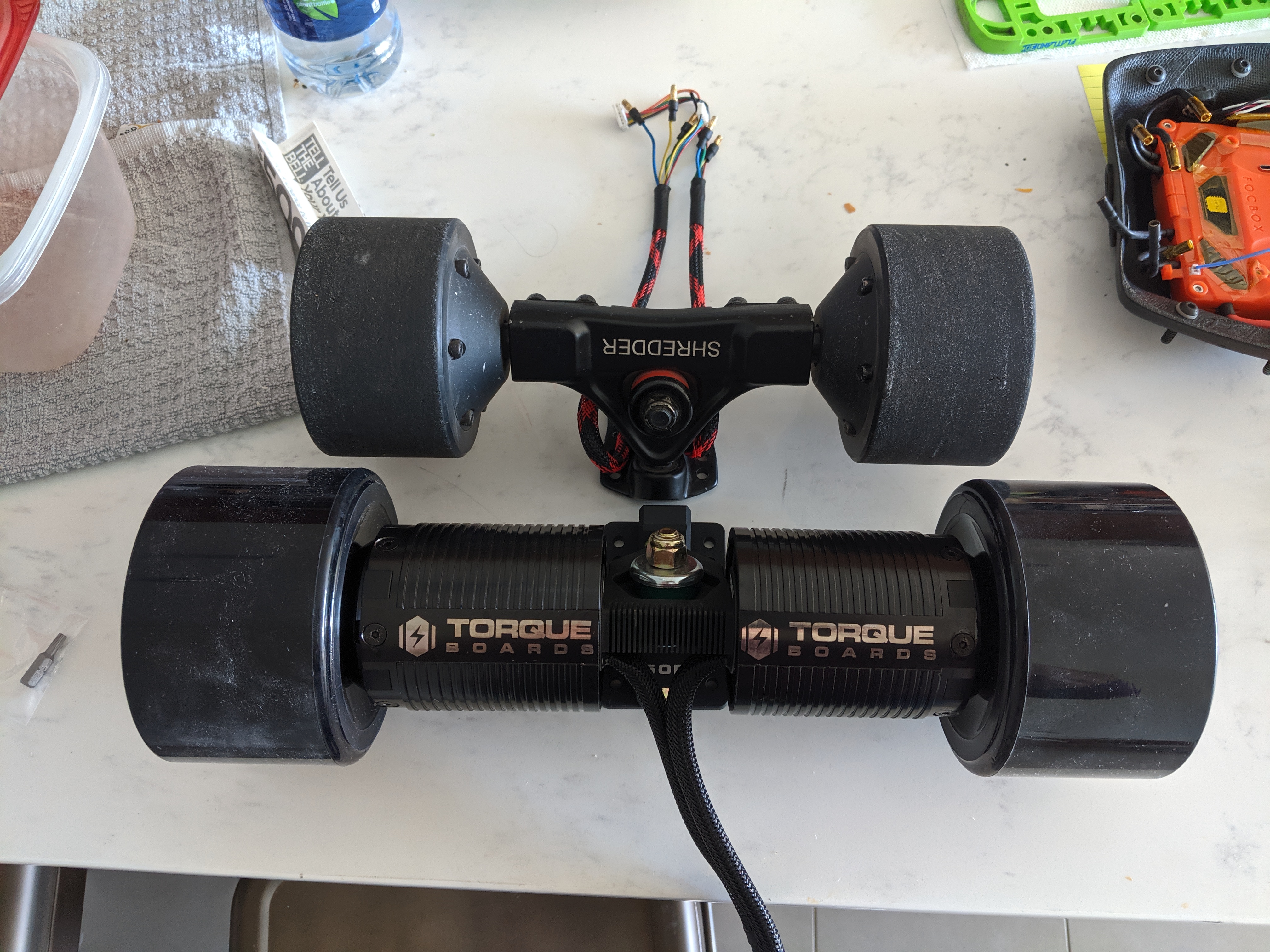

Alright ladies and gentlemen, we have ascended to full DIY status with the latest addition of the TorqueBoards Direct Drive system. I ordered on a Tuesday, shipped Saturday, received Monday! I’ve put around 30 miles on them so far.
First impression is that these things are massive both in size and weight. More copper/iron is better for performance so I’m not complaining. Secondly, wow these TB 110 wheels are the shit. I didn’t think a good road could literally feel like a cloud or snow slope. Thirdly, the power is great. I am running 70/-50/60/-20 settings with amazing torque and hill climbing ability. Fourthly, the stability is great; I have little fear of carving compared to the hub motors that would bounce around and lose grip. Lastly, the sound at high speed at 20kHz is pretty sweet too.
Setup was a little complicated but nothing I couldn’t manage. First thing I did to these motors was chop the connectors and switch them to 3.5mm bullets (for the Unity) and proper 2.0 JST PH sensor connectors. I then needed to file down the Flatland 3d bash-guards so the TB baseplates would sit flush. After affixing them to the deck and ESC I was getting low speed stuttering in sensored FOC. At first I was worried that I had messed up the sensor connector swap but after changing the “Sensored to sensorless transition RPM” from 3000 to 10000rpm, the issue is completely gone.
The motors have a little rattle to them but this is normal and potentially remedied with some thermal paste along the axel (with the added benefit of faster cool off times). Overall these things are ridiculously futuristic and awesome.
Pictures and settings updated in original post.
