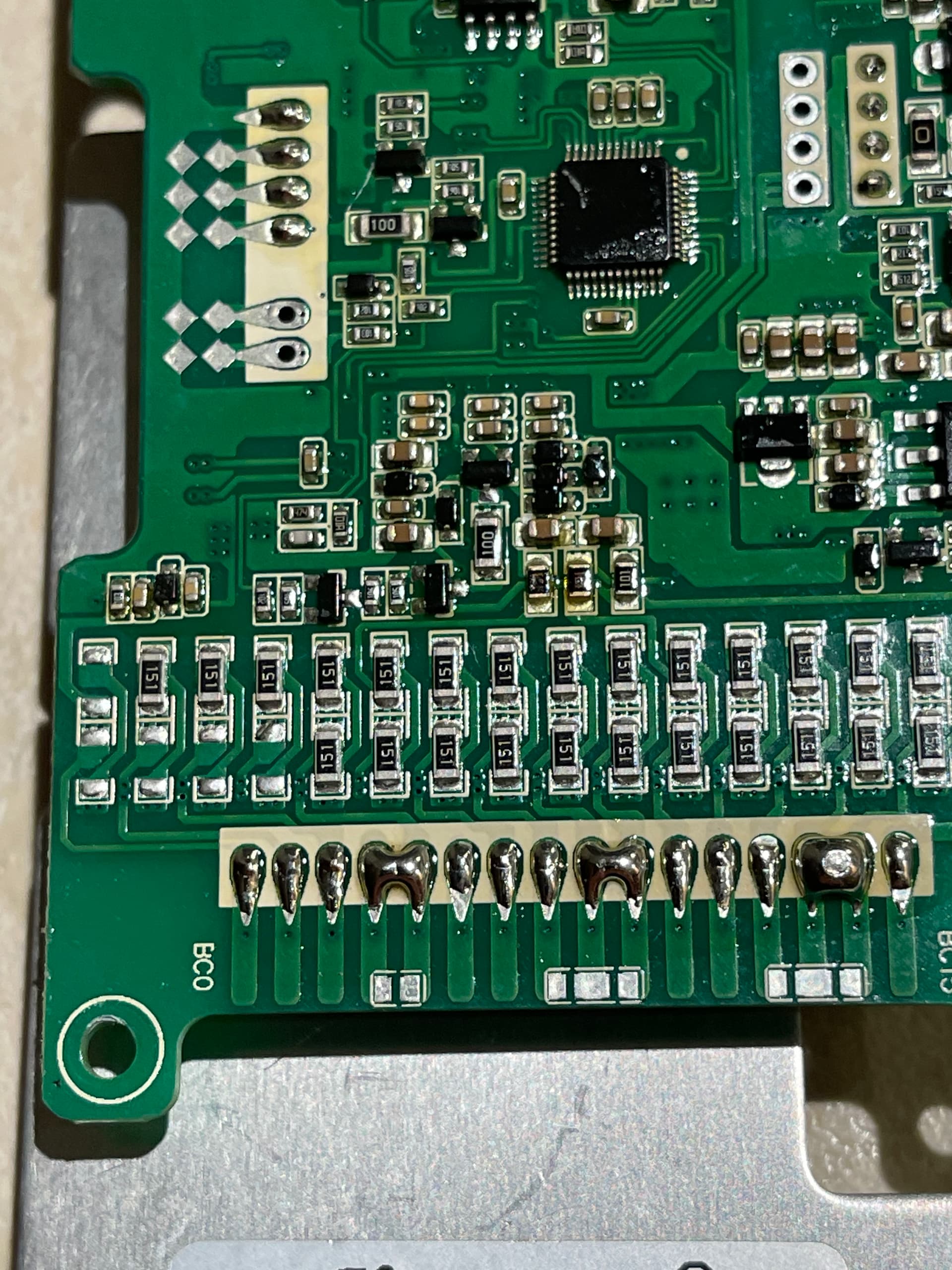

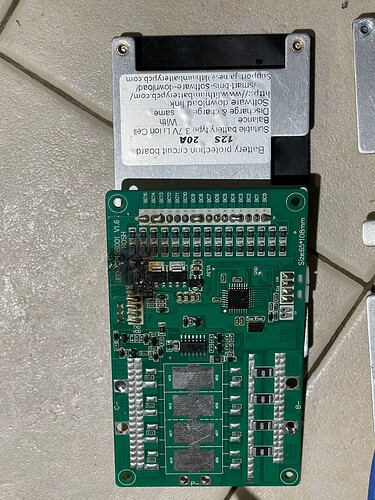

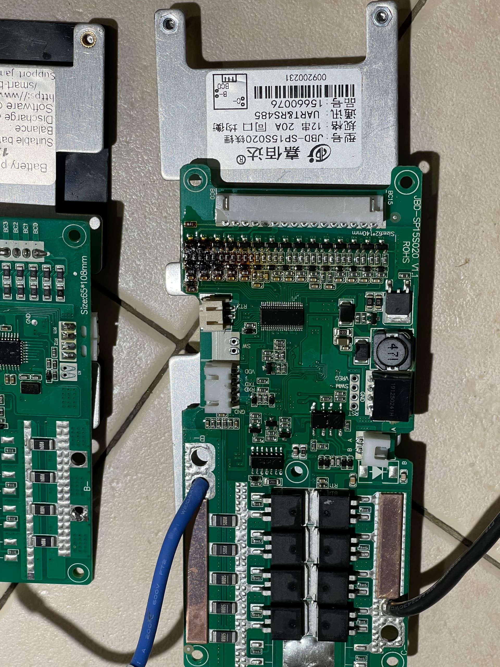

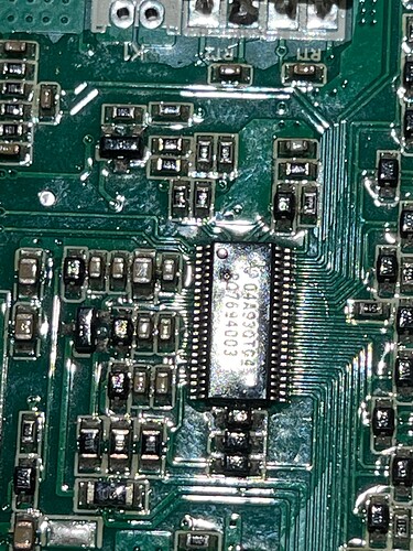

I have the impression that smart BMS are more prone to melting off balance resistors.

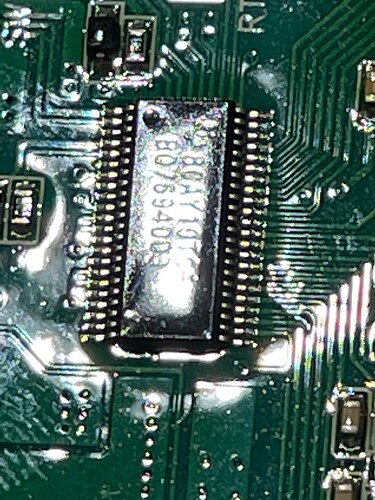

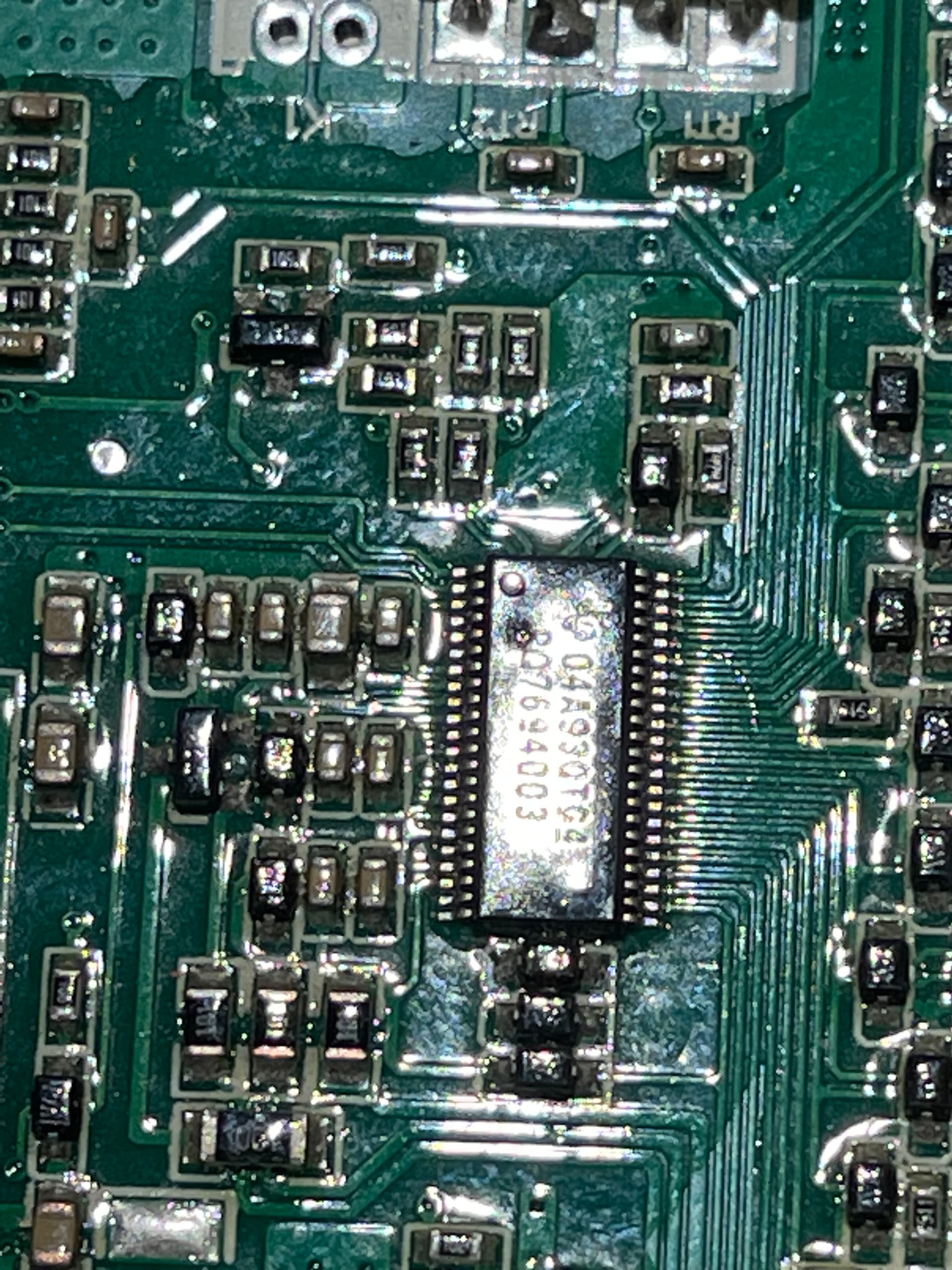

One of them has a hole on the IC cap that is reminiscent of how VESC DRV send their spirit into the afterlife.
Is this a coincidence, due to bad user defined settings, or shared design flaw?
Both had temp probes on in the BMS and the pack terminal positive P group.
I have a 3rd… and a 4th, but I don’t want to tear it out just to replace with an Amazon special for 20$
To me that looks like what happens when you short two balance leads, I did that once lol
I have a stack of LLT BMS PCBs that may or may not be FUBAR, I could send them to you for science.
I had insects get into an LLT a couple years ago, they shorted the balance circuits just past the connector and zeroed every other group. It looked burned up like that too.
Thanks for offer. I’m just going to do a bulk order of ds140. I’ve only had issues with those when I did something willfully stupid.
Bugs?! They are conformally coated. I feel like I could lick the balance resistor banks and not taste the rainbow. :man_shrugging:.
I thought the same. My only theories are that the bugs were eating the coating, managed to short the pins as they go up into the back of the connector, or were a complete coincidence and the part just failed while there happened to be bugs in it. But they were all dead and dried out like they had been fried. Customer left his board on the porch or whatever after a ride, came out the next morning and it was dead.

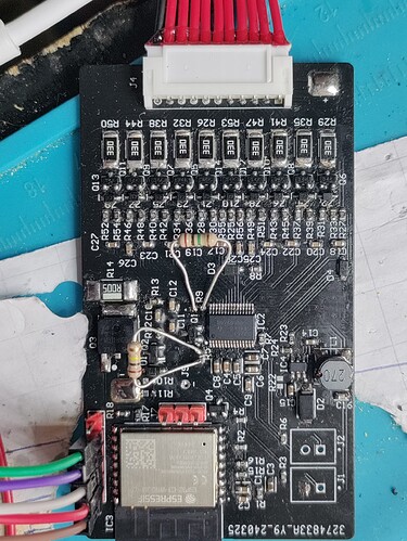

Designed my own “smart” 10s charge only BMS using an ESP32-C3 and BQ76930 IC. I forgot to order a few components so it has some THT resistors for testing. Currently working on porting an Arduino driver to ESP-IDF. Planning on making an app to configure and monitor the battery via Bluetooth LE. Also first time working in Altium Designer.
Has a max balancing current of 127mA per cell.
